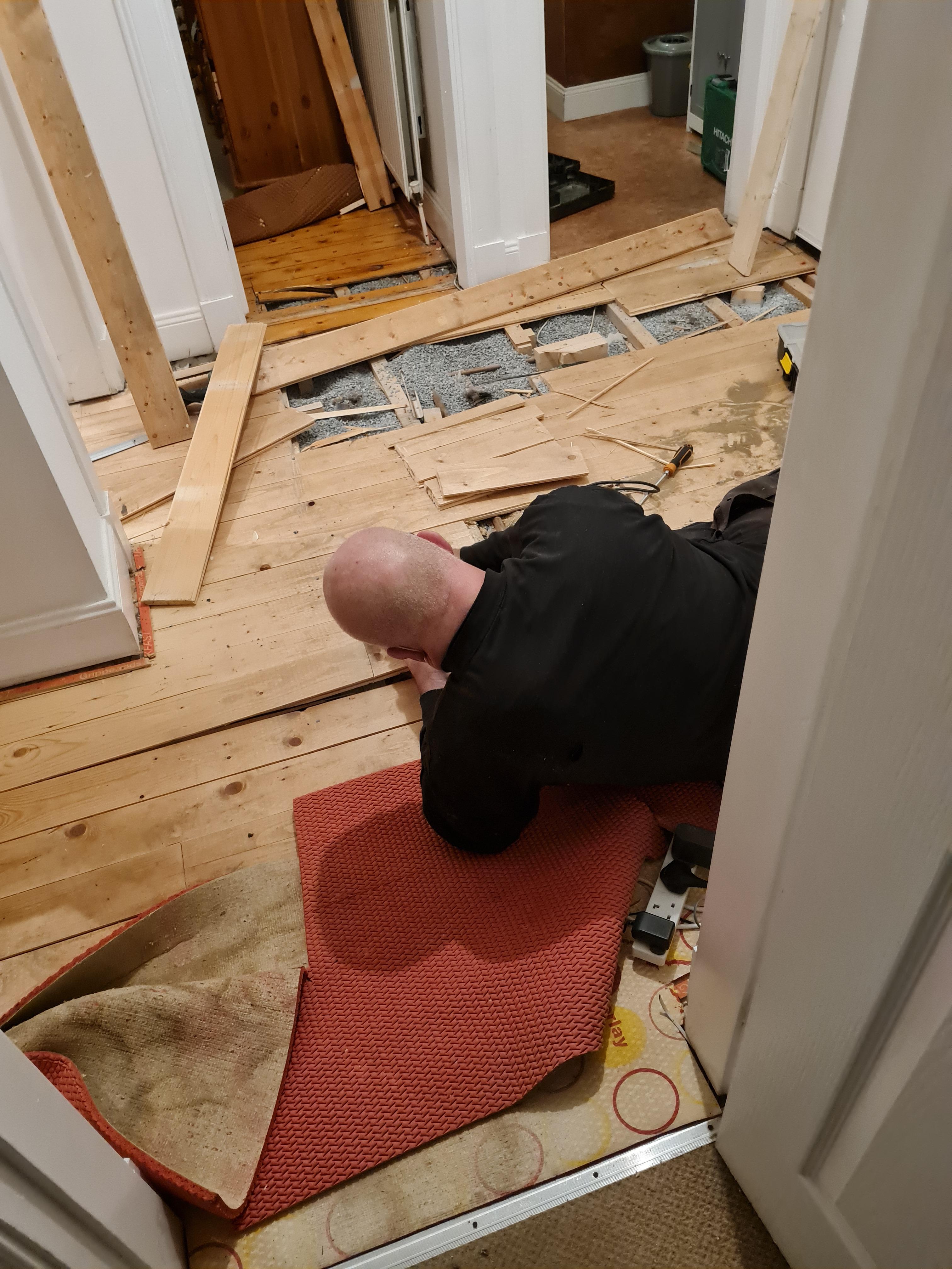

I've agreed to do the labour so have to cut about 5m of floorboards perpendicular to the grain and dig out the deadaning ( thanks @TonyT) for Kevin to do the repiping. First Q Should I leave a board intact every 6 or so for structural integrity...would still leave room to get a 3m legnth of pipe in there or just rip the lot up with a long skill saw cut? -

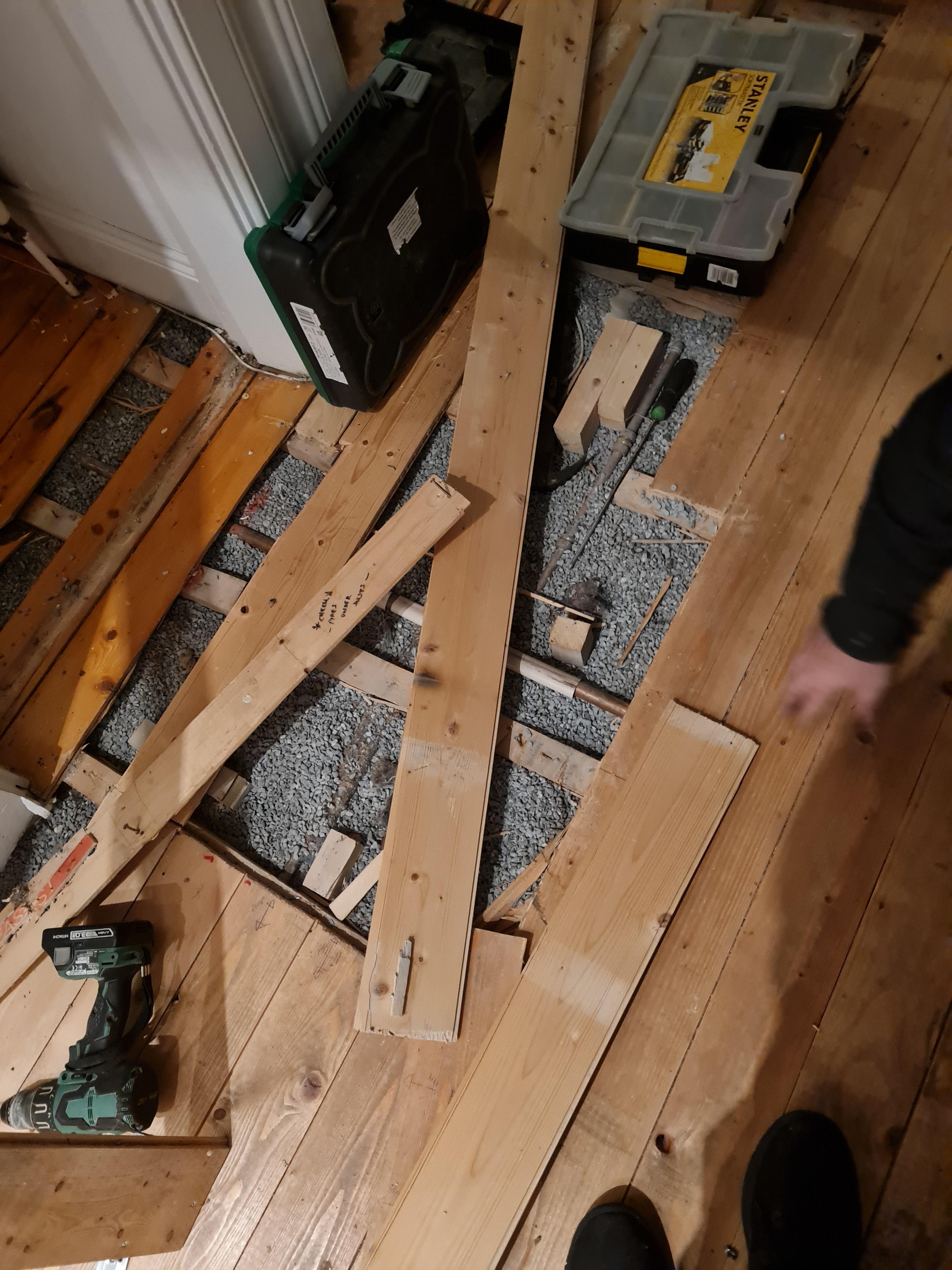

Then I found it, 22 to two 15mm pipes, one to the kitchen for the cooker, one to the boiler...hard to find because the d*ckhead joiner had put a joist (filler) on TOP of the gas pipe with a srtip of foam. Hard to find but after fingertip investigation we did. The whole lot is to be repiped in 22mm. End of story so far -

The joiners came in next and laid suitable filling pieces before covering the whole lot in tons of gravel (WTF, we think for sound deadening) and then new floorboards. Guess what...we found the 22mm pipe coming from the meter and into the hall. Now we know the supply to the boiler is in 15mm but can't find the junction and step down to 15 amongst this shingle. -

So, we have a smell of gas and the BG fella has turned it off as there a 20 Mb drop. (Is Mb= millibar?) This is looking for the run of the gas pipe from the meter to the boiler. Kevin the heating engineer has done a few of these before and explains. Seems a method developed whereby the old floorboards were left in place and all the new plumbing and heating was laid first fix ON TOP of the floorboards. -
