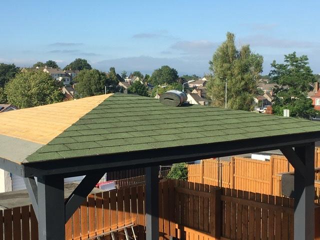

  1. Another weekend so got one side of the roof felt tiles on Should get the gutter on tomorrow but I’m having one downpipe as it’s only 13 sq/m Do I need a run on the gutter or just do it level, sides are 3.5m?

  5. Bon voyage BBQ Sunday so have to get a wiggle on... latest, it’s been pouring proper rain up here stopping progress BTW went for loglap for the roof, painted on the inside face, looks good

  7. Got a half day off so cracked on in the sun. I offered up the jack rafter, wee plate to hold in place and carefully marked and cut it. Once you’re doing it, it’s much easier to visualise than the videos One of my better joins ? Got the end plate on as it’s getting a mini gutter bingo bango...time for a wash and as it’s Friday Hello lovely

  10. Okay, got out of the ground...next the roof.So, not sure of the correct terminology so I’ll make some up? I’m having a floating octagonal king post, fashioned out of a cut off of the big posts. I’m planning to make up the diagonal truss on the ground and offer it up to mark the birds tooth notch. Once that’s done, I’ll do two more and then pop it up in place. I will put in a centre post directly under the king post and screw home to keep everything supported. I also feel fairly confident about the standard rafters (from king post to the centre of the wall plate) but will be asking for help (thanks for the kind pm @Simon offering help) with the angle nightmare that is the jack rafters. Can I ask one thing? I plan to leave the rafter ends long and cut them after the roof frame is complete. Is this correct? Should I cut the diagonal rafters to the correct size (300mm overhang) or also leave them proud?
