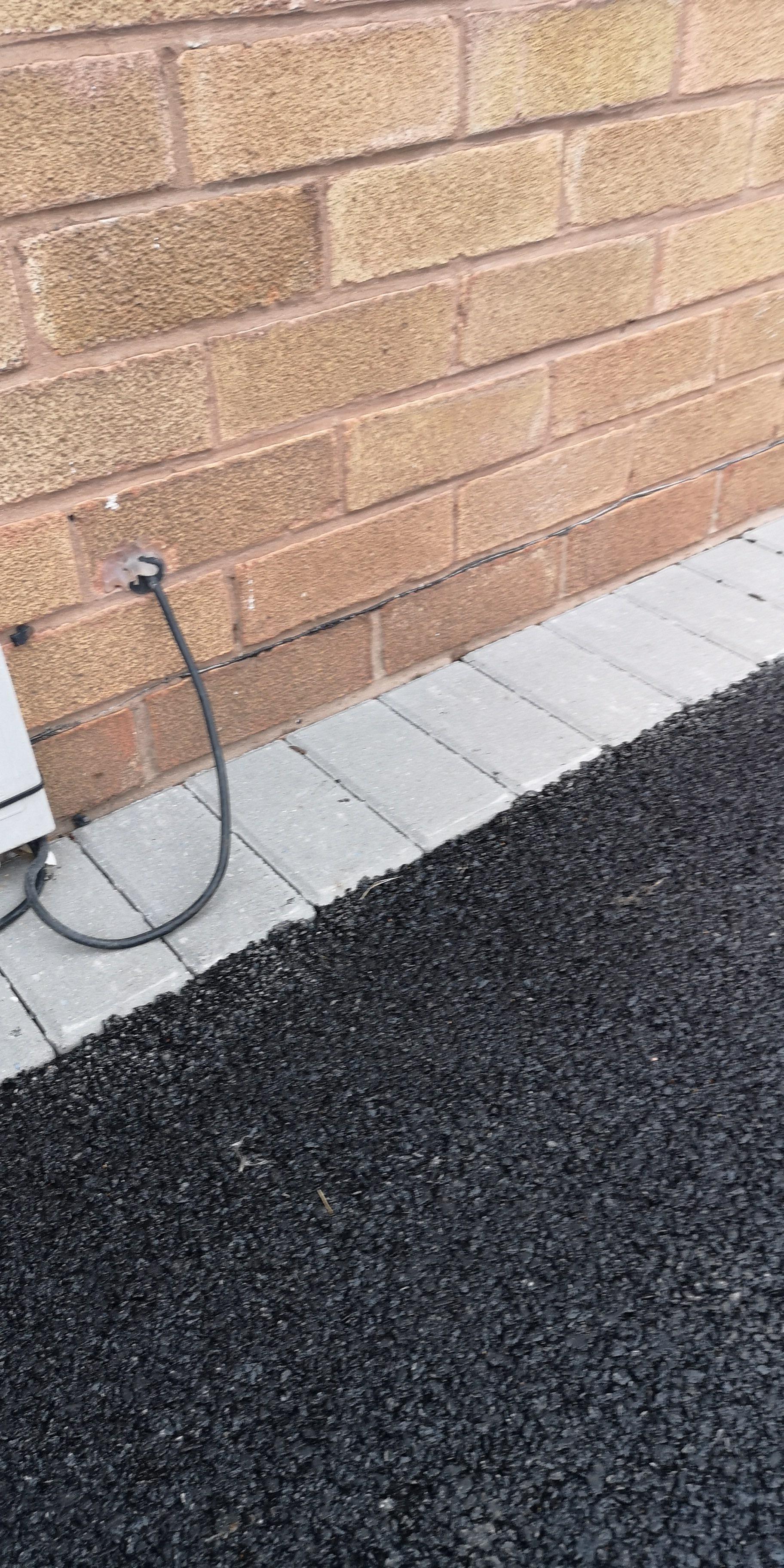

  2. It seems the problems keep on coming. Just had a builder point out that the drive has been done too high and should be 150mm or two bricks below the damp course. Any suggestions on the best course of action now as don't want to proceed with quotes or further work after I have paid them alot of money for the possibility of having to rip the drive back up ?
  3. Trading standards have taken over the communication and they have gone quiet. It wasent a huge amount held back so they think they will disappear just nothing I have ever had to deal with before. I have just had a quote of £500 (2 days work) to remove cement and put in edging stones to support the bricks as they don't want to move bricks in case it damages anything. My Dad seems to think it is excessive as the area is only 7x4. Awaiting on second quote this, afternoon but being a novice not sure if what they are telling me is right.

  5. Thank you for you reply. They dug down with a digger and they did bring hardcore which was rolled by the tarmac company. A young lad was mixing the cement for the edging and while my Dad was here he mentioned to the main man that there was far too much sand and not enough cement but he just got ill sort it but never did. They seem to be on there phones alot being told to hurry up to another job. When he returned he openly admitted that it had not been mixed correctly and would sort it and I told them how I was told it should be done and still didn't finish the job. I complained to the company and got threatened they had done the work and I should just pay up which to be honest shuck me up a bit. My question is what do I do now? Don't want to start landscaping and leveling up the grass if it needs rectifying.
  6. Hoping for help. Single parent fed up of being duped or relying on my Dad. Recently had a driveway completed by what seemed like a reliable company with good reviews. Unfortunately the job started off well and then was a rush finish to get to another job and the end result worries me for how it will stand the test of time. Even more worrying was they then demanded I pay cash less then 24 hours after it was finished and wouldn't even listen to my questions of why it was not completed properly. I didn't pay cash and made sure there was a trail through my bank. My question is advice on how to proceed. They set the edging stones ready for tarmac. When the base layer of tarmac was laid by another company the edging not up against the house started to move and dip. Tarmac company took pictures and said they would have to come back to do top layer at a later date. Contacted the company with video and had a builder friend confirm they had just laid the edging on a bed of sand and it needed cementing to be able to with stand vehicles. Eventually after chasing they came out to fix. Except instead of cementing the edging in and leveling they just piled a load of cement to haunch it (if I'm saying it right) which I have now been told by several people is not good practice especially as there is no cement under the bricks and in some places is way too much and is a mess. My question is should I have the cement removed and bricks relayed in the hope we don't break any of the bricks and be sure it is done properly. Cut the cement back and continue with landscaping and keep my fingers crossed it lasts. Or any other suggestions. Any help appreciated. received_223539519011893.mp4 VID_20200820_091139.mp4
