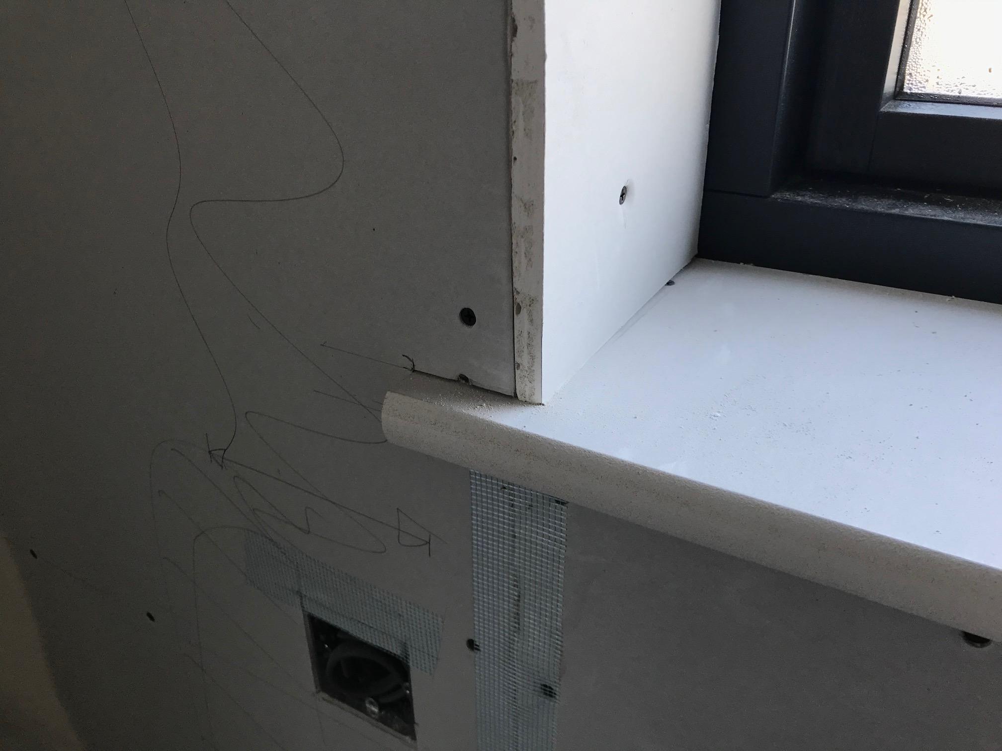

Well I am not alone with window issues, the suppliers and fitters produced really good drawings which the fitters just ignored and some cills will not fit under the window cill drip edge. Some damage on installation with one frame having crow bars marks. The glass is a major issue. The suppliers initially said thats standard, then said they would replace 2 windows and now in conversation with Kastrup to replace 7. The Internorm slider is fine apart from some tiny frame damage on installation. Its very slow to being resolved so wondering if someone can give me some legal advice how I might pursue the matter. -

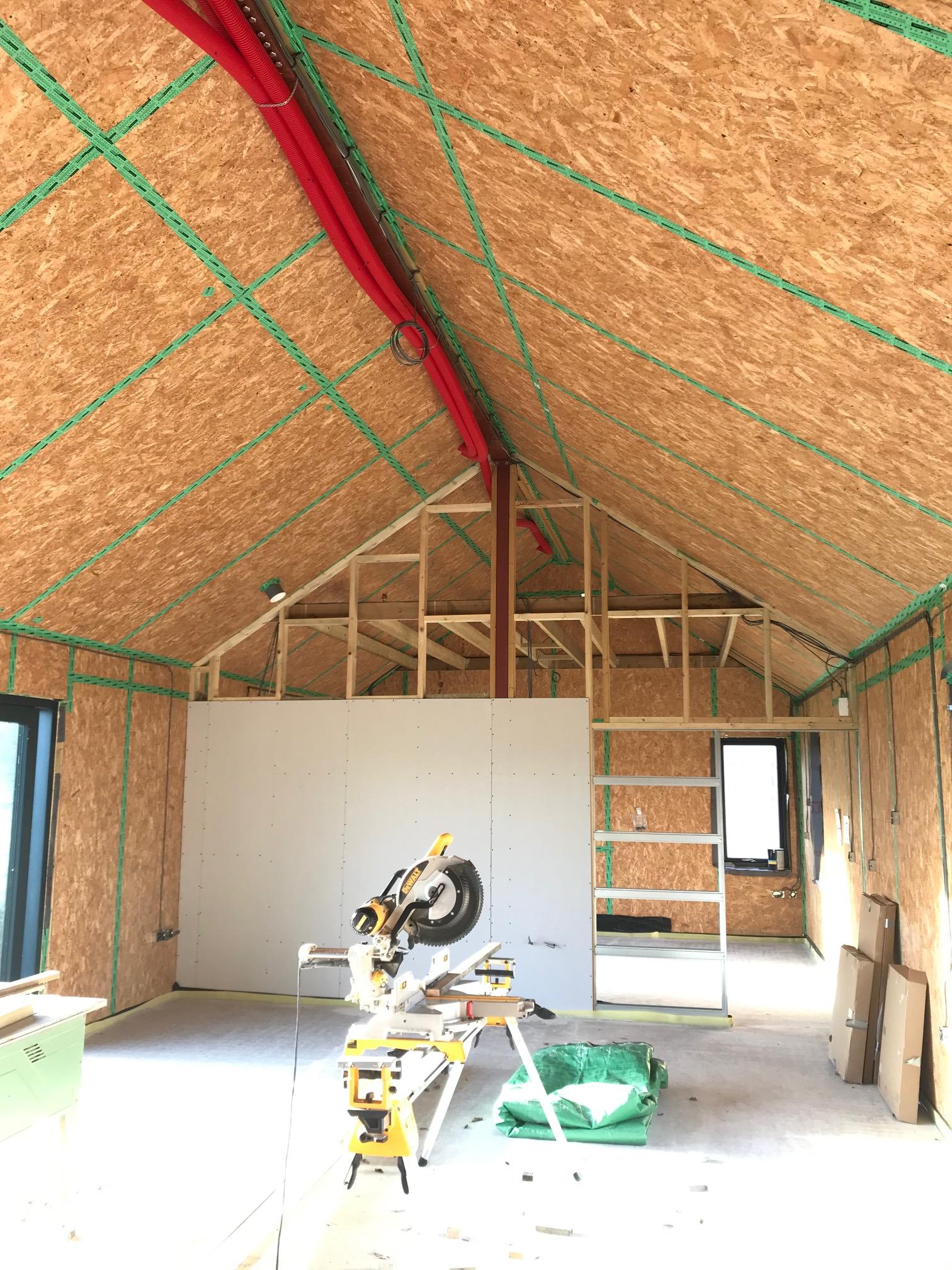

6 month update. Started fitting ducting for the MVHR, my wall build is 3 layers, 140mm, 70mm and 50mm so the ducting fitted well (luck) within the walls. Just need to uncoil the 50m lengths and start dragging it through the build. Then I added the final 50mm timber and insulation before I started the OSB. It took about 2 months to fit about 150 boards, the vapour barrier, double sided tape, airtight tape, it was quite a challenge especially the vaulted ceilings. For the flat roof, fitted the Velux Rooflights then GRP, about 35sqm, 2 layers. Just need to be very organised and keep all tools and materials clean. I might put some Sedum on at a later date. Had some windows and doors delivered and fitted. Kastrup and Internorm. The whole experience disappointing so far. Most of the Kastrup need replacing due to roller marks on glass. Fitting below average. Finally the Tata SSR. Took me ages to set out but once the eaves and verge square it goes on well. 3 roofs to fit. Now half way through the second roof with 7 Velux which fitted well though very heavy, the soft wood frames very prone to damage if not protected. Working out how the EDW flashing kit works around the SSR takes a while, lots of measuring and cutting, creating upstands and folding but the end result is good. About to move the Kwikstage round again. Body struggling though. If anyone wants more detail do ask. Its all quite challenging but still satisfying.
