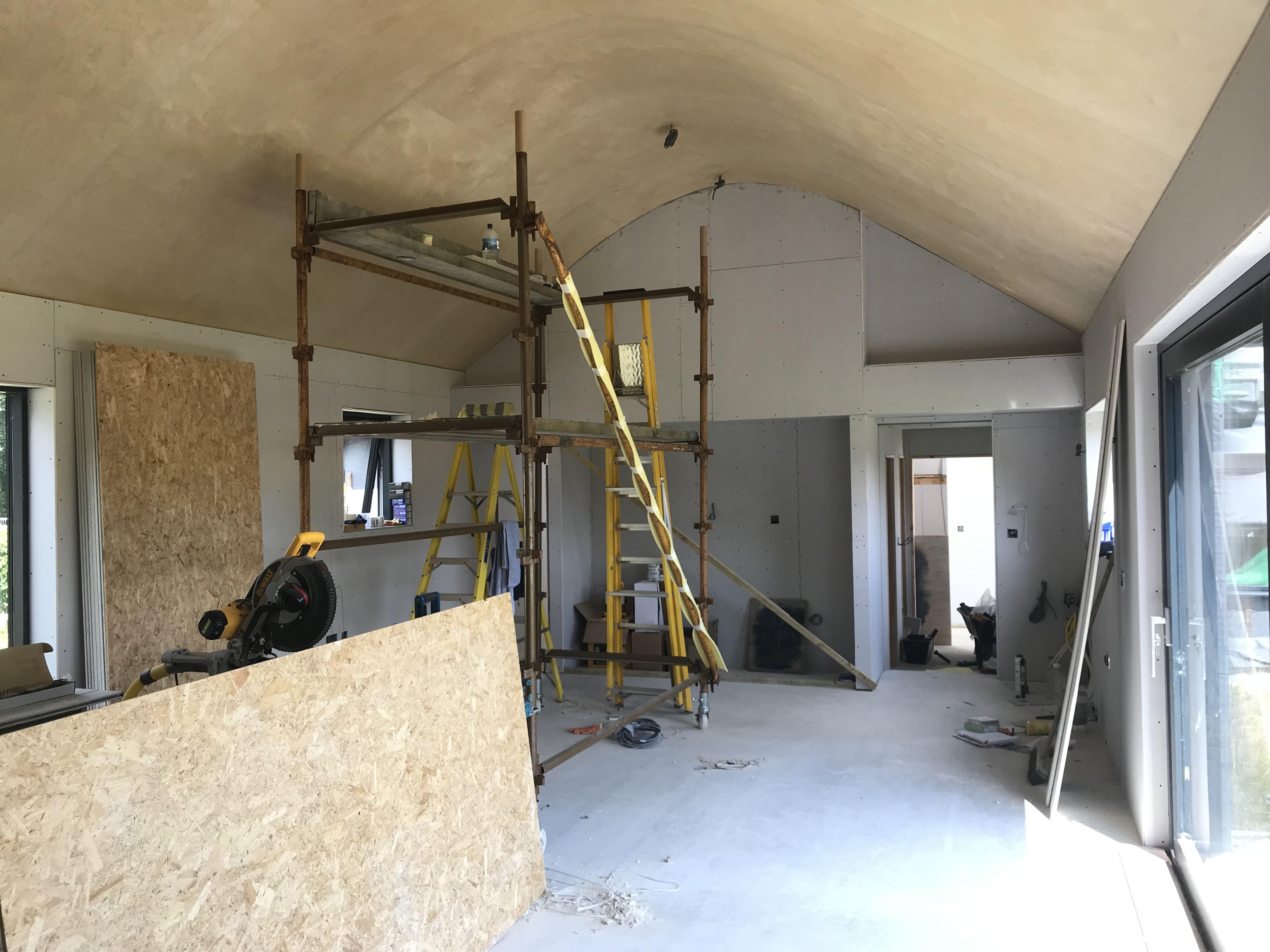

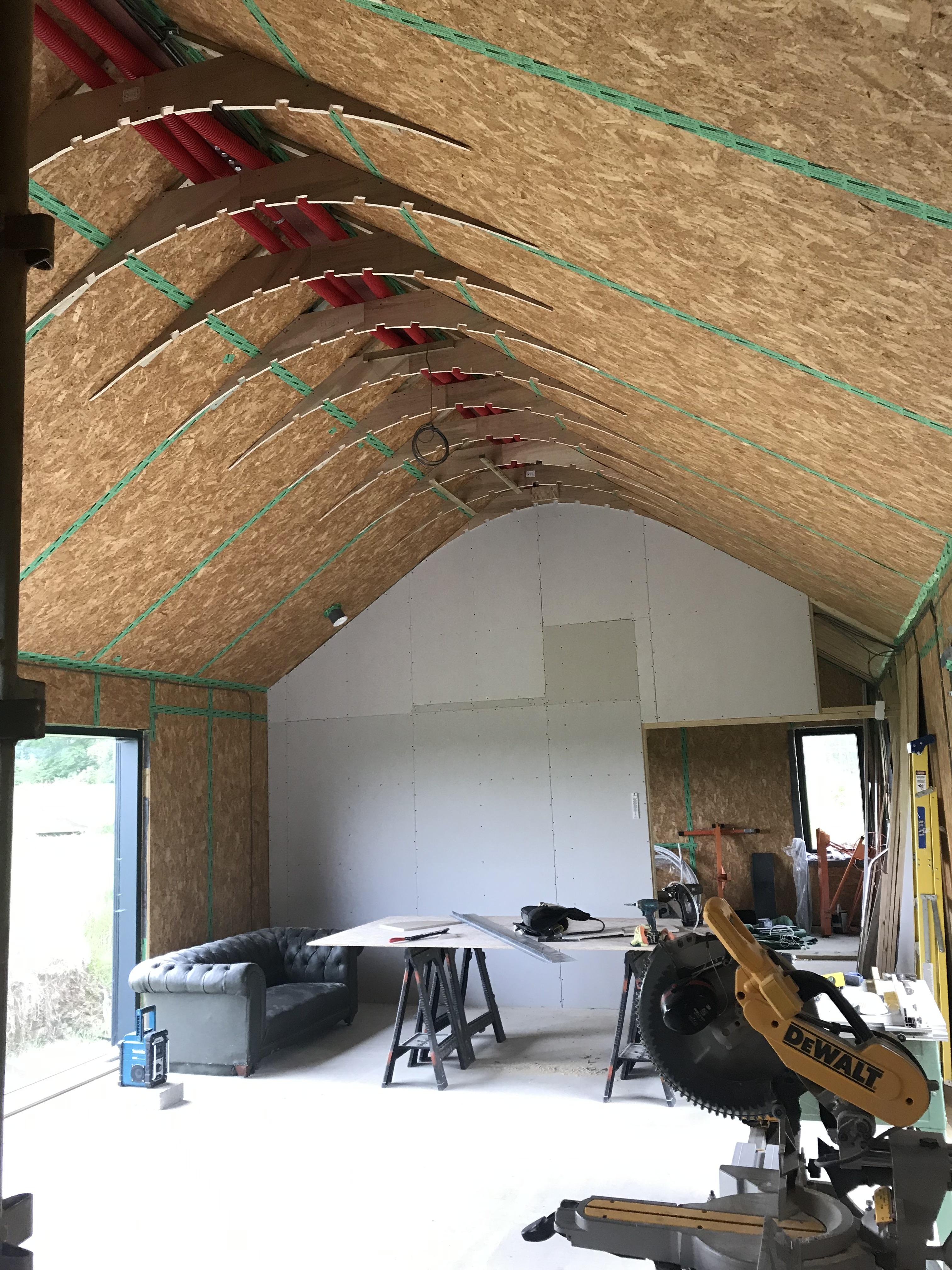

We have a vaulted ceiling and the ducting ran under the steel ridge. In hindsight I could have run the ducting in the warm roof space as I had 70mm timber on top of the rafters. My solution was to make a curved ceiling. -
