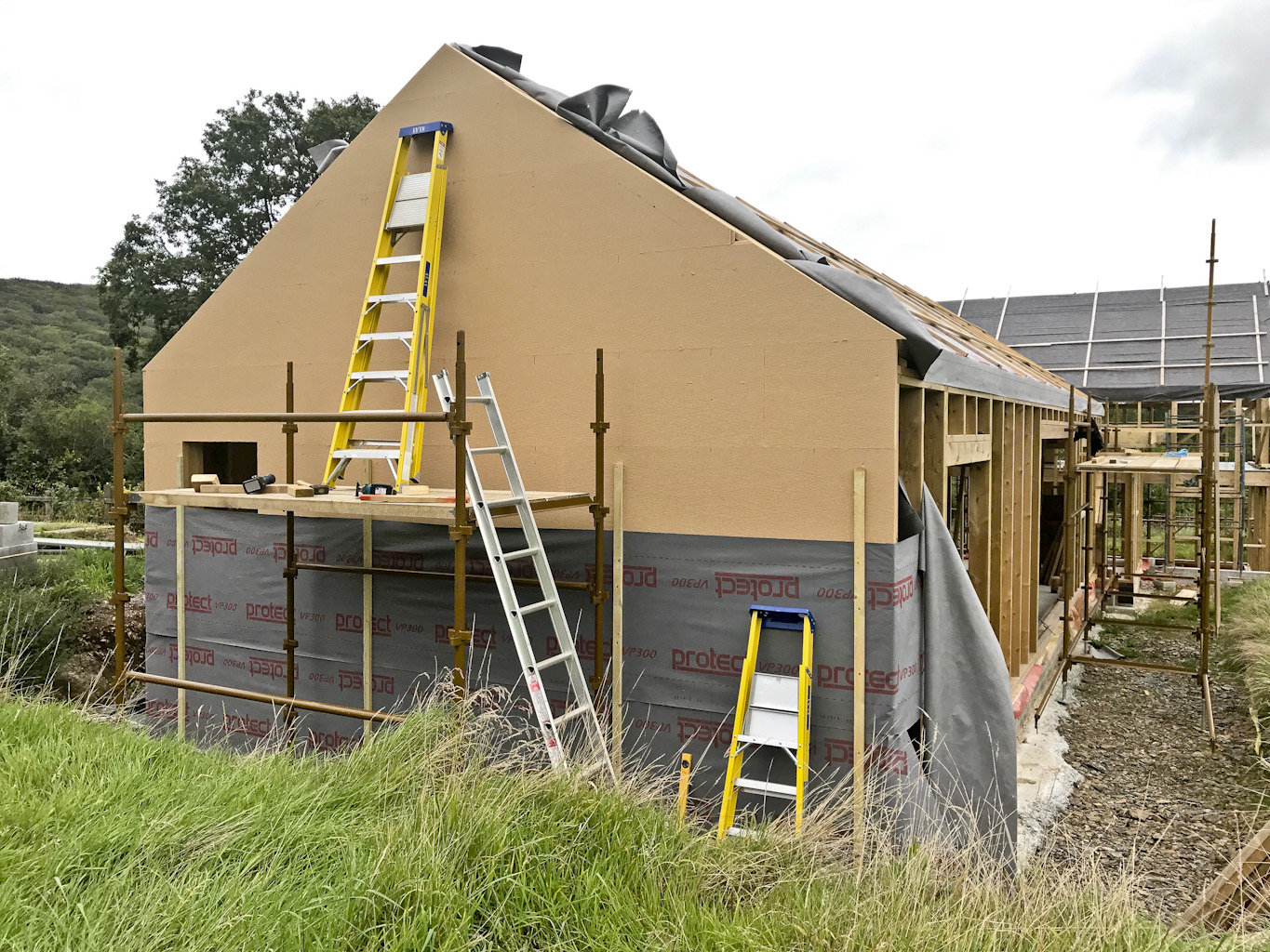

The Rockwool Flexi 140mm slabs are very stable and would stay put. Personally I would use a cheaper option to the Egger board on the outside. Some wall build ups have OSB just on the inside or outside, the breather membrane would seem a bit vulnerable with out it. I used Pavatherm to increase the insulation and have a warm roof. My project below.
On our wall build up I have 11mm OSB on the inside for racking, not sure why you would need the Egger and OSB. My wall build up from outside Larch cladding 25mm batten 25mm vertical batten Breather Membrane 40mm Pavatherm 275mm Timber with Rock wool Flexi Vapour Barrier 11mm OSB 25mm Service void 12mm Plasterboard
I fixed the Pavatherm with some galvanised nails, the vertical battens hold it in place through the Pavatherm into the timber frame. After the insulation is finished I will fit OSB to all walls and roof for racking strength then batten and plasterboard. Lots to do.
