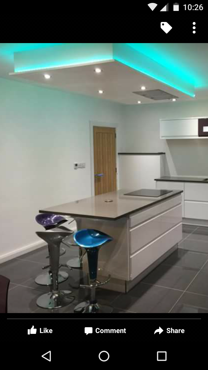

  2. The way my roof was constructed to leave it open at the front meant I had a triple truss in the way of the extract vent above the cooker so I had to put in a false ceiling to give me enough room to get the duct under the truss and out. It is just an 8*4 sheet of 18mm MDF with a frame made up of studding. The frame is screwed twice to each truss that it crosses so there are alot of fixings holding it up. The spark left a plug socket to which I have the power supply for the strip lights plugged into so when I turn the downlights on the strips turn on. This is the only pic I have in my phone.
  3. I have a rgb strip around a ceiling plinth that is over kitchen island. It is wired into six downlights that are also on the plinth. I have two light switches for the kitchen, one for the main lights and one for the lights on the plinth and the lights in the kitchen cabinets. No reason you couldn't do similar and have one switch to turn them on/off or two switches so you can have split the strips up and pair them with whatever other lights you intend to have. The rgb lights have a remote sitting in the cupboard and like you I planned to change the colour every week but it's been on blue for over a year now!!!
