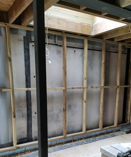

Yes you can have it in the cavity but it will be a cold bridge. Best to have a bit of insulation around it. You will paint the bottom metre or so with bitumen paint. No issue with DPC. If you have a cavity tray running around the wall you will need to stop it either side of the steel.

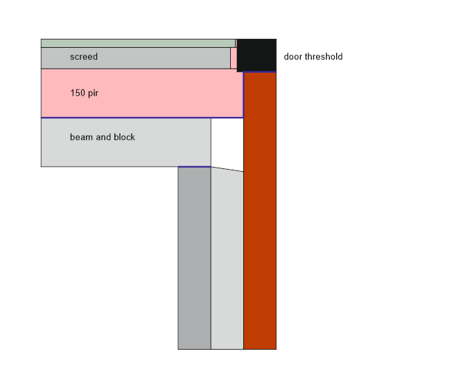

Sliding Door Threshold Details with Beam and Block Floor
Mr Punter replied to Ay8452's topic in General Construction Issues
The doors will sit on and be supported by the outer leaf, just overhanging by 20mm. -
