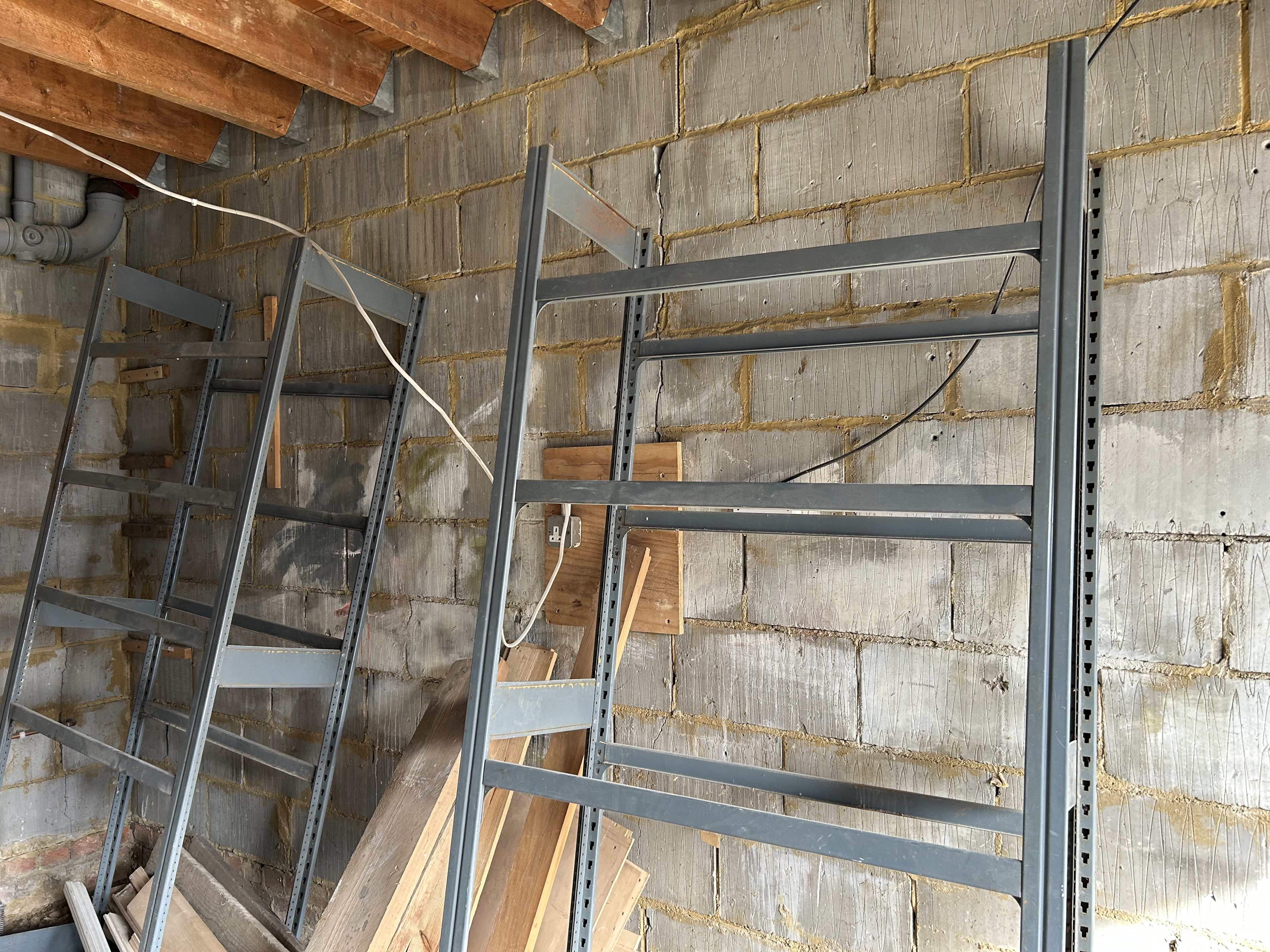

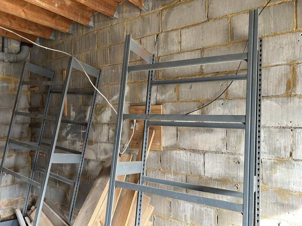

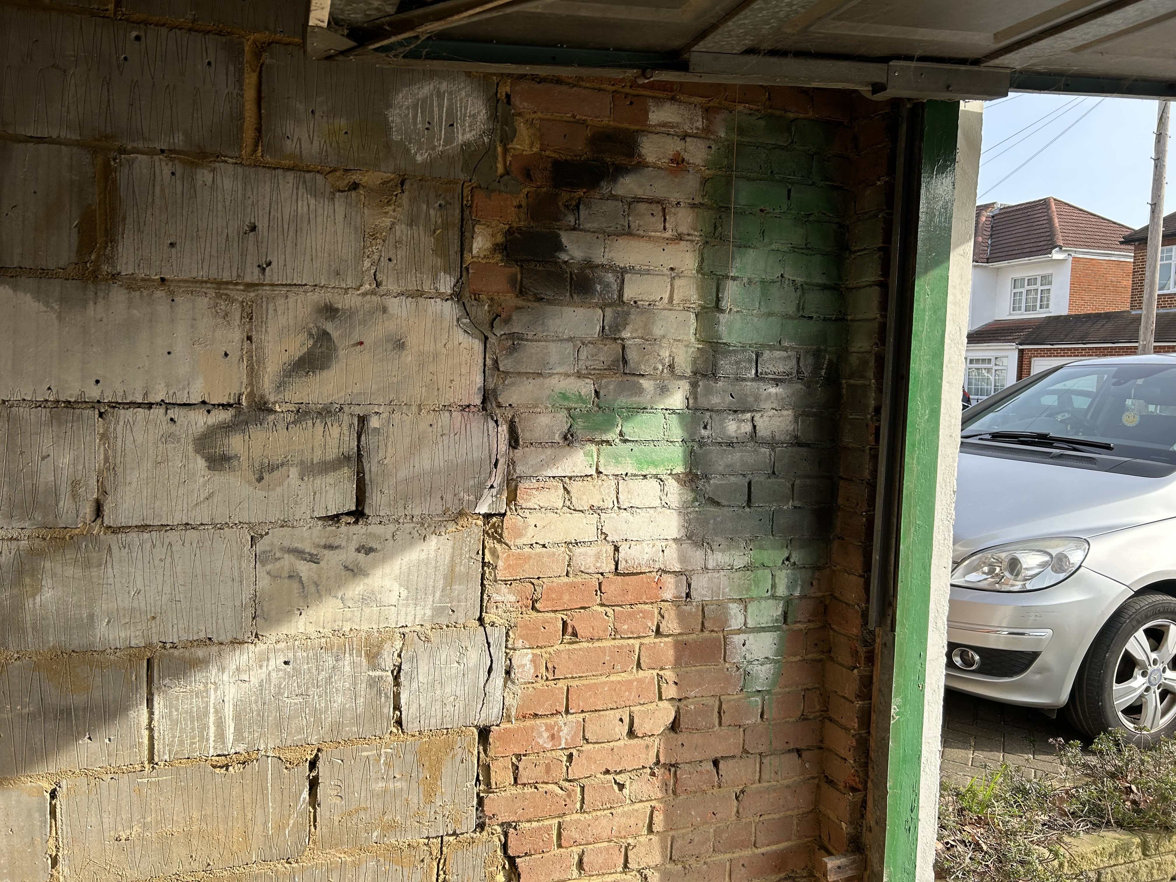

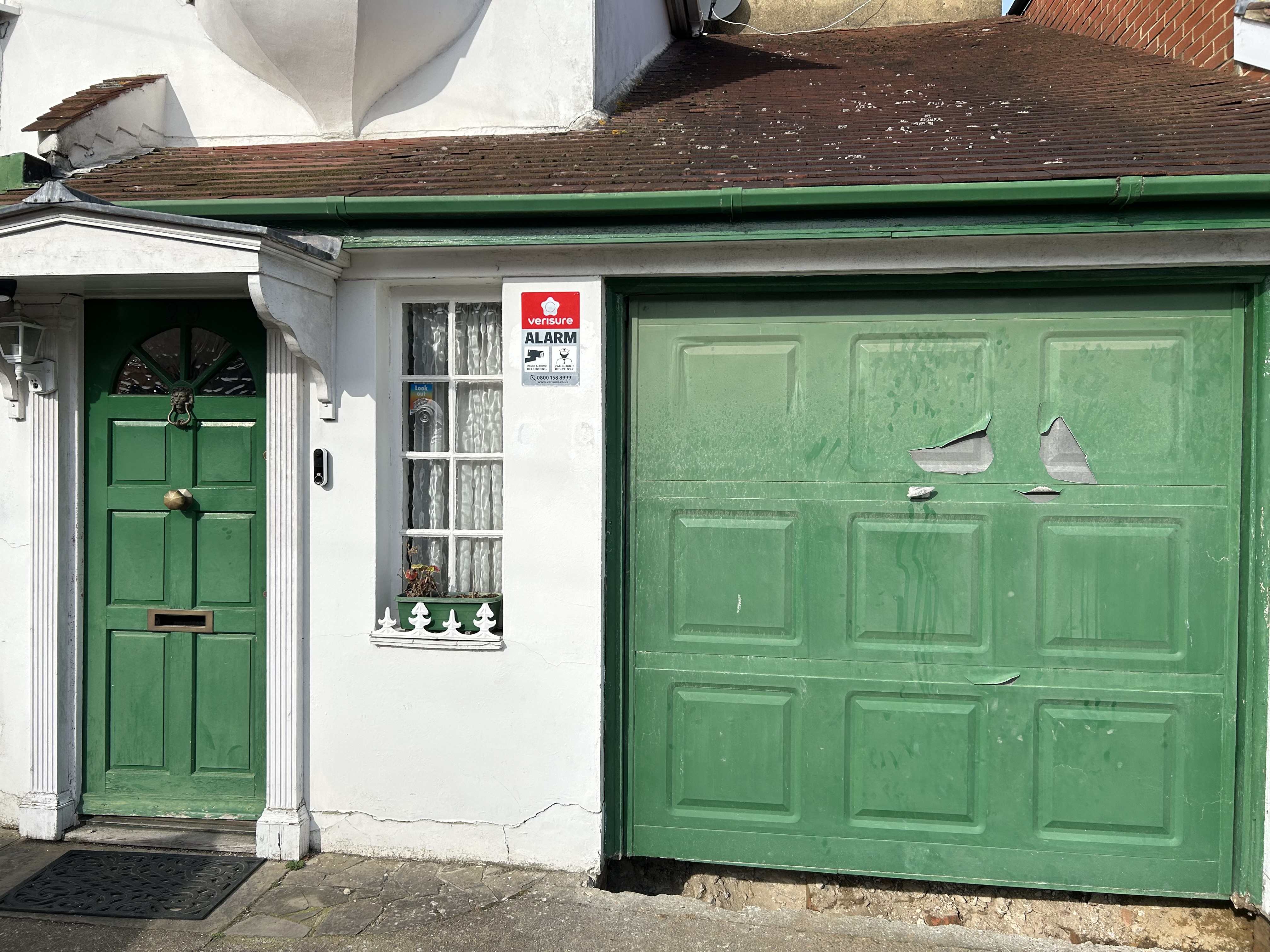

  1. Hello Friends post my previous post on the build over agreement for a garage conversion to a en-suite bedroom, wanted your inputs on the insulation for the garage. Attached pictures are of the external wall, what kind of insulation would be cleared by the BCO as I want to explore if I can achieve it with the minimal usage of the floor space. I will be discussing with the BCO tomorrow and want to be prepared to have a conversation. Second point - I am thinking of demolishing the existing porch and create a new one. Have 2 questions on it: I have the planning permission of around 2.5 sq mt, can I go till 3 sq mt and breach the PP As the porch is already built, what would be the insulation requirements and the size of the walls + insulation as I need to make sure if I am going ahead with 2.5 or 3 sq mt, I am not losing space due to new regs and I would then keep it as is. The reason for the new porch is new build and style vs the old one which was created decades back. attached are the pics, happy to share more info pics if need be

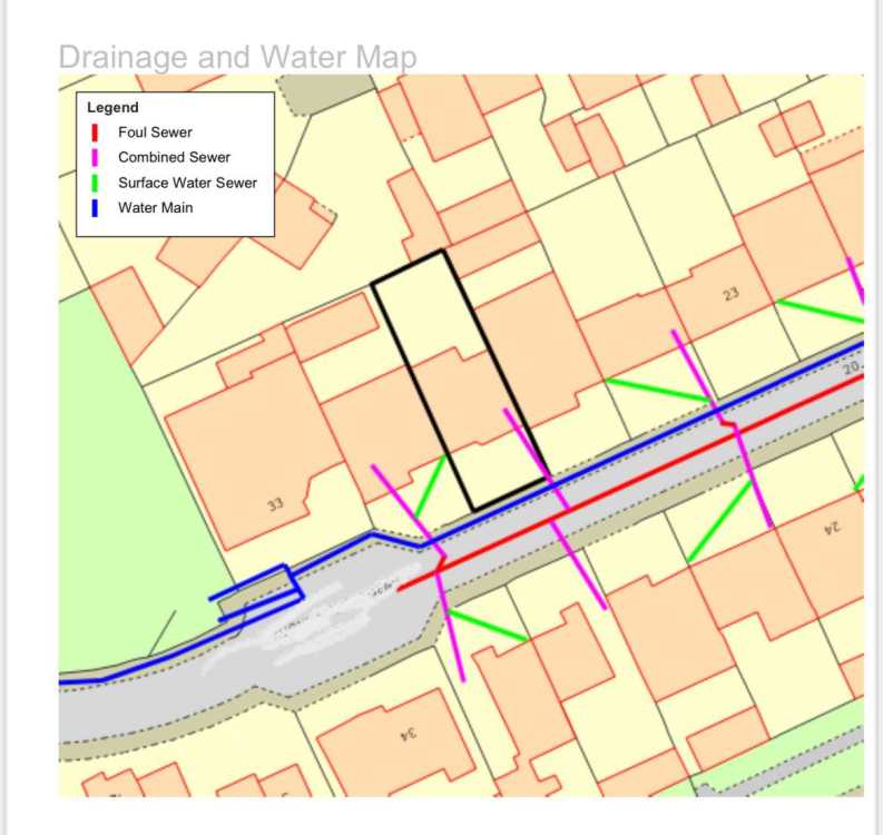

  2. Thank you everyone for the guidance. I pushed back and they have confirmed that the build over agreement is not required. My contention was the following in case it helps others: I am not changing the structure of the garage and it’s a conversion and no new build. the sewer is more than 3 mts away from the structure hence it falls outside of the build over agreement prerequisites. Thanks once again and I am relieved !
  3. Thanks for the assurance, will keep pushing
  4. How do I take this up with Thames water, I have written ti them already but checking if there is any other way.
  5. Thanks. I have the garage door where a new window will come up, that’s the only “extra” I am building. as the sewer is in my property and 3 mts away from the public sewer, does it still apply ?
  6. Hello Everyone I am planning for a garage conversion to a habitable room and my building control provider sent a consultation to Thames water and they reverted that I may need a build over agreement. I have attached my drainage search report (property marked in black) and I notice there is a combined sewer running within the property and which is for my use only. It gets connected to a public sewer which is more than 3M away and I already have a garage which sits on this combined sewer which is getting converted. would I need a agreement in the first place for this conversion ?
