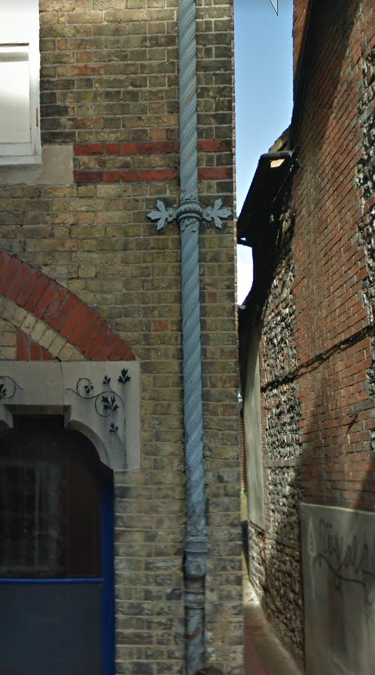

  22. Along the High Street are these on the Freemason's Hall
