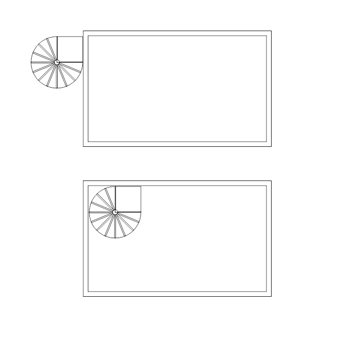

  8. It will be easier to have the stair either completely outside or completely inside the balcony, otherwise you will need to cut through the main balcony framework. To connect at the edge the stair would need a small landing at the top. The stair people can make this to form the top tread as a quarter landing with some holes so that you can fix it to your balcony. Get them to also provide for the outside handrail to return to the centre post at the top.

  11. With the spiral stair you will need to account for the entire diameter of the staircase being lost from the balcony. 1/4 for the landing and 3/4 cut out for headroom and protected by handrail. 1500mm is a sensible minimum.
