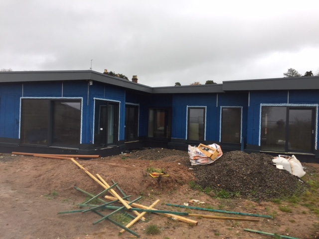

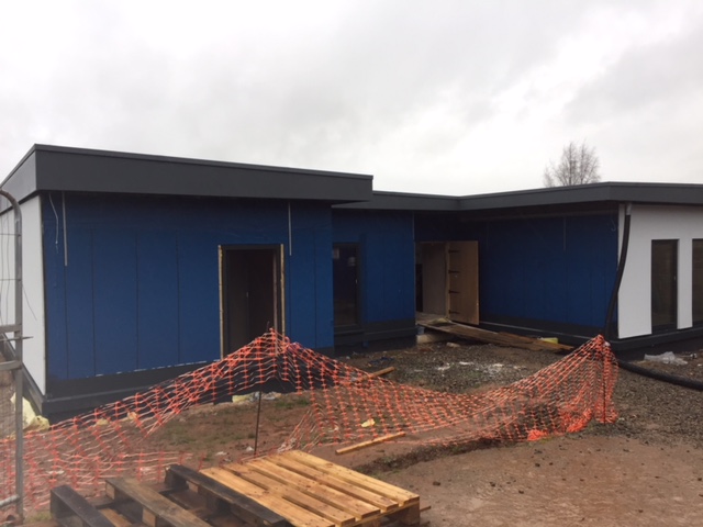

  22. We finally got the scaffold down today, oh how i had grown to hate it! Larch cladding next, starting to look a bit like a house now......only taken 18 months to get this far!
