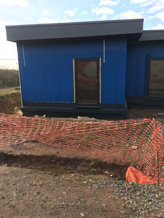

Ha ha Cpd and thank you for your nice comments. I can assure you that the blue downpipe will shortly be transformed into a perfect rectangular RAL 7016matt powder coated work of art to match our windows and flashings LOL Only have two downpipes on the whole house one at either end of the hidden gutter, I was talked out of having hidden downpipes so have splashed out on lovely ones that will be fit to view.

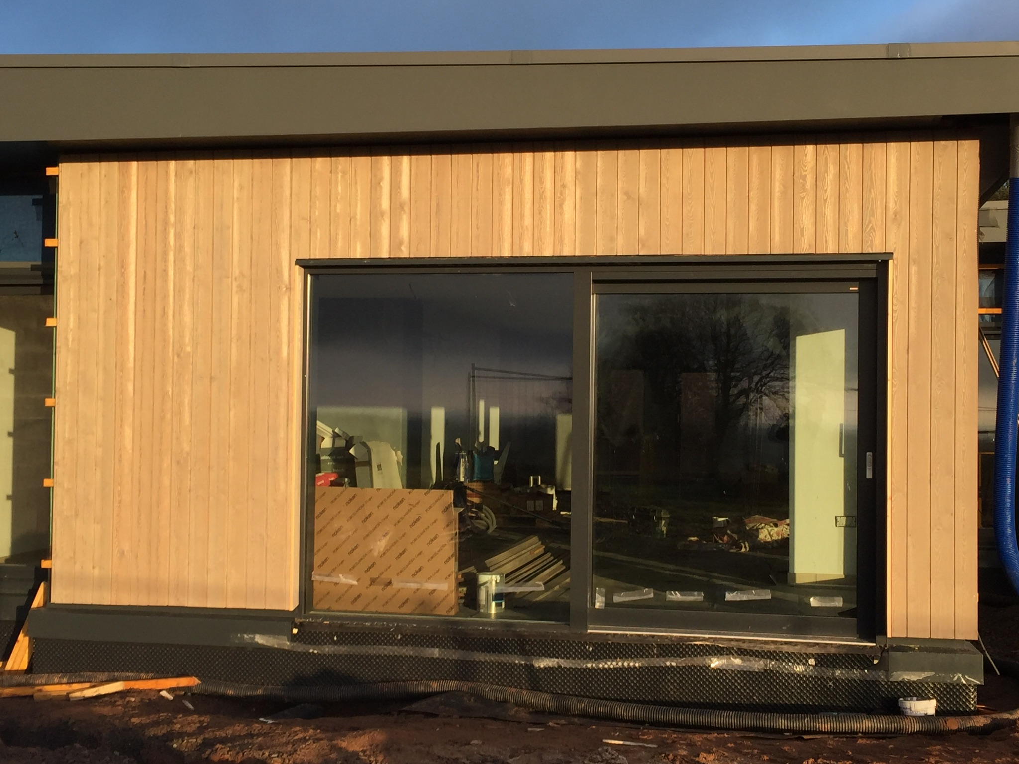

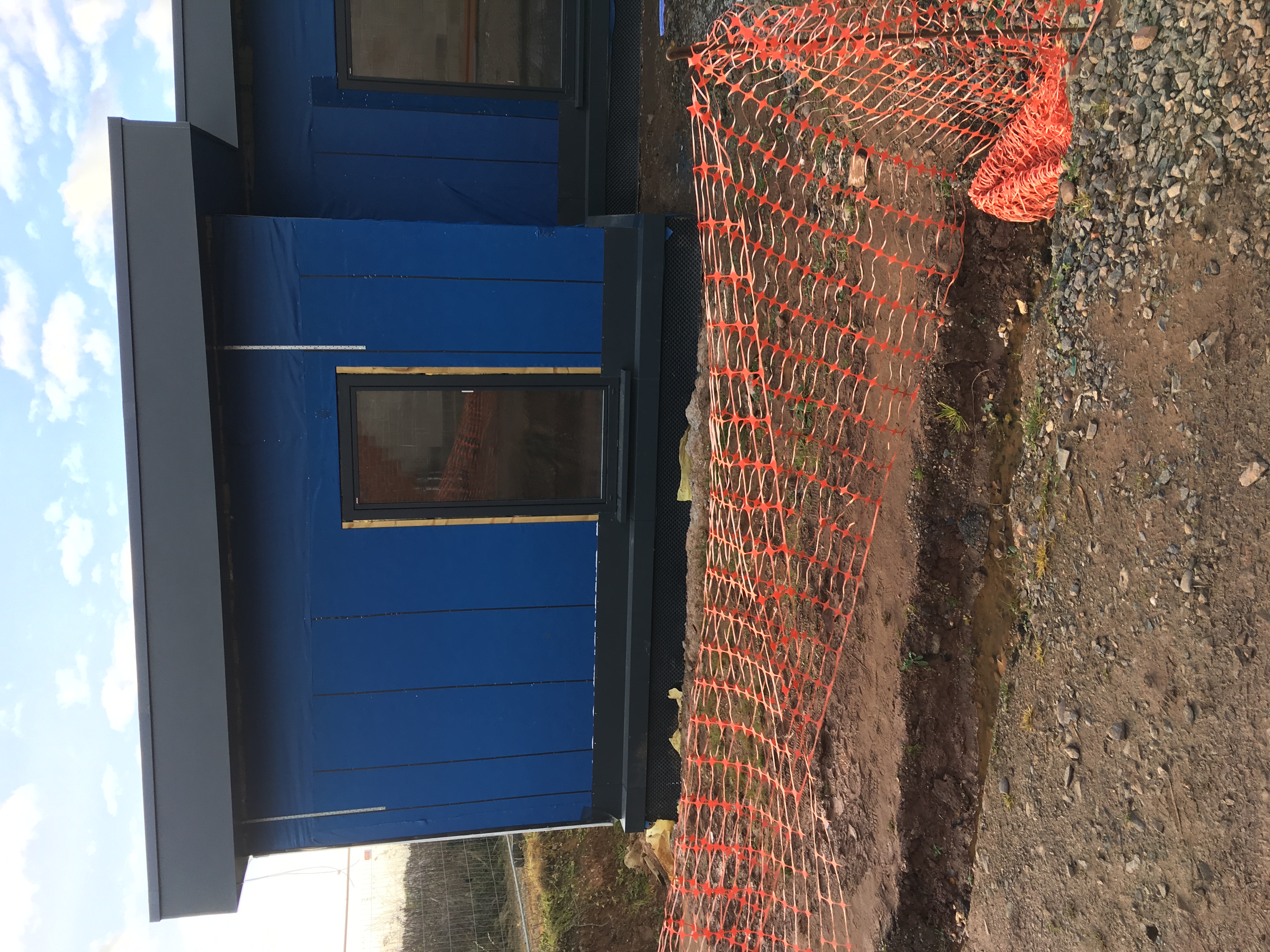

Cladding is going very well I am pleased I did a last minutes swerve from cedar to larch. Although you cant see it in this photo with the sun on it we do have a sacrficial coating of new age gris by Silva (we bought pre finished). It looks more grey without the sun directly on it. Still got to sort the leaking Internorm sliders!

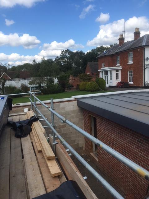

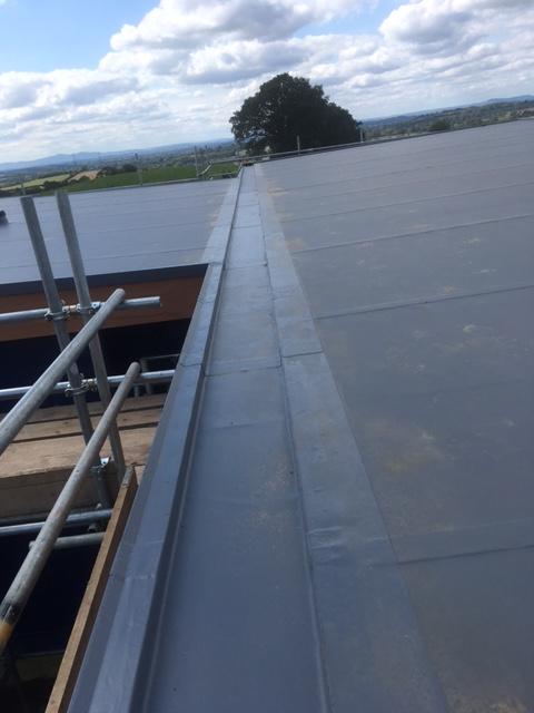

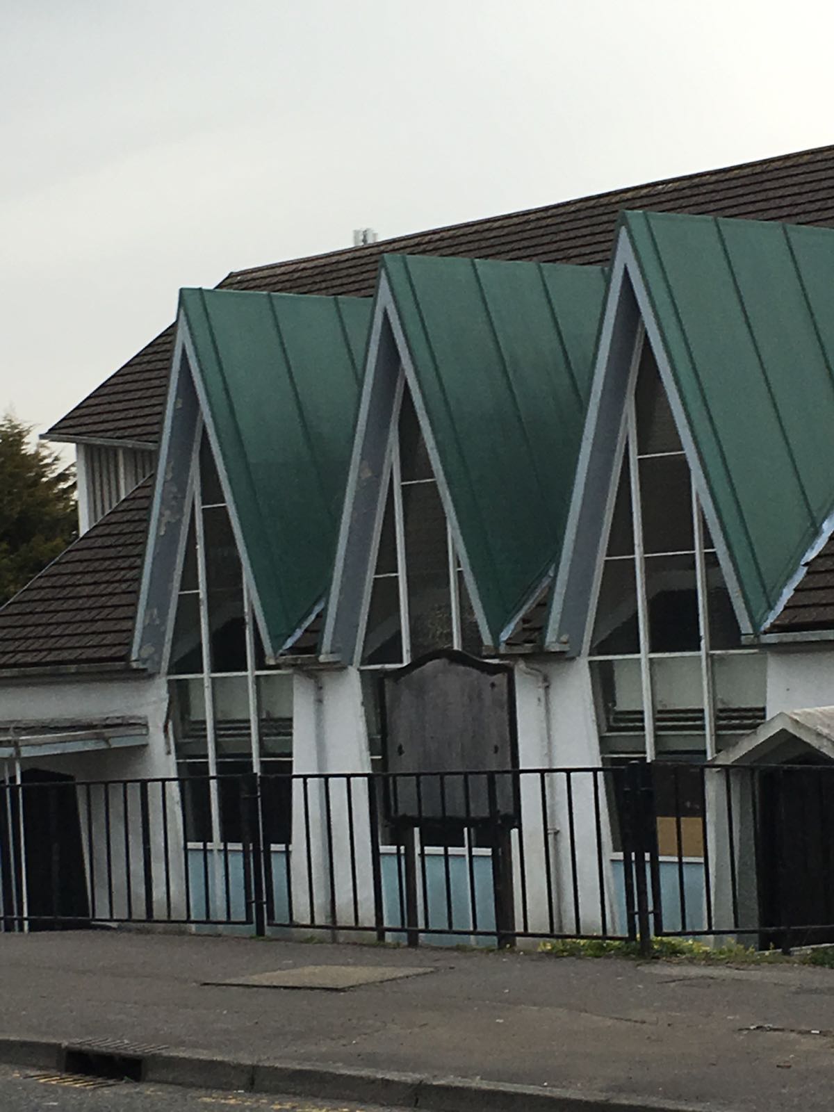

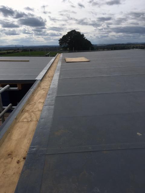

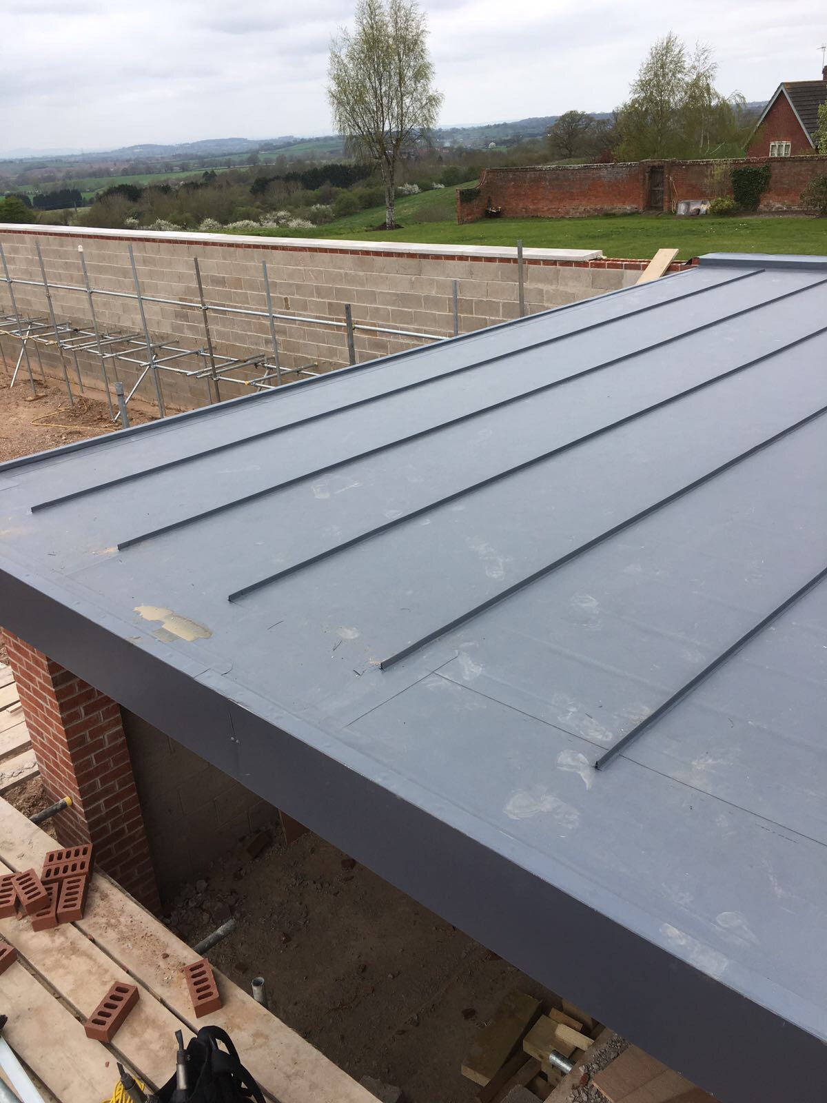

Hi Albert We had a complicated 3 part roof with a flattened out upward curve at each end with a flat area between the two curving up bits and this flat area houses the hidden gutter as water runs down the slope from either side into it. For about 280sqm laid with standing seam profiles it was circa 20k and that is laid onto a boarded deck, that price excludes the boarding. We used Fatra in RAL 7012 Lead Grey. Comes with an insurance backed guarantee is BBA certified and I am told it is pretty bomb proof. We have a powder coated aluminium border round the edge of ours as we are not a conventional pitched roof. I saw examples of some done nigh on 20 years ago (the pic of the pointy roofs) that as good today as the day they were done. Cant find a birds eye pic of the finished roof but here are some of construction of roof hidden gutter and one of garage when they were putting putting the profiles on. Having had several metal roofs before I am very happy with this system as an alternative to the metal roof finish. Its a warm roof on an MBC house and we have passive standard sun pipes going through as well (all approved by mbc at design stage). From customer point of view it worked like a dream.

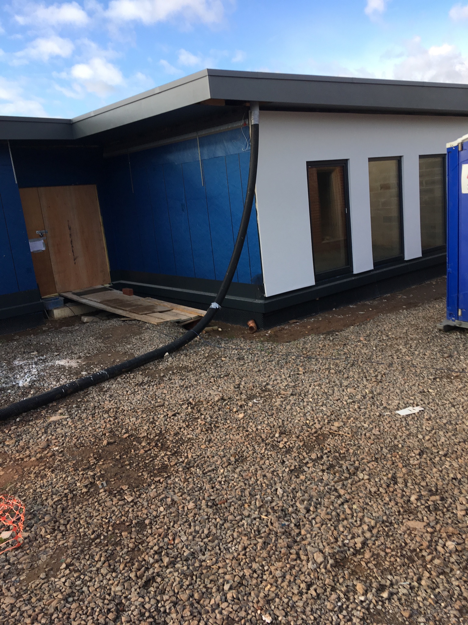

Ha ha I think Peter will be alive to possibilities, he is no slouch! There was much debate before finally settling on this as a solution and it works well enough. We did get ours done in a matt finish I was very clear no gloss on anything, think you are right about gloss being default, we are very modern style and gloss would have been wrong for us. Ours looks to be deeper over the EPS than yours it goes down quite a way and yours perhaps higher up the wall. We are part render (alumasc) and part larch clad with internorm 3g aliclad windows and doors. Did you only have Peter helping you for MBC for that part of your build, are you going it alone for the rest? We have been at it nigh on 2 years now and you look more finished than we do LOL We had a lot of issues to get past. Still getting there on some things but light beginning to appear at the end of the very long tunnel. We are on the Warwks/Worcs border near Stratford upon Avon. On the top of the Ridgeway with clear views across nearly 40 miles to the Malvern Hills and home beyond - I am Welsh but South, don’t know your part of the world at all Derek. Kitchen fitting going on at the mo but outside is a nightmare of mud, groundworks not finished yet. -

Is that a metal roof? It looks very nice. We have the same standing seam finish look on ours but it is single ply membrane not metal looks just the same and less chance of coming home from holiday to find the roof stripped LOL
