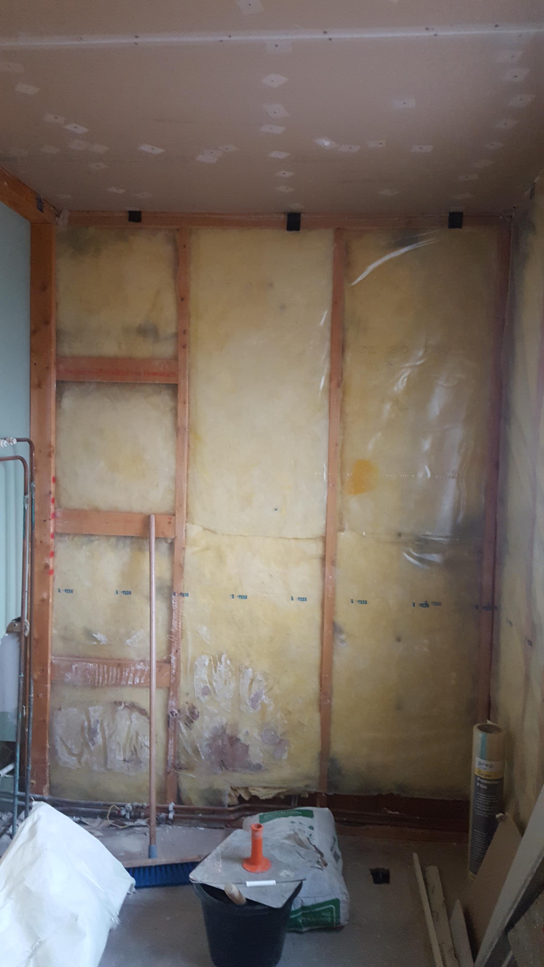

You could find more cold rises through the floor if it's block and beam as there won't be any insulation below that in a 90's build. Photo of 90's built timber frame build.
