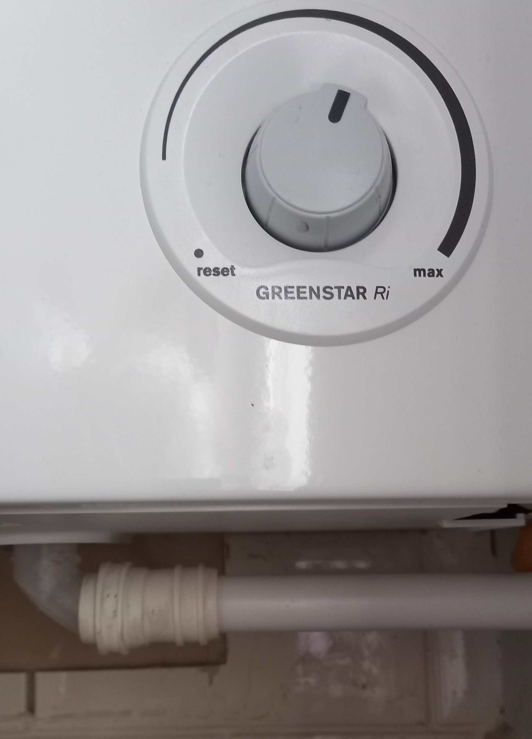

Couple of issues I've come across with the outlet pipes and draining off of the condensation. The pipe exiting the boiler has had a slight upwards incline and so trapping water in the first section of pipe below the boiler. Mass builder's don't you love them. The sink drain (U bend) has had a partial blockage and so backs up water to the condenser pipe. With an external venting condenser pipe this has been sat on a gully cover and frozen upwards with a large ice core. All of the above have caused the boiler to shut down
