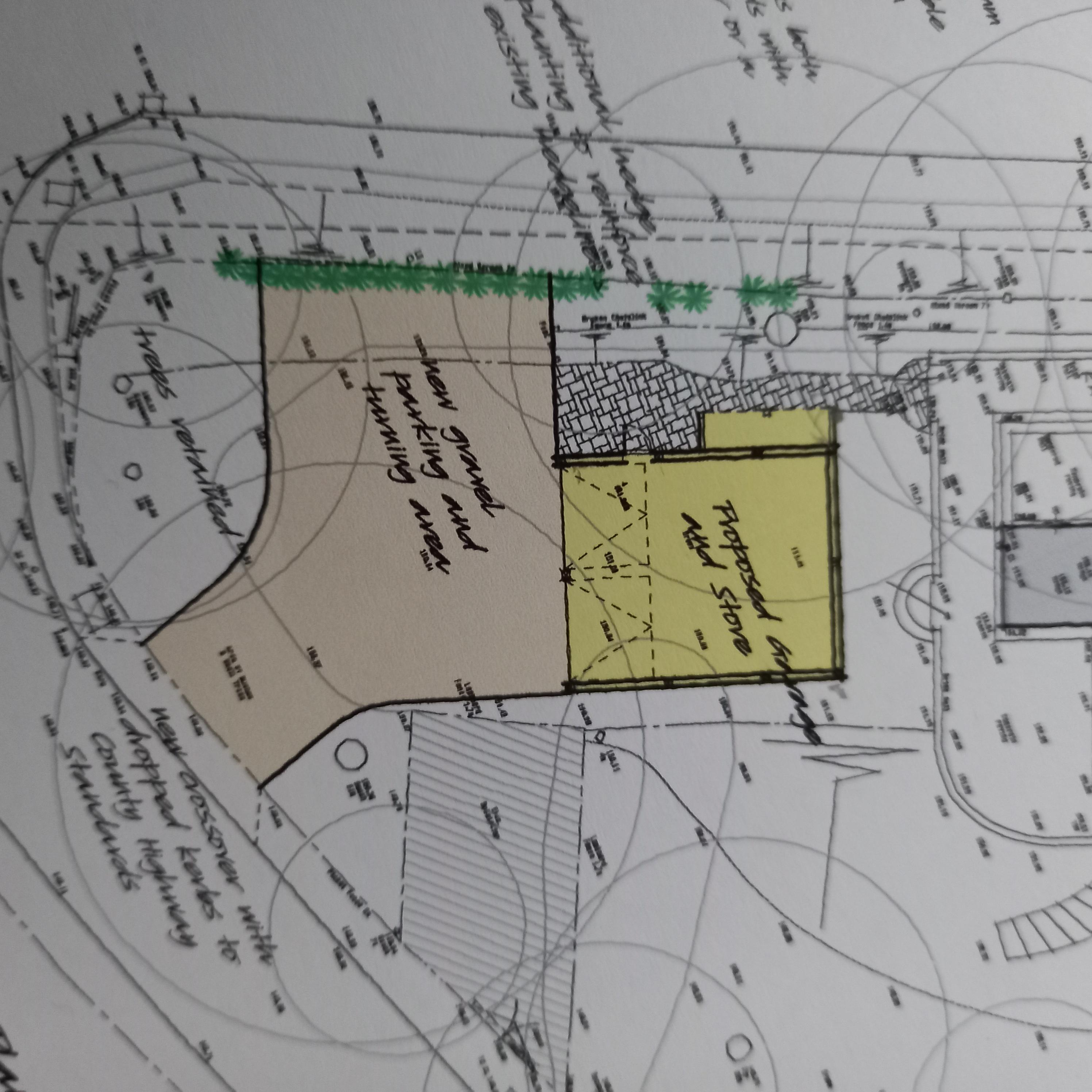

Validating Planning To Keep It Live
twice round the block replied to twice round the block's topic in Planning Permission

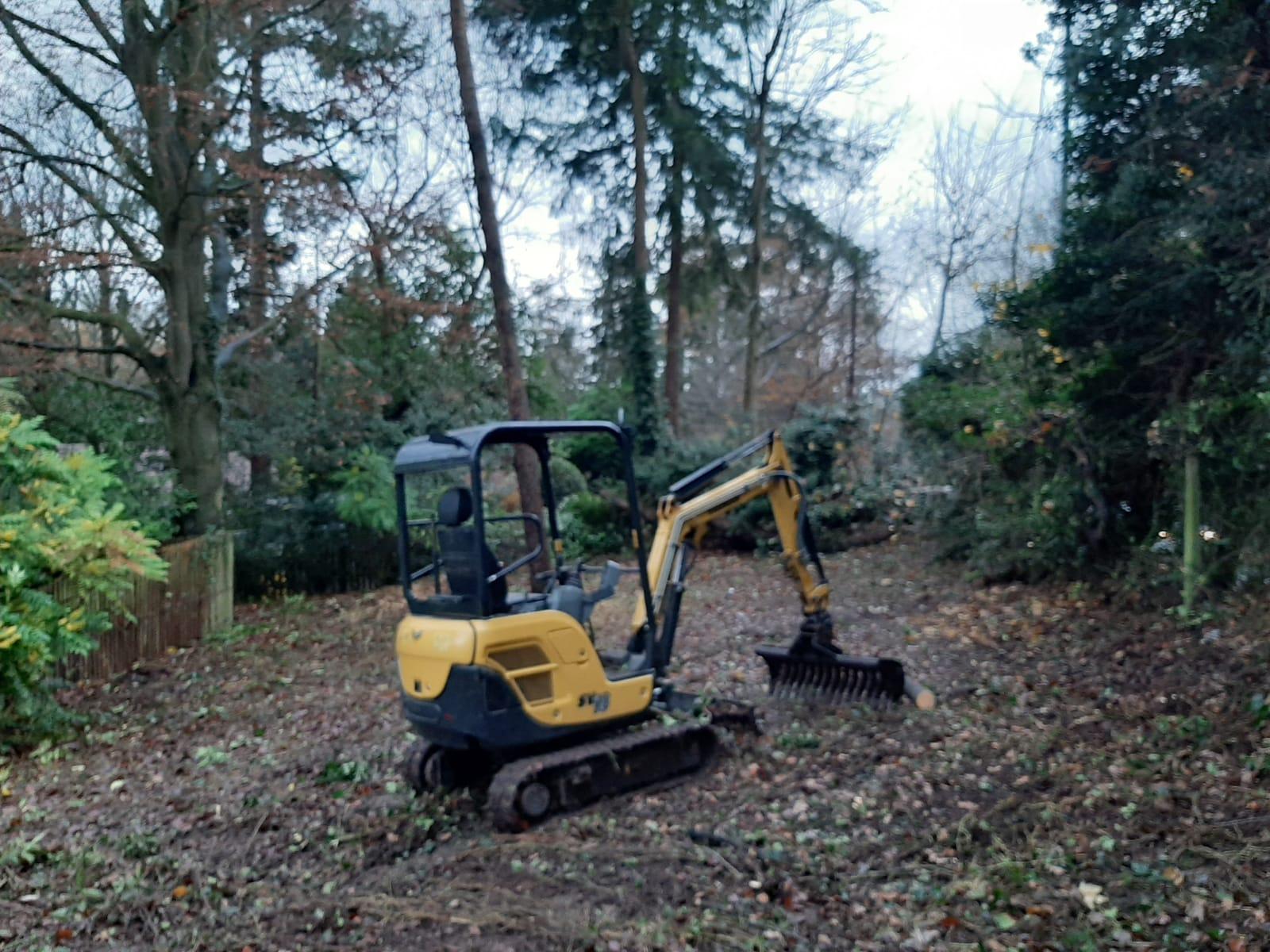

The sight plan on my original post shows where the tree canopy / root spread is on site. Where the digger is located, that is the position of the garage footprint and the spindly pine behind the digger has now gone as it was dead at the crown. All a bit of over kill for the footings from an over zealous tree officer. -

Tree survey stipulates we have to have a pile foundation with fully suspended slab. Footprint is 6.5m x 8m. and the garage construction is timber with timber cladding under slate roof. -

Thank you for the input by @Mr Punter and @saveasteading Council have now informed us that we only need to put in a small section of piling for the garage foundation's and not the full footprint. Don't need to do the drop curb, drive or parking area. Bit of a result for a change. Have another go for a house in a couple of year's, hopefully the restrictions would have been lifted by then. -

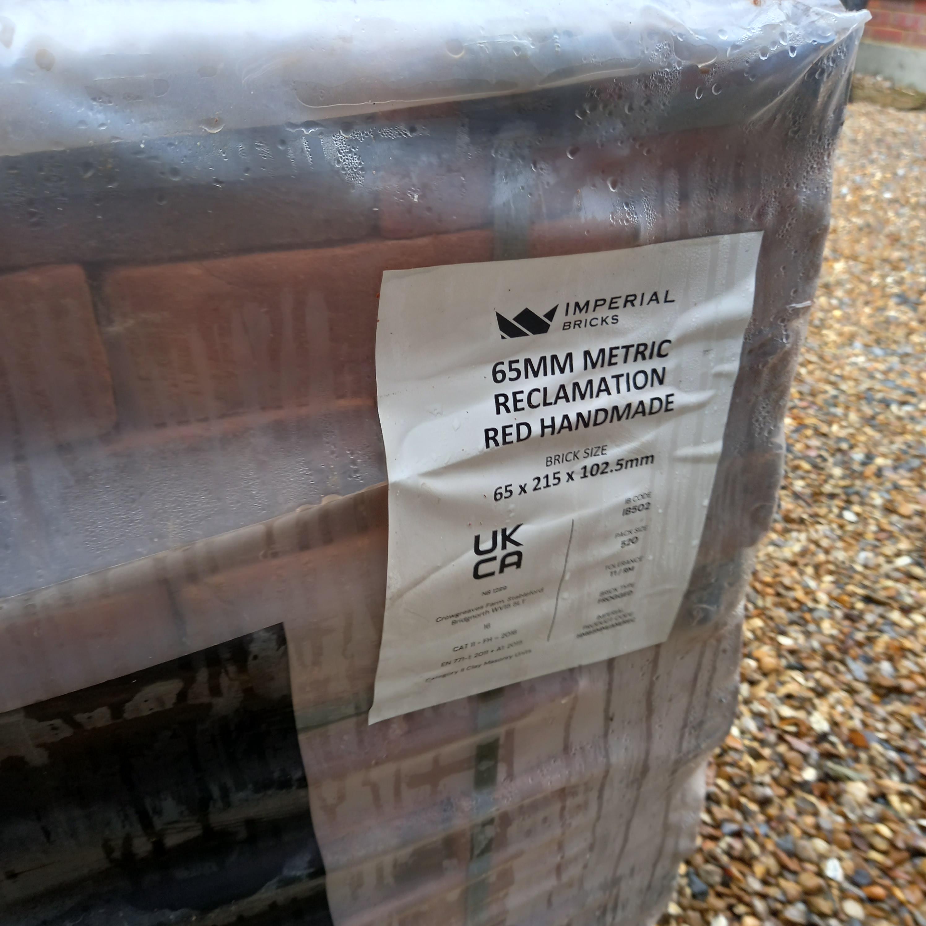

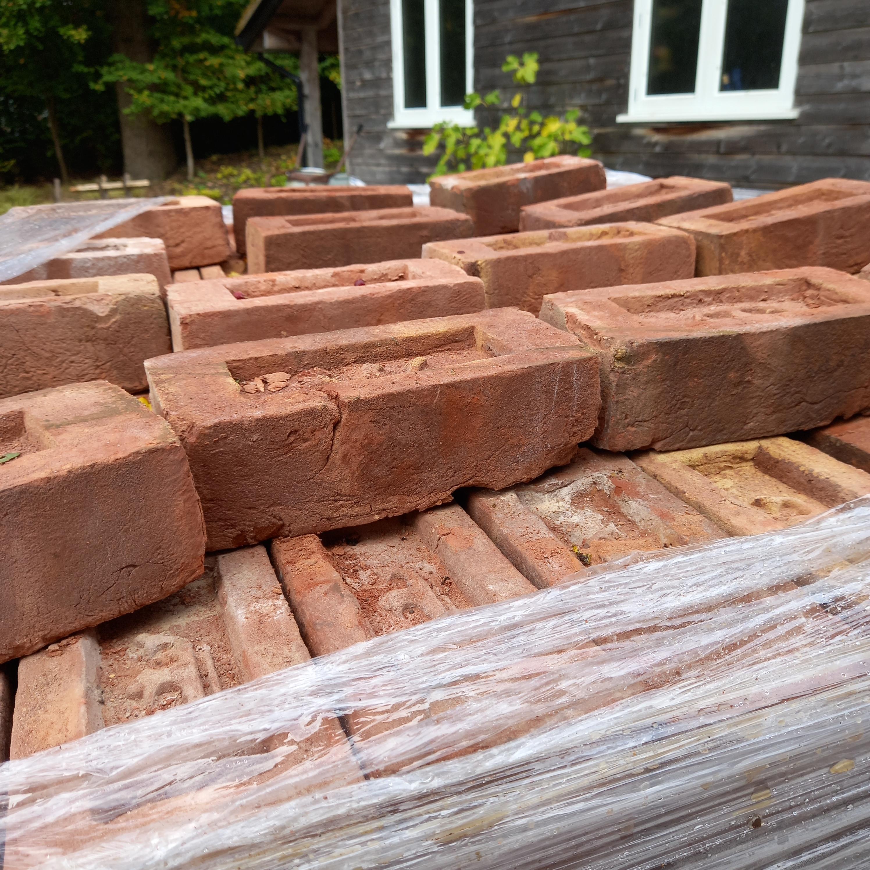

If you know what make, colour and how many bricks you need for the build, plus outbuildings and landscaping ie. 12000 it puts you in a strong negotiation position to get the price nailed down low even from your local builder's merchant's. The building game is suffering already due to the economy, and even more now due to the current rain and the onset of winter. I bought a few thousand handmade bricks from a builder's merchant's last week and they almost gave them away, and they are a nice quality brick and a stock item should I need more.
Advice on sourcing some matching bricks please.
