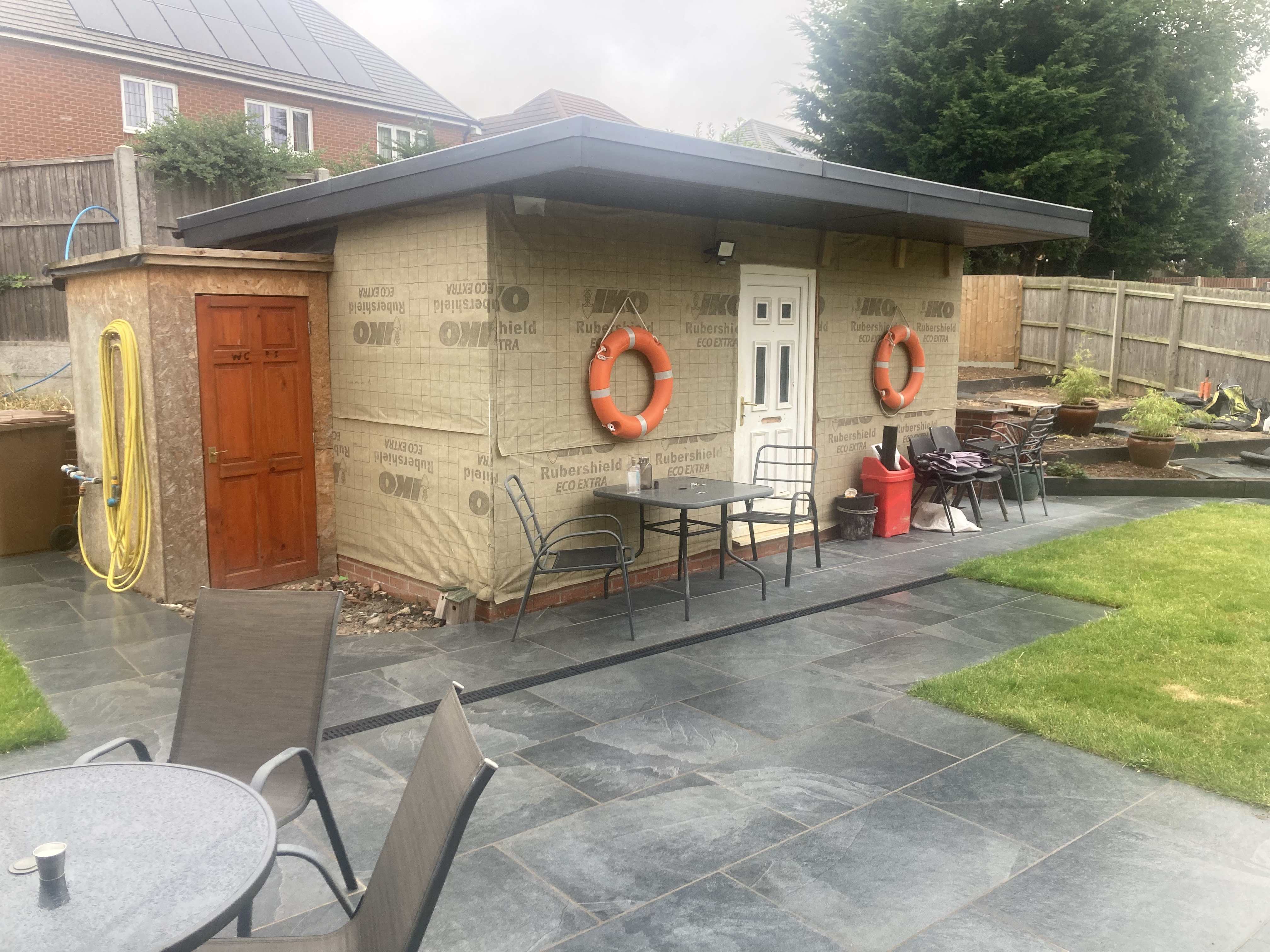

Ahh I see. I've just been checking and I had originally got planning for the 'garden room' (man cave) and the drawings that I submitted no dimensions on them so I think I should be ok as long as I don't extend the 'bin store' upwards. Excuse the mess in the photo its work in progress 🙂 -

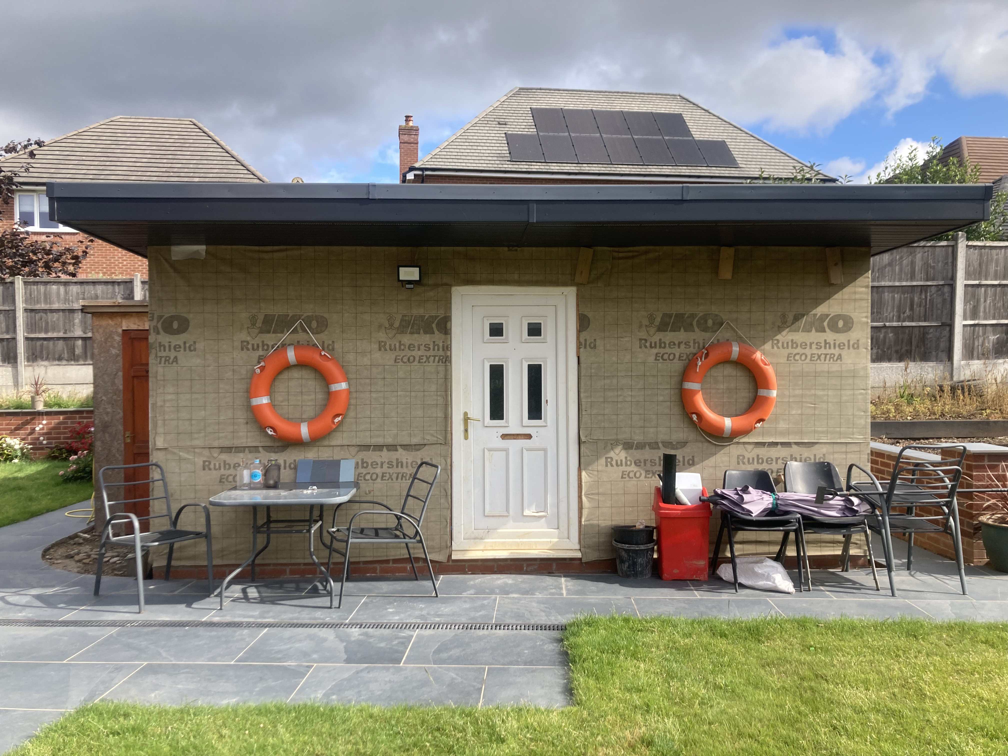

Interesting. Is this method of measurement the same for garden rooms? I excavated 1 m into a slope and built it a little bit higher than the 2.5 m max at the high end which is about 1.7 m above the retaining wall that is holding the slope back. -

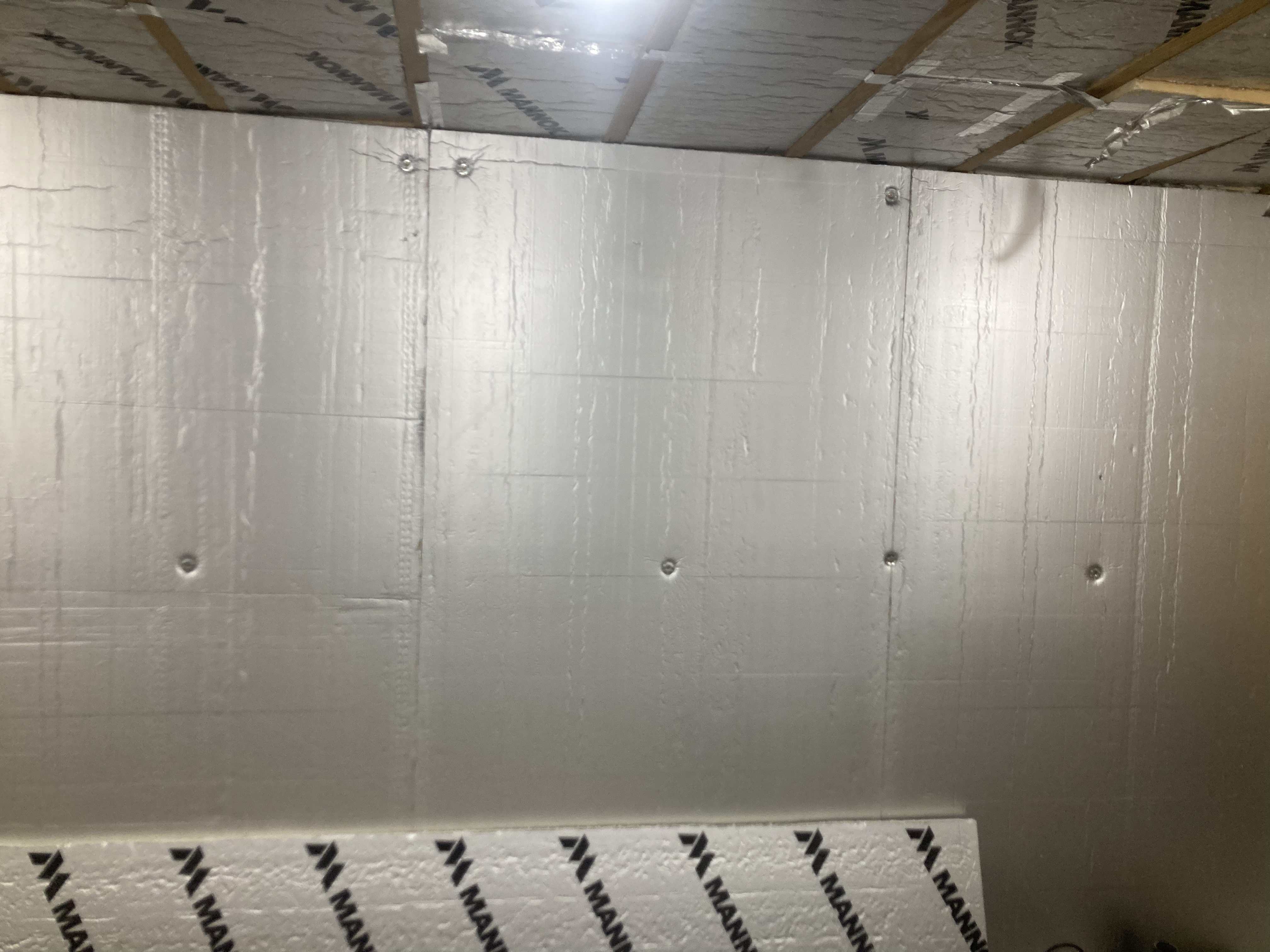

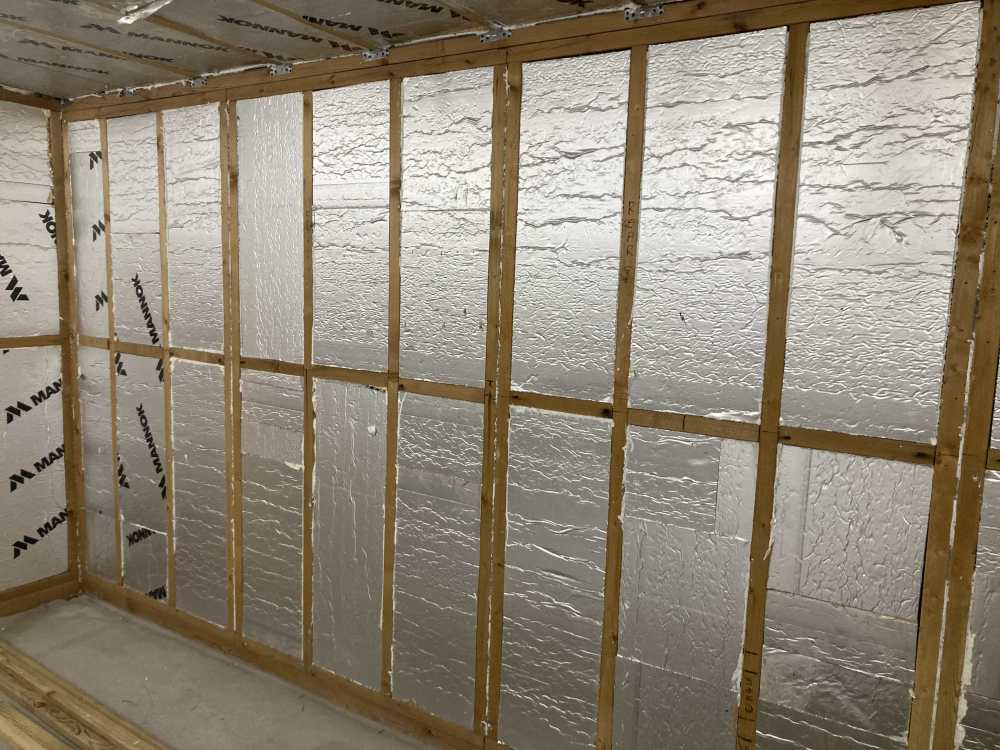

Hi all, Now that the house is 95% complete ( I’m just waiting for the electrics to the heat pump to get sorted to give us heating) I move on to the garden room. I built it prior to the main build and used it as a site office / store/ temporary toilet. It is stick built out of 4 x 2 with 90 mm celotex between the studs and the roof out of 7 x 2 with 90 mm of celotex between the rafters and a gap above for ventilation. I am now in the process of installing an extra 25 mm of PIR to the inside which I will seal and tape prior to adding 2 x 1 to create a set is void prior to boarding. The outside will be clad in either cedral cladding or timber. Seeing as the PIR will be well sealed and taped on the inside do I still need to install a vapour barrier as well ?
