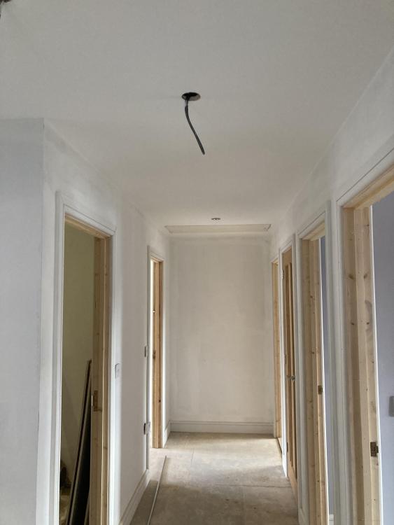

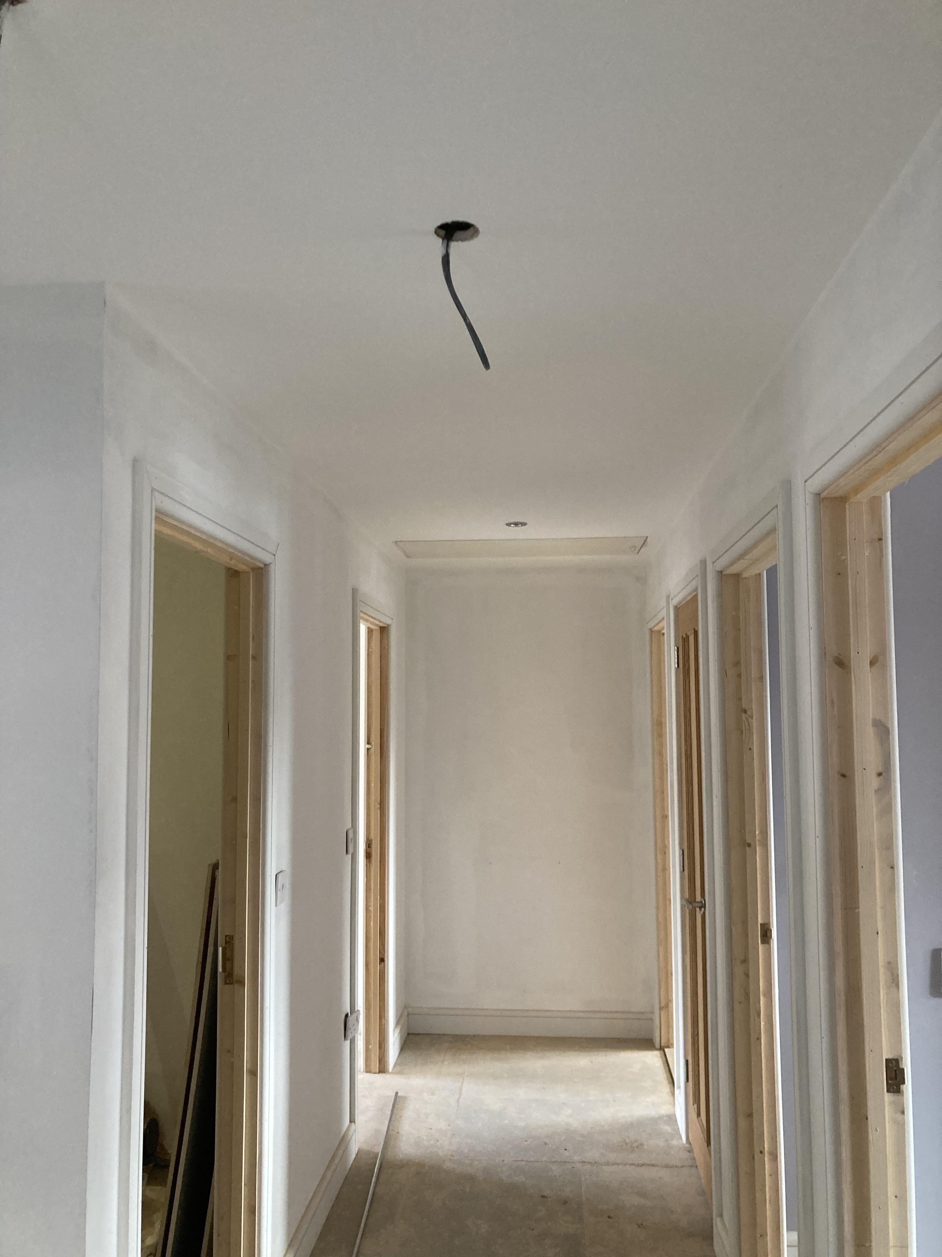

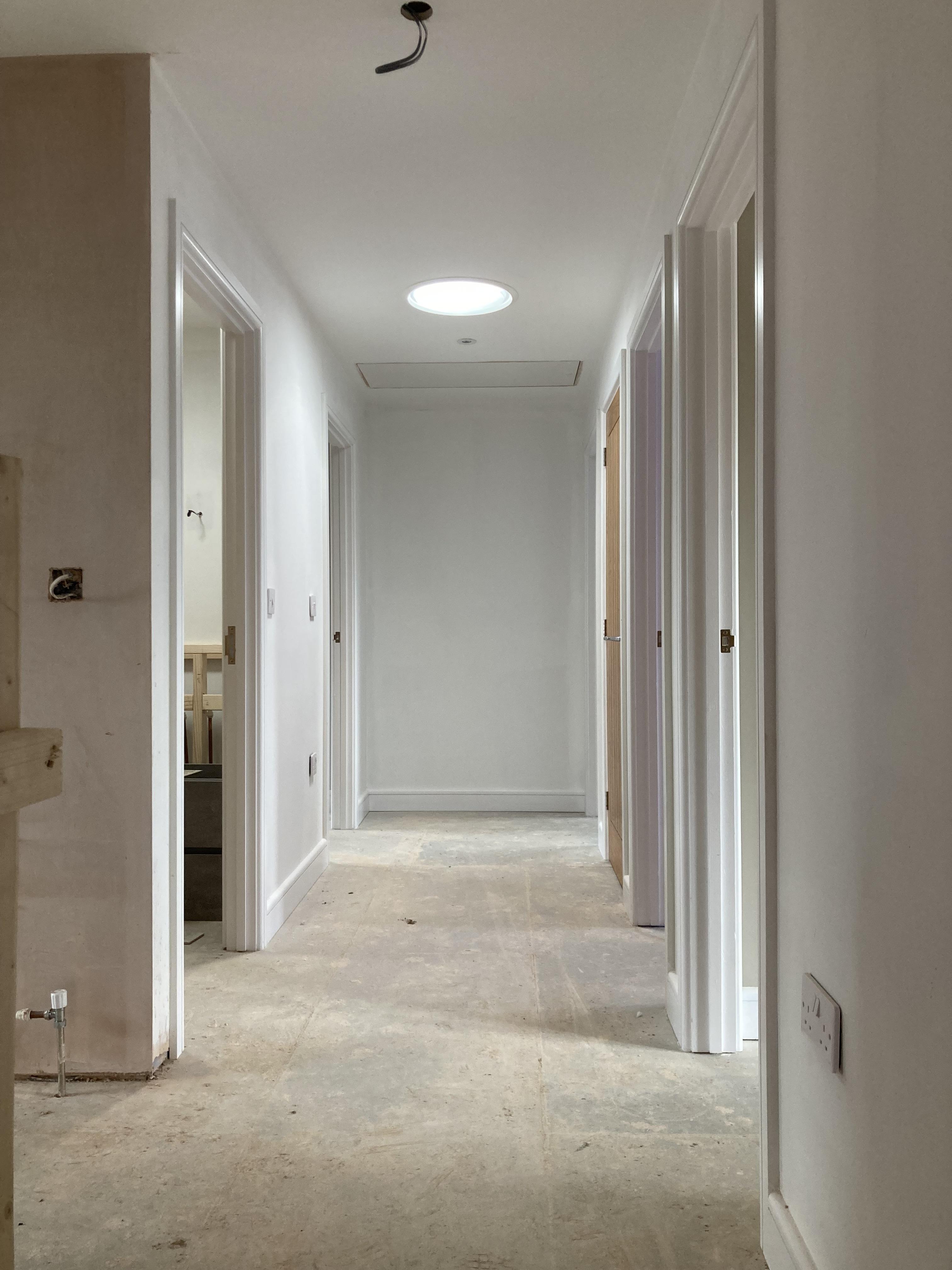

  8. I'd go for the smaller one central. You will still get plenty of light but may regret it if it's not central. I had a battle to get mine in the centre but glad I did. Phone just died on me so photos later.
  9. I fitted 2 14 inch Velux in to mine and none in the identical house next door. The difference is like night and day ! I am on site I'll post some photos soon. I don't regret it for a minute.
