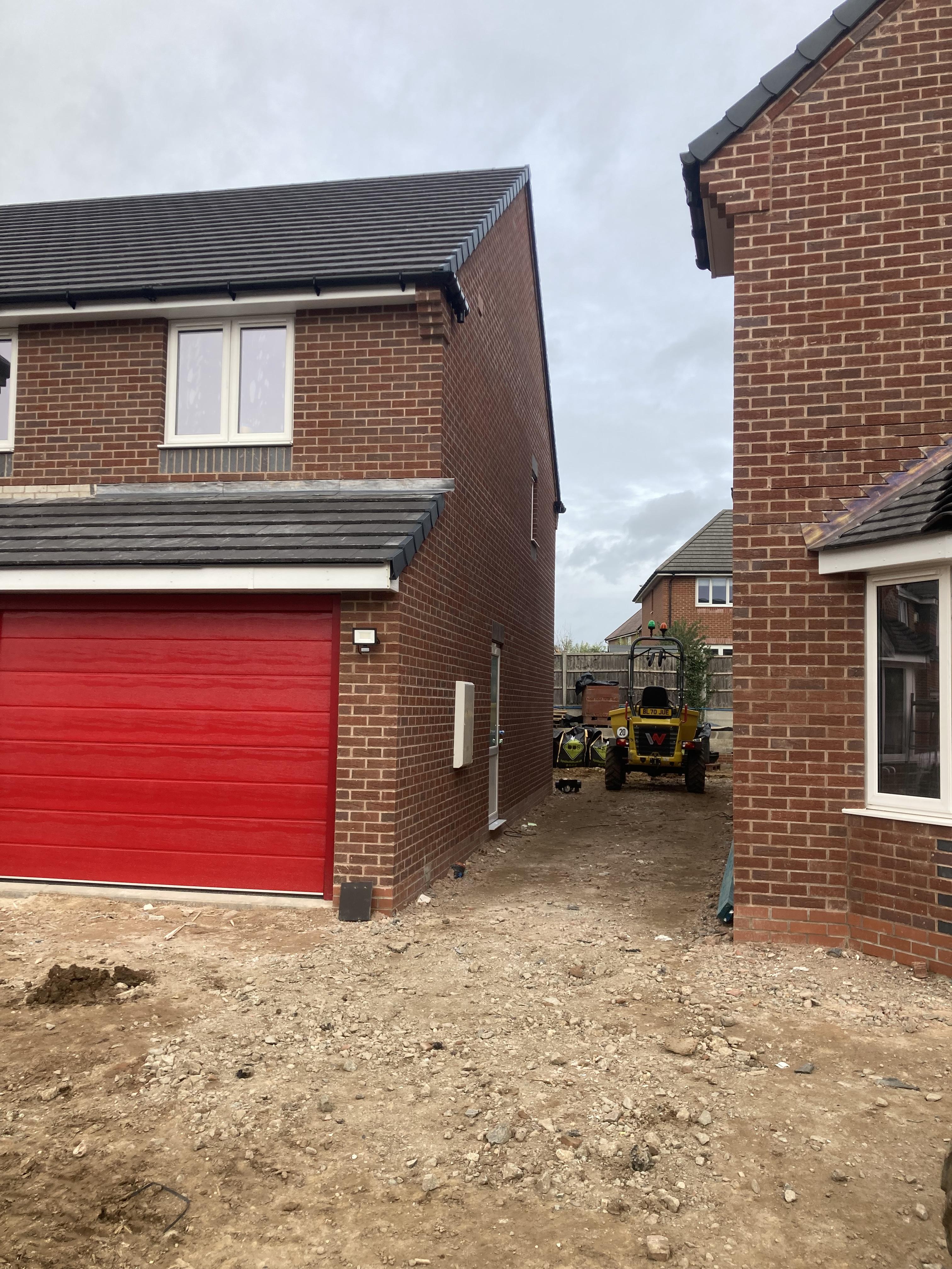

Thanks Russel. I’ll try them for a price. it’s D trim I’m after about 50 mm to cover a 20 mm gap. Seems to be available in plastic but not aluminium. -

Hi Russel can you let me know the supplier if possible. I have a garage door with an excessive gap between the frame and the wall. Id like a 50 mm D strip in aluminium powder coated to match the bright red garage door but I’m struggling to find a supplier for this. -
