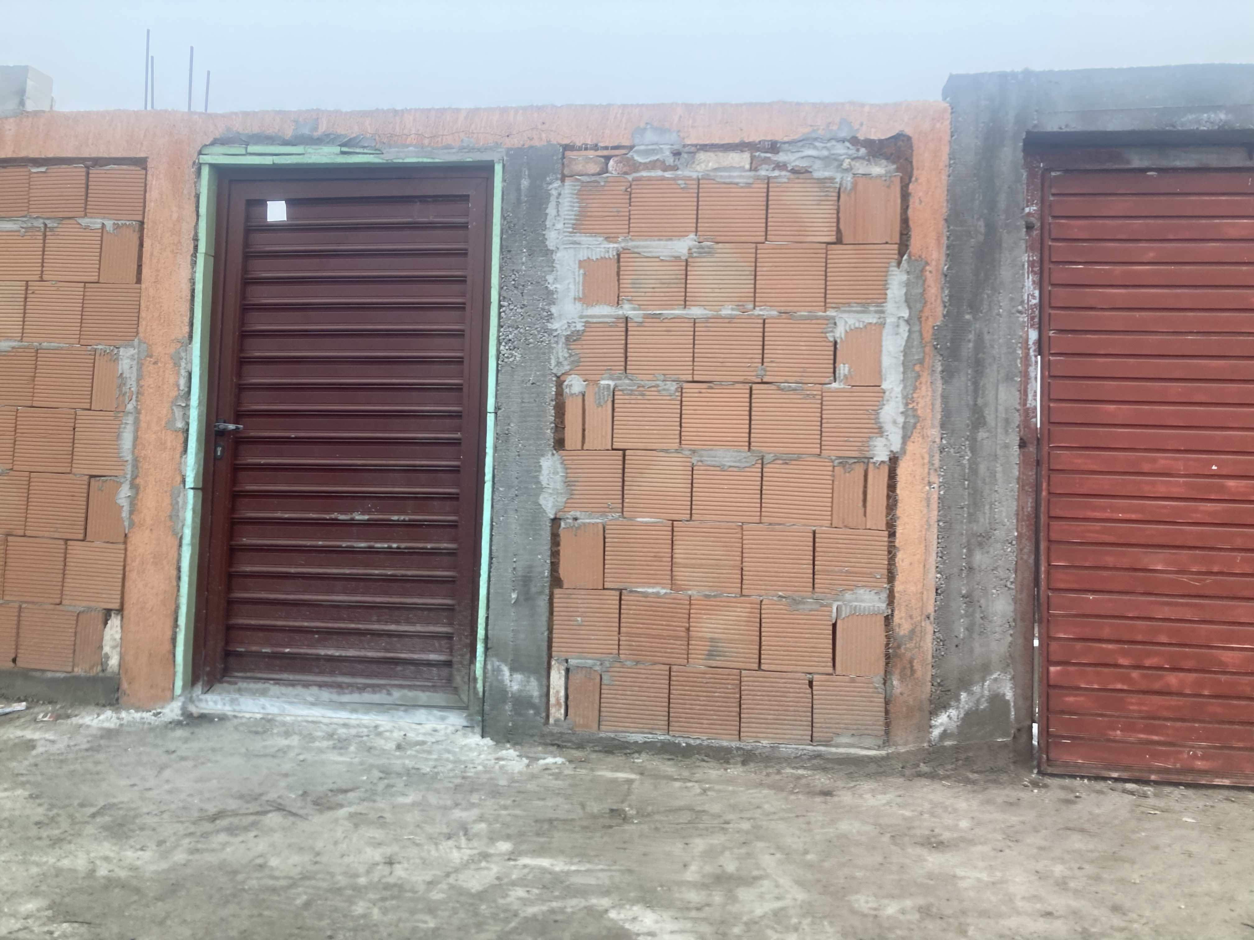

Unbelievable brickwork , will this pass building control!
Canski replied to Jamo73's topic in Bricklaying, Blockwork & Mortar
below par Bulgarian -
Why is the insulation lower than the courses ? And where are the wall ties?
Allow them to scaffold your side and pay to have it rendered. Problem solved ! Try painting an 8x 4 sheet of vertical plywood from the opposite side to the paint. You may finally see my point then. -
I’m guessing you refused then. We want to do a professional job but when people deliberately put obstacles in our way something like this happens. I’d have left the snots hanging. (Just saying)😜 -
I note that you have not answered the question so I’ll ask it again. Did you give them access to build it from your side or did you refuse ? -
