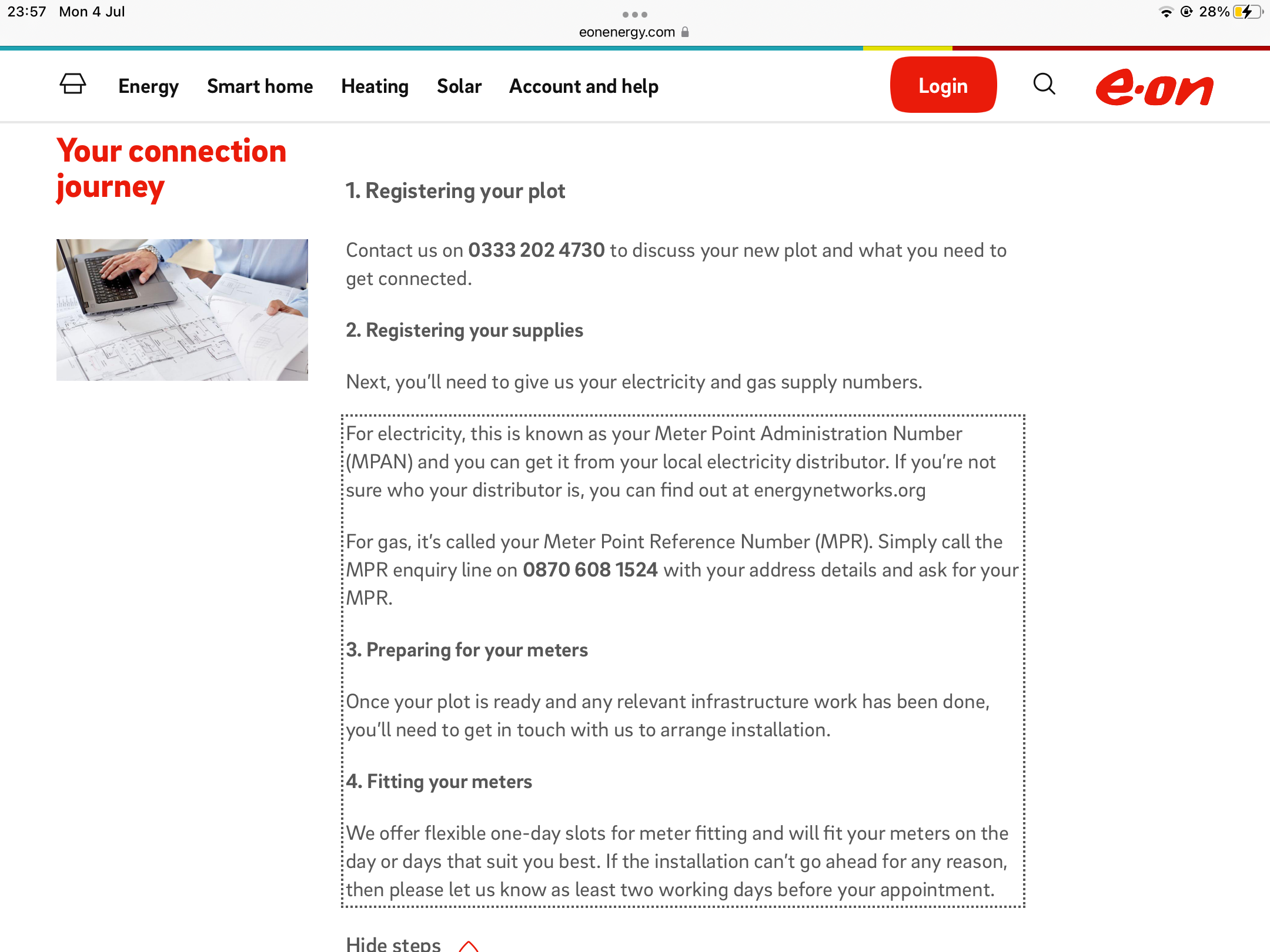

Just had a quick check with Scottish power and eon and they both say the same. need to get reference numbers from the DNO. worth a call though I suppose. -

Delays with service quotes from DNO
Canski replied to Canski's topic in General Self Build & DIY Discussion
I would love to but I’ve been told by the distribution network operator i.e Last mile who connected all the other properties on the housing estate that I have to go through them. -
