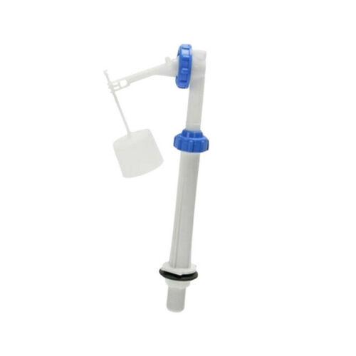

Look for this type called a Torbeck which I have been using for years with no issues, if I had the one you have then I would have the same issue.
