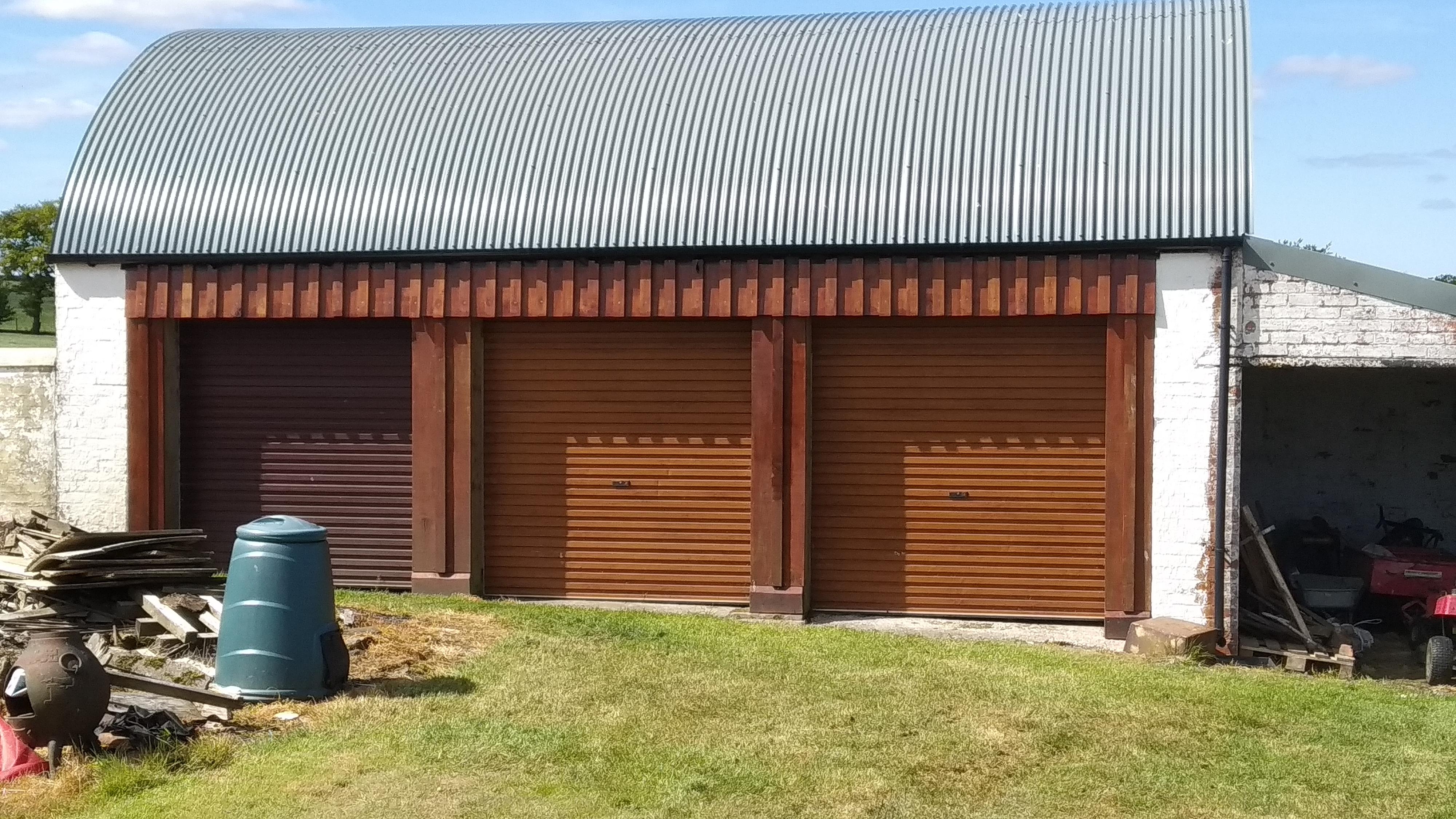

Found one dated 2020 so verticals 3 years old at this point and top just put on, looking closely I had topped up the 2nd from right, column farthest right edges are fading but only the coating. -

Worked for me but they are east facing only and I am on the west coast of Scotland so they are relatively sheltered except for the morning sun. The wood has not faded but the Osmo will need another coat in the next couple of years which will be 7 years after the 2 coats. Its oak cladding on a triple bay garage, I used stainless nails so there is no staining from rusting nails. Will post pics later this week, one just after and a as they are now. -
