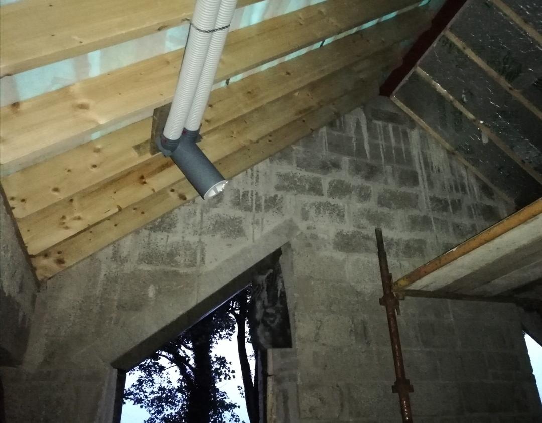

cwr replied to richo106's topic in Mechanical Ventilation with Heat Recovery (MVHR)
Here's what I did. 125mm of pir was then fitted between the rafters and 60mm under, then the airtight membrane then battens and counter battens (each 22mm). The duct ended mostly 'in' the 60mm pir, on the outside of the membrane. -

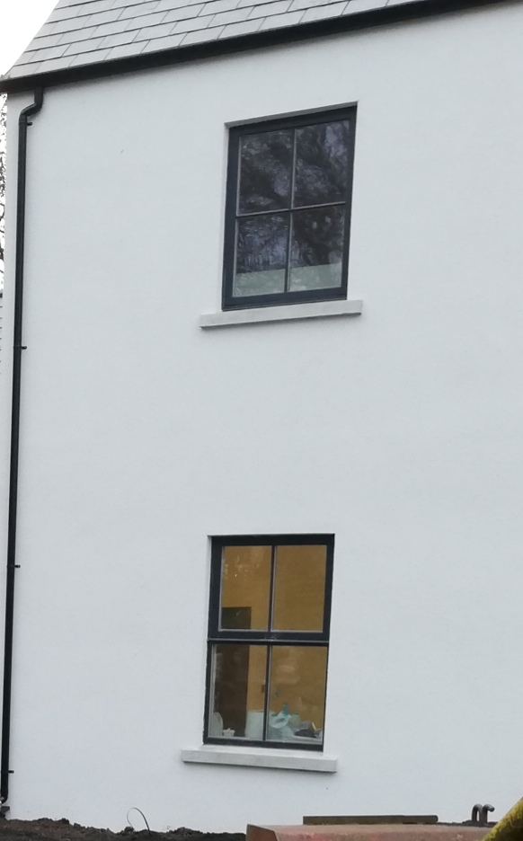

Anthracite Formaplus on white render any good to you?

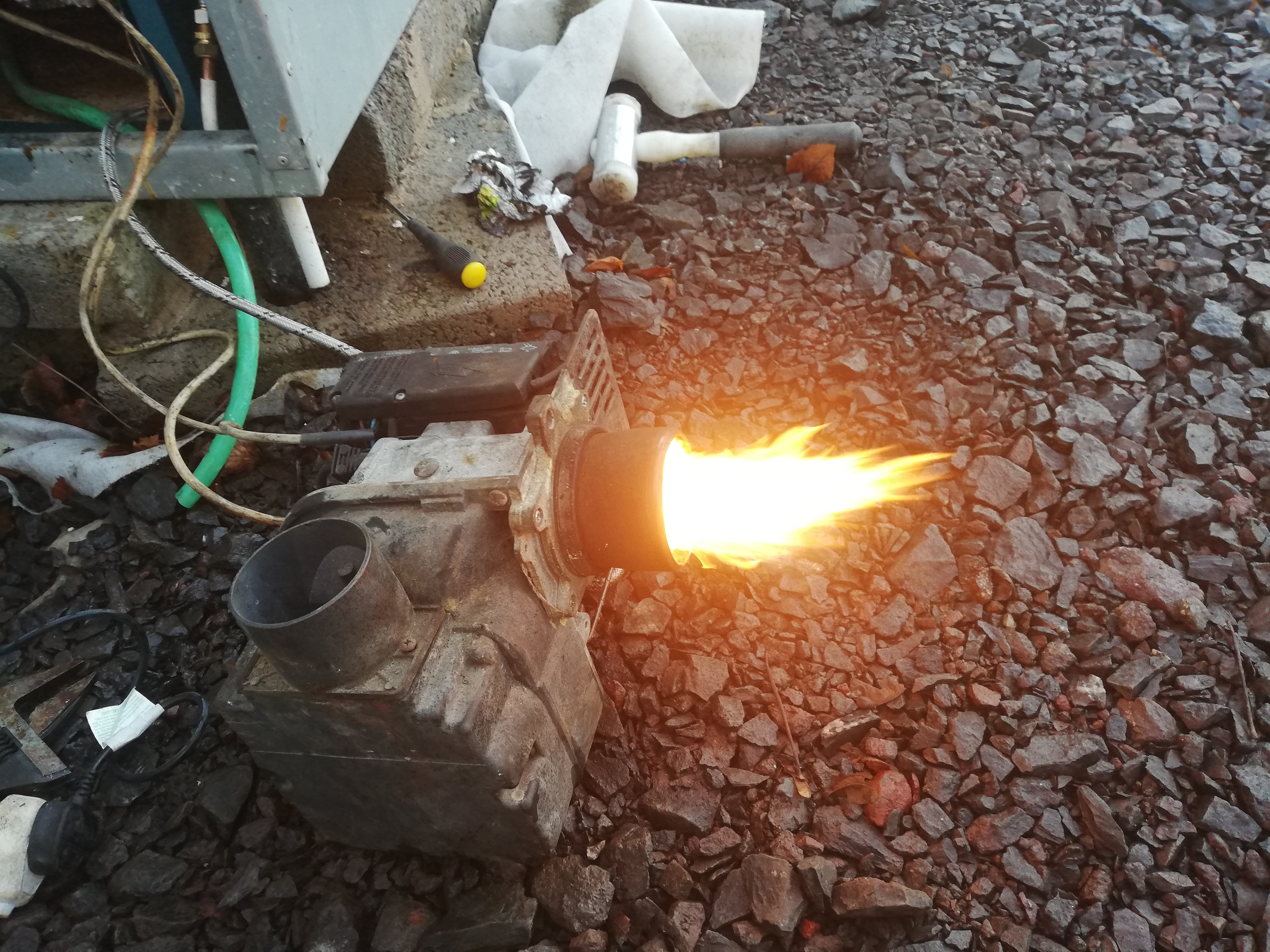

Thanks for the replies and advice. There will be someone coming round to comission it at some point soon, was just trying to get it running reasonably in the meantime time. The plates look to be good condition. Still, in my mind something has changed. It ran 'fine' for a couple of months and now is very different. I used to have access to a flue gas analyser when I worked wit gas appliances, but unfortunately not any more and don't see any point buying one.
My gut feel is that the water temps a minor variable in this case, but i could be wrong so might be worth checking. Yes it Ignites straight away. It's a Warmflow BH series. I fired it up in the ground out of the boiler, not too sure if the flame shape is correct or not. The flames seem to lick round the inside of the burner a bit. I expect it would look different inside the boiler. Tomorrow eve hopefully experiment with the plates out.
Not particularly high. The stat on the boiler is graduated 1 to 5, but I guess something like 50 to 60 Deg. I'll get round to measuring it when it will run cleanly.
Hey folks, This weeks fun is trying to sort out the oil boiler. It's a recent but second hand unit. Ran fine for a couple of months then developed thick white smote. Def smoke, not condensate. Was pretty sooted up inside so cleaned it out and replaced the nozzle. Seemed fine for a couple of days but then back to the awful smoke again. I did notice that the baffle plates have only a couple of mil clearance to the inside wall, not sure what that should be? The problems did start during a cold spell so even wondering if theres been some freezing and the heat exchangers been pushed in a little closing the gaps, though there's no obvious frost damage to it or the copper pipes feeding it. (the boiler's installed outside in a galv housing). Giving it more air has no impact, and the oil being delivered to it looks clean. Any thoughts? Thanks
