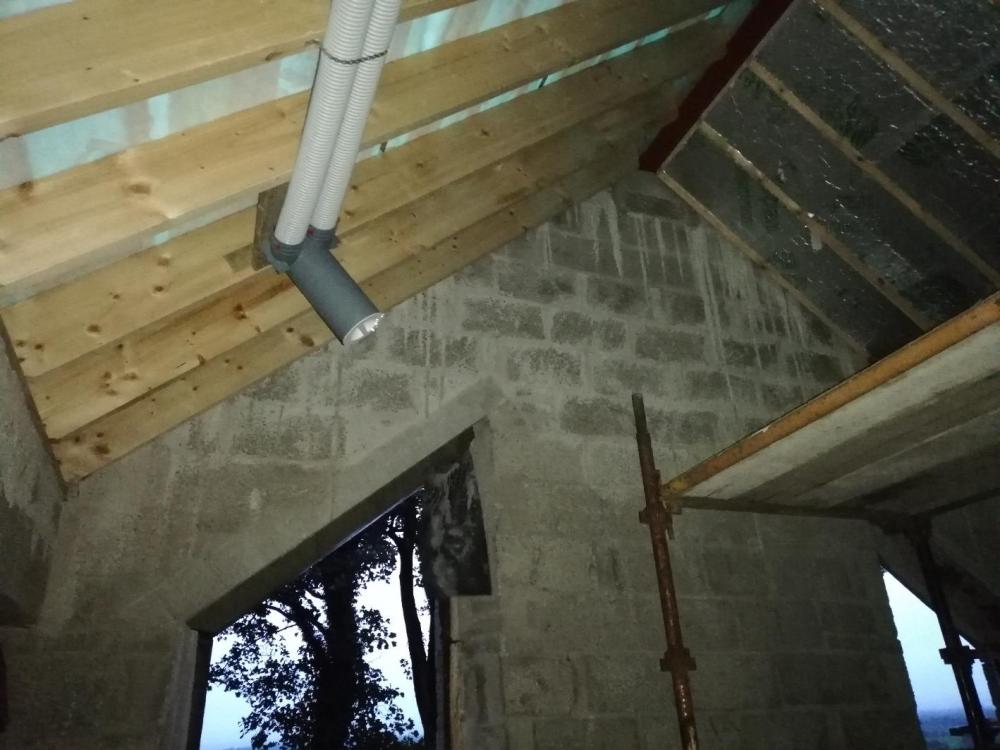

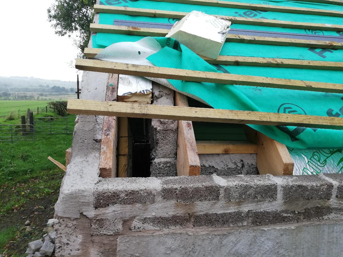

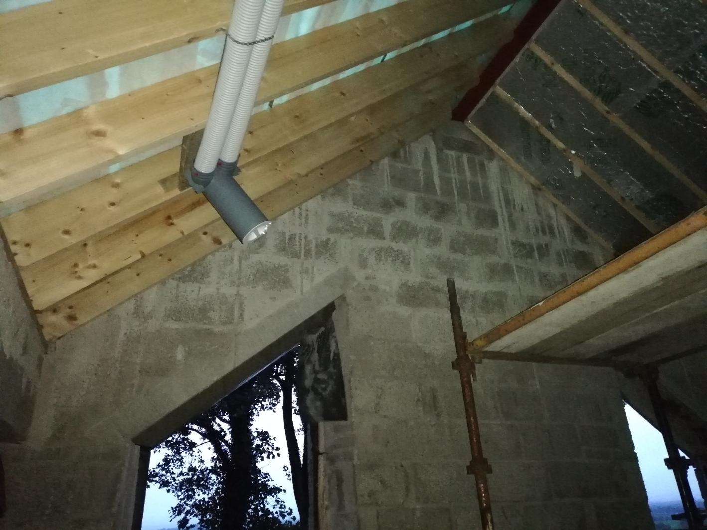

Kicking myself for not spotting this weeks ago... At the gable wall of a vaulted ceiling there should have been insulation connecting the cavity insulation (blown EPS bead) to the roof insulation (125mm PIR between rafters, 60mm PIR below). However, the brickies have continued with the blockwork of the inner leaf right up to the underside of the membrane. I didn't make it particularly clear on the drawings, and somehow didn't spot it earlier so can only blame myself. But what to do now? Slates are on one side, and battens on the other. Seriously considering the feasibility of carefully taking out the rafter on the inside of the inner leaf, removing top 200mm of block, making good the insulation/cavity closure and replacing the rafter. Crazy idea worth trying or should I live with this?

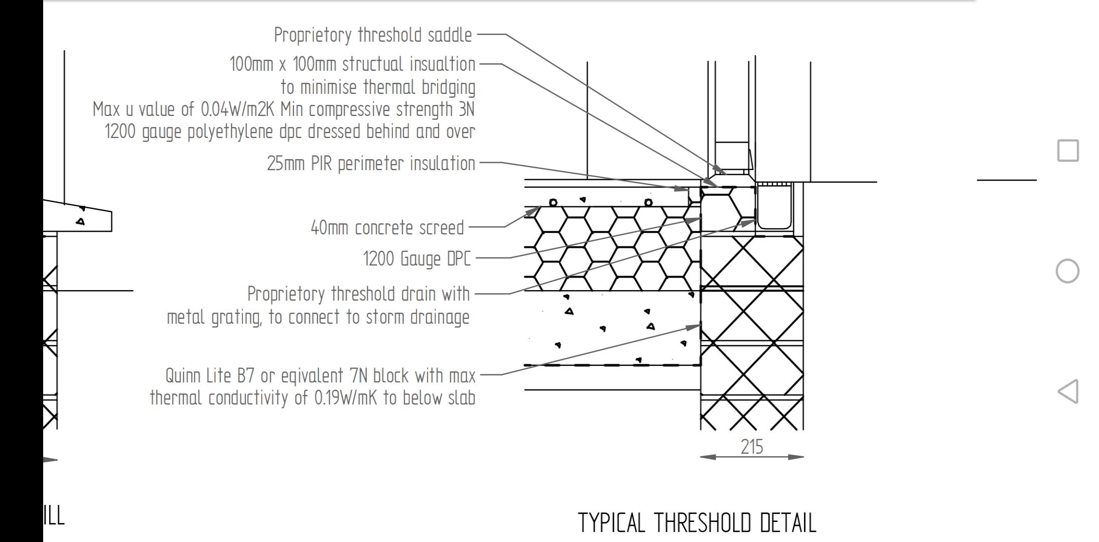

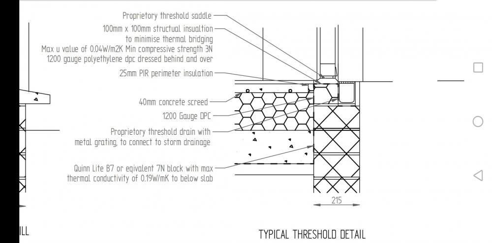

I suspect that perimeter strip would do more good than the Thermalites. Look up the u value's. I would do both. Your XPS detail is same as I had originally specified. I let my builder convince me to drop the cavity tray and blown EPS to the bottom of the cavity. Seemed reasonable at the time, but what I hadn't anticipated was how much the cavities would get filled with dropped mortar. No matter how many times I asked them to be careful... With hindsight a cavity tray would have caught the droppings which the brickies would have had to somehow clean out. Maybe that was their real reason to suggest no XPS and tray...

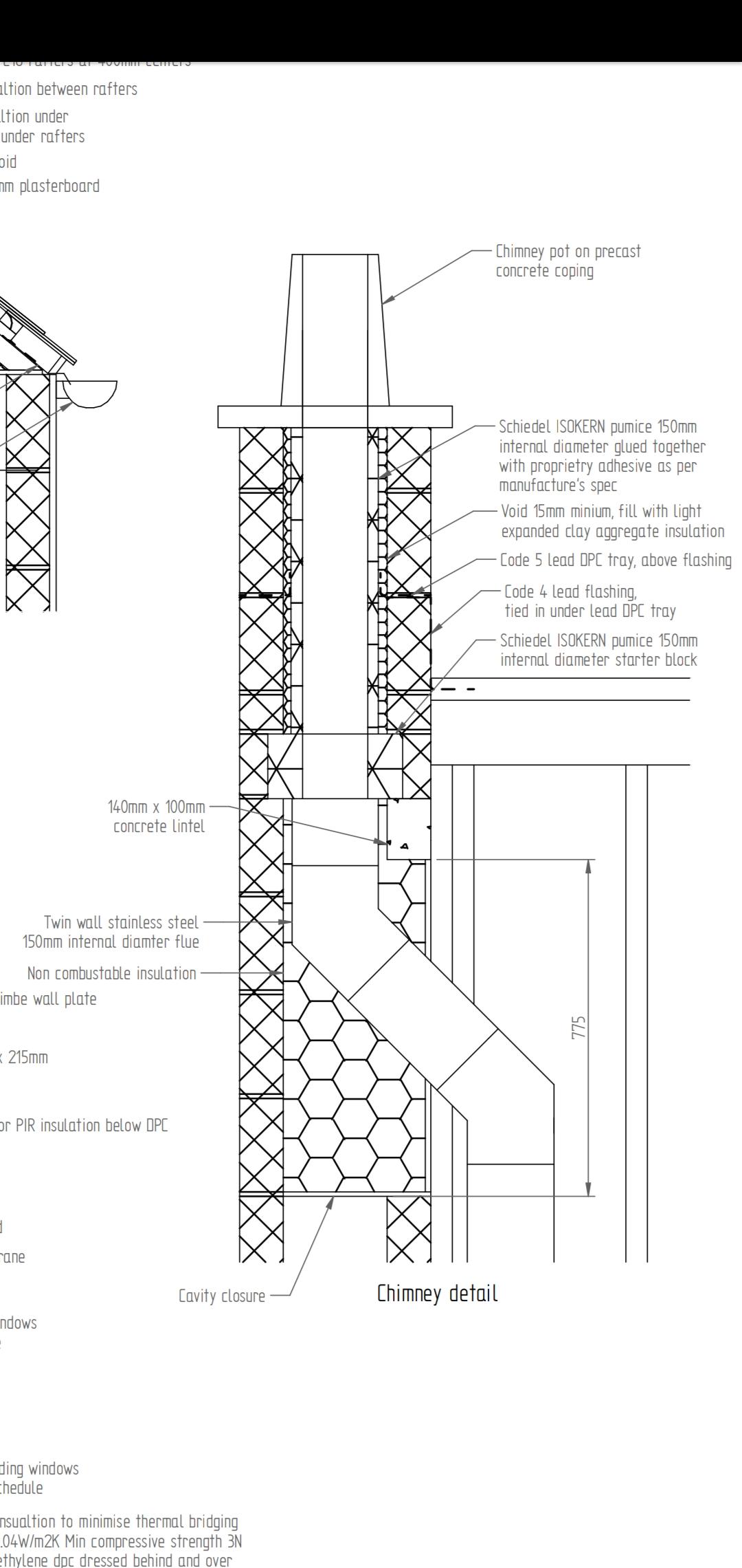

Just to add, the brickie had already built the blockwork and left out the pumice bits (who knows why...). Suggestions was made to fit twin wall stainless flue inside the blockwork, but I'm not convinced this would be a good idea. Poor access and I don't think would meet regs.
Hi folks. This is the intended detail for how the twin wall from wood stove feeds into the more traditional chimney. All signed off by building control. However, builders have suggested bringing the pumice out at 45 Deg into the attic space. Seemed like gd idea to me, easier to attach the twin wall to, or at v least better access. What do we think?

This what I intend. Our cavities only go two courses below the floor level so not really much to build up. The 100mm of structural insulation below the door will be foamglas.
