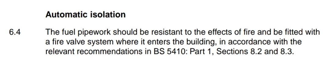

  4. The only relevant part in our local building regs (NI) is this, which implies no need for a fire valve at all if the boiler's outside?
  5. Hi folks, Finally got the oil boiler in position (externally) and the galv housing over it. Pipe run from tank, just need to fit a fire valve. Did a quick 'google' to check what way to install it, and found some recommendations for fitting the valve 1.5m away from the boiler. However that's not particularly handy for me tho as the pipe runs directly across the yard from tank to boiler, and I hardly want any fittings buried... What's the best thing to do here? Thanks.

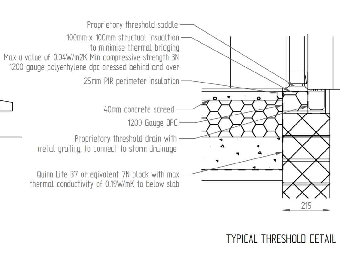

  7. Thanks for the replies folks. Without a good reason not to (still dunno why builder didn't) I went and put in the perimeter insulation. Screed went in yesterday, looks good so far.

  9. This is the detail. Foam glass under the threshold, beside the slab. Floor covering to be tiles or carpet. Should be ok to rest tiles on perimeter insulation, but carpet?
  10. Hi all I had specified 25mm PIR perimeter insulation at the thresholds, but the builders haven't bothered to fit it at the thresholds. The doors sit on 100mm of foamglass, so it's not without insulation. Liquid screed due tomorrow, should I fit the perimeter insulation this eve or leave as is? Screed will be on top of 170mm PIR, and have ufh pipe in. Thanks

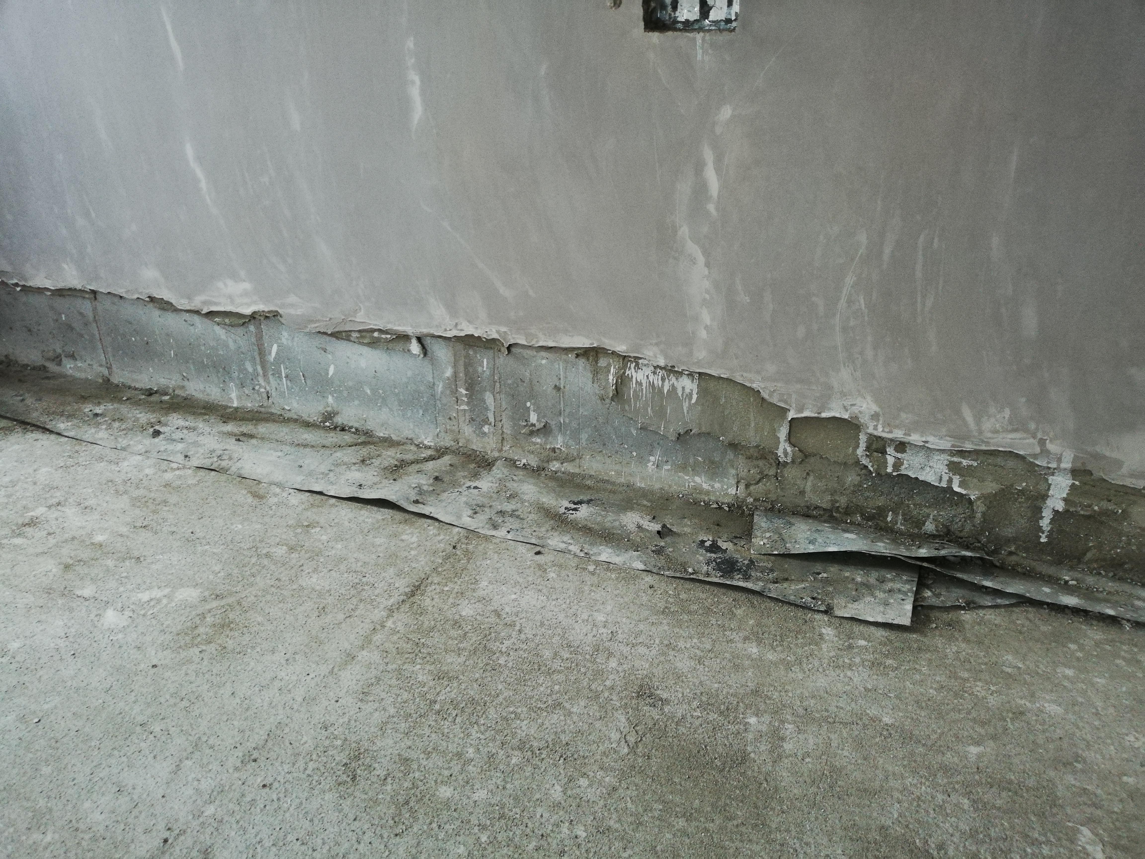

  12. Im thinking I don't much fancy options 1 or 2, parge coating going to be a pain now plastering is done.

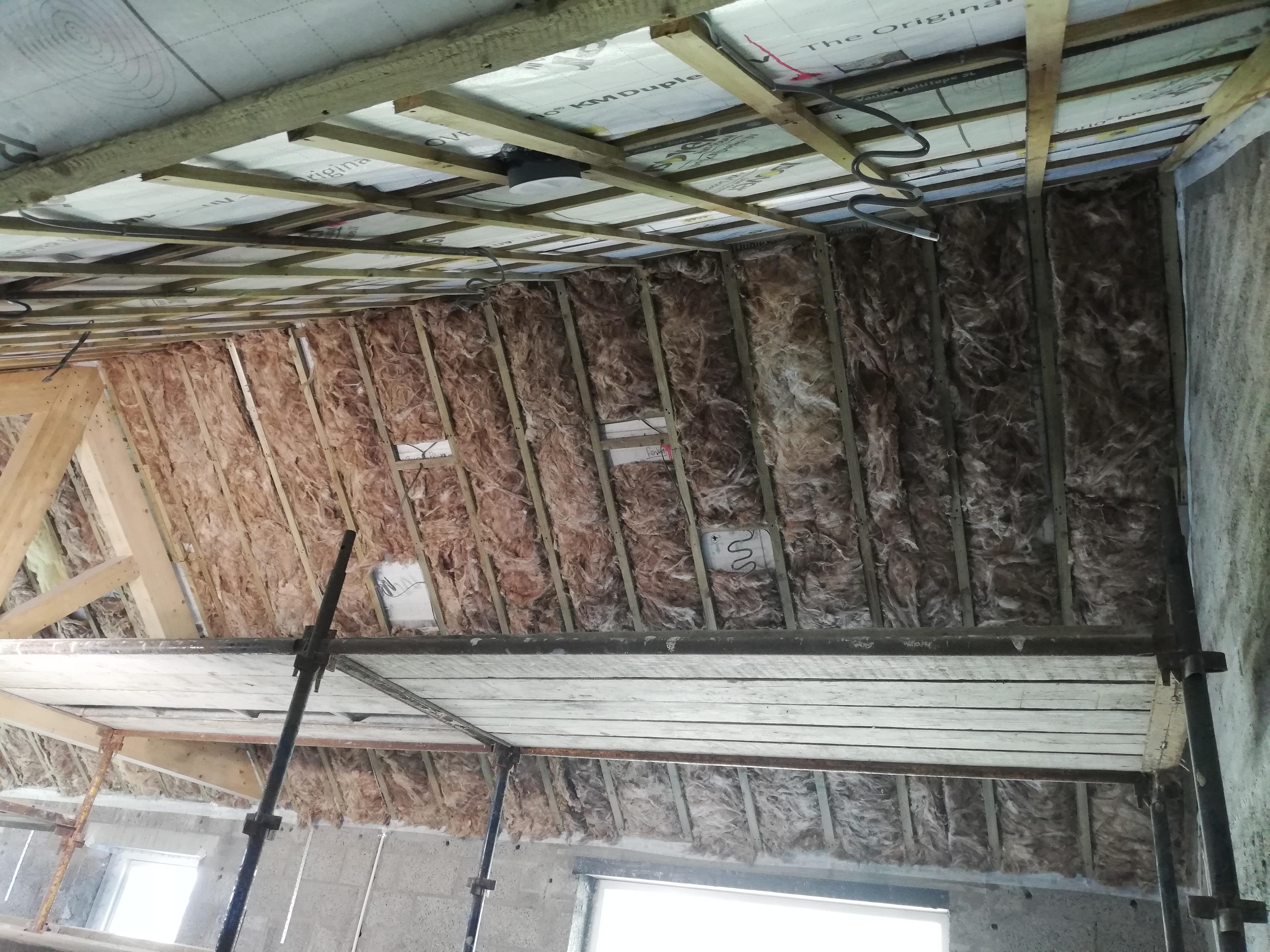

  13. Thanks for the suggestions. After some experimenting i found that staples to the horizontal battens and a little tucking in under the vertical ones worked well enough. Two evenings work to do both sides, about 70m2.
  14. As the plasterers are nearly finished I need to finally figure out how to seal the walls to the floor. Cavity block walls, slab is down and we'll soon put the pir on it then dpm, then 50mm liquid screed with ufh. There's a dpc at the top of the slab level. Options as I see it: 1. Page coat from bottom of plaster (which is at top of screed level) down to slab, as one course of block is exposed. 2. As 1. but also additional seal to slab, with either airtight paint or tape. (Straddles dpc) 3. Wait until screed is down then seal onto it. Would be with tape as need to straddle the 25mm PIR upstand. 4. Something else...

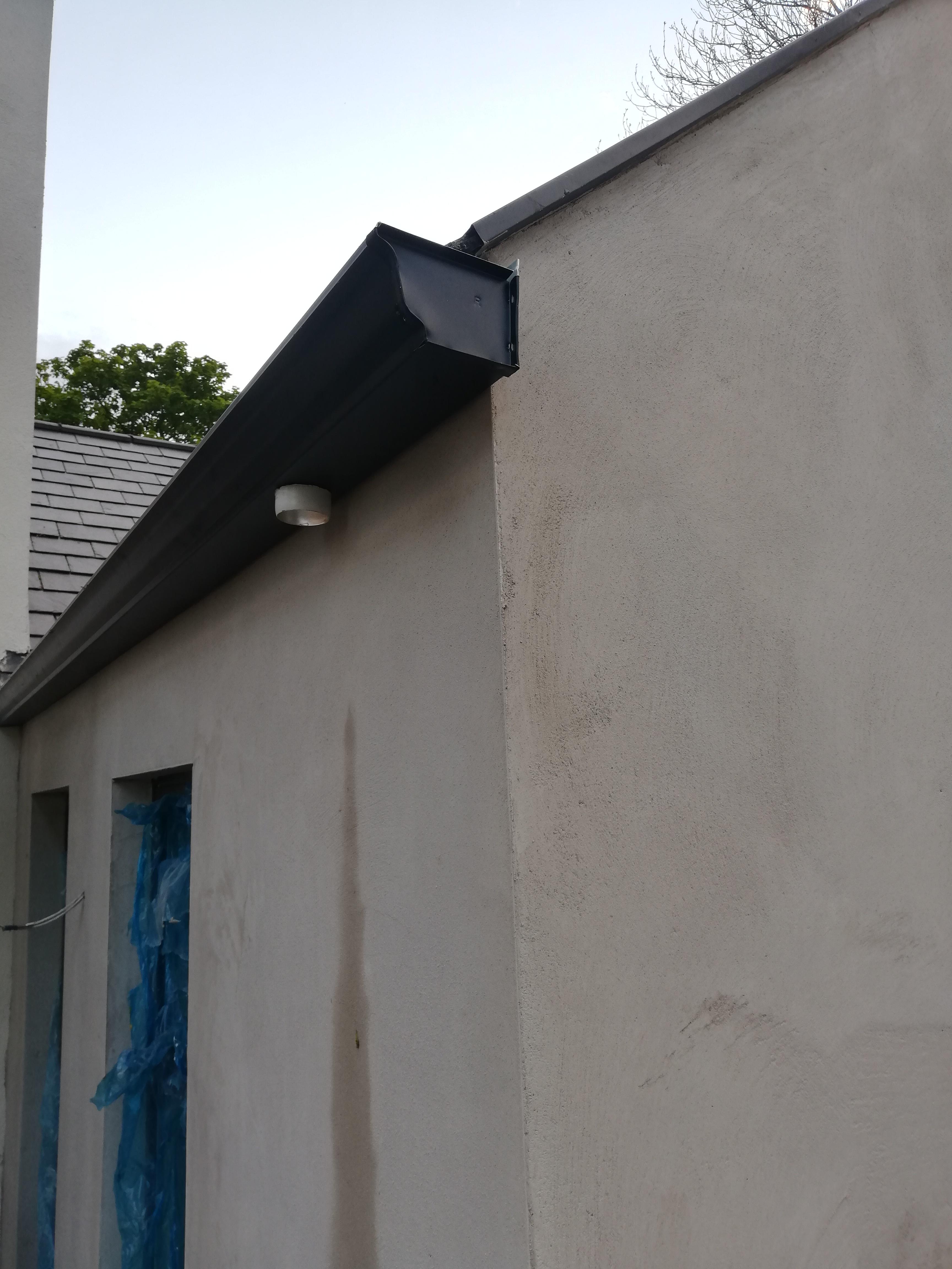

  19. Some guttering appeared on our build today, despite the rendering not being finished. Is that normal/ok? There are two coats of base layer on but still to have the final Weber thin (top) coat applied.

  24. Or you could ask the SE if heavier sections could be used to avoid bolting them together. Would of course be more expensive, if even possible/ feasible. My SE originally spec'd a single very heavy beam with a flat plate welded on top for a 5.6m opening. I asked for there to be two separate beams which he did. Interestingly he then spec'd two heavy UC's, I asked him why not a deeper and lighter UB, he said because of torsional buckling. No harm in asking.

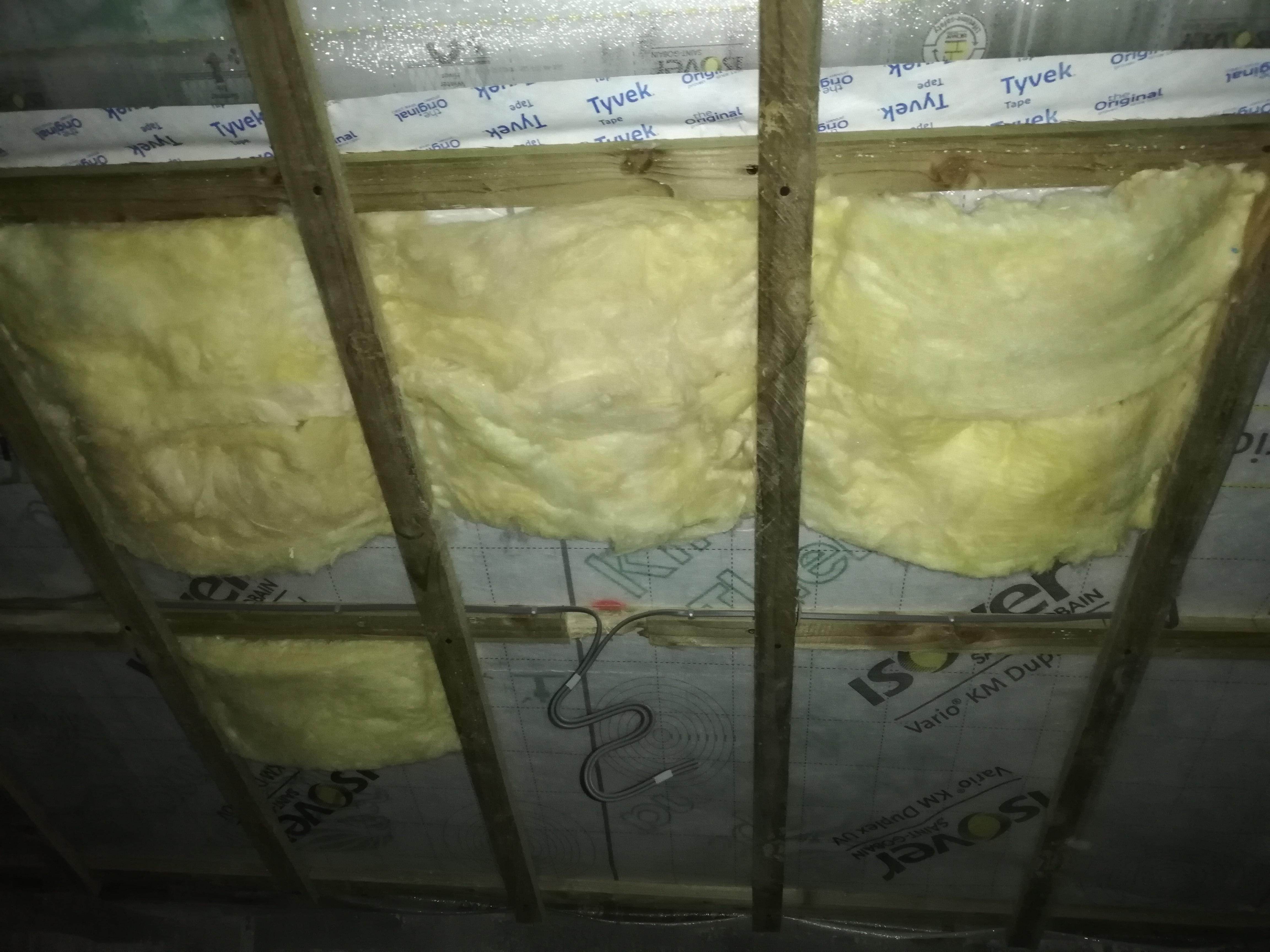

  25. Despite achieving my desired u value with PIR between and under the rafters, thought I may as well fill the service void with something on our vaulted ceiling. Got some glass wool stuff, works out about £1.5/m2. I'll just stuff some in, or so I thought... Problem is its a real pita to stop it falling, not helped by the rolls being partially pre cut into narrow stripes. Gonna try staples tomorrow, need a faster way to secure it as there's a big enough area to do.
