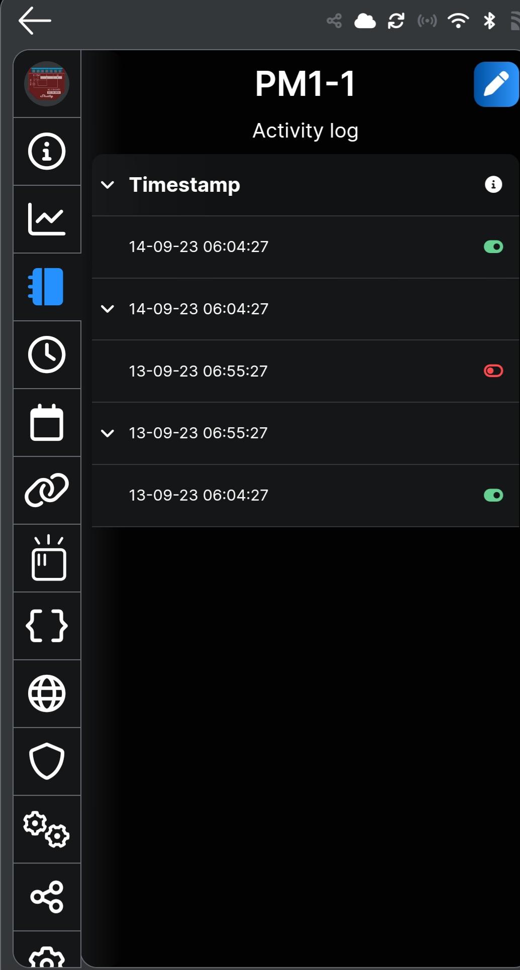

Hi folks, anyone any idea on whether there is a way to download all of the on/off events? I can only find the past day's.

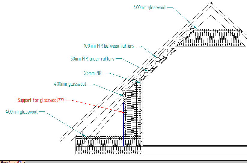

Hi Folks The time has come to think about how we convert and insulate our attic. I have lots of glasswool, and not much money so want to use the glasswool as far as possible. My concern is whether the insulation will sag over time, and if it needs support where the blue line is. Possibly 9 or 11mm OSB, chicken wire or 25x50mm battens at 400mm centers?

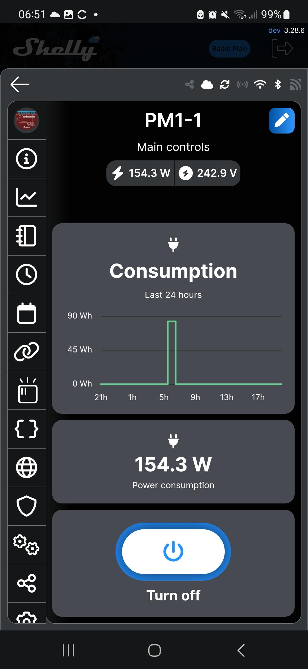

Thanks for all suggestions. I am now the proud owner of a Shelly 1PM. Up and running, it's a nice device, I can see me getting a few more for various other projects. The way it's wired in, both the pump and boiler are being monitored. I can't seem to get a good resolution on the data to differentiate between them, ie it just gives total power consumption for a period. Guess a little rewiring will be necessary unless there is a way to get it to record on a shorter time base? I've also noted that the on/off times are only displayed for the past day, are these stored and accessible somehow?

Thanks for the replies folks. Raspberry pi- id like to experiment with maybe someday, but not right now, still too much pressure to finish off the house I hand wondered about a power meter, would be nice to log (to check for any short cycling) but not essential. I like the Shelly option, will explore that more. And check out Tado as well.
Hi folks I am trying to find a simple (and cheap) way of logging how how much my oil boiler is on. I thought there might be some simple devices available (I've used Elitech for temp data logging, that sort of thing) but am struggling to find something that will record either voltage or current. I'm don't have the time right now to learn how to program the likes of arduino or raspberrypi's. Any suggestions? Thanks

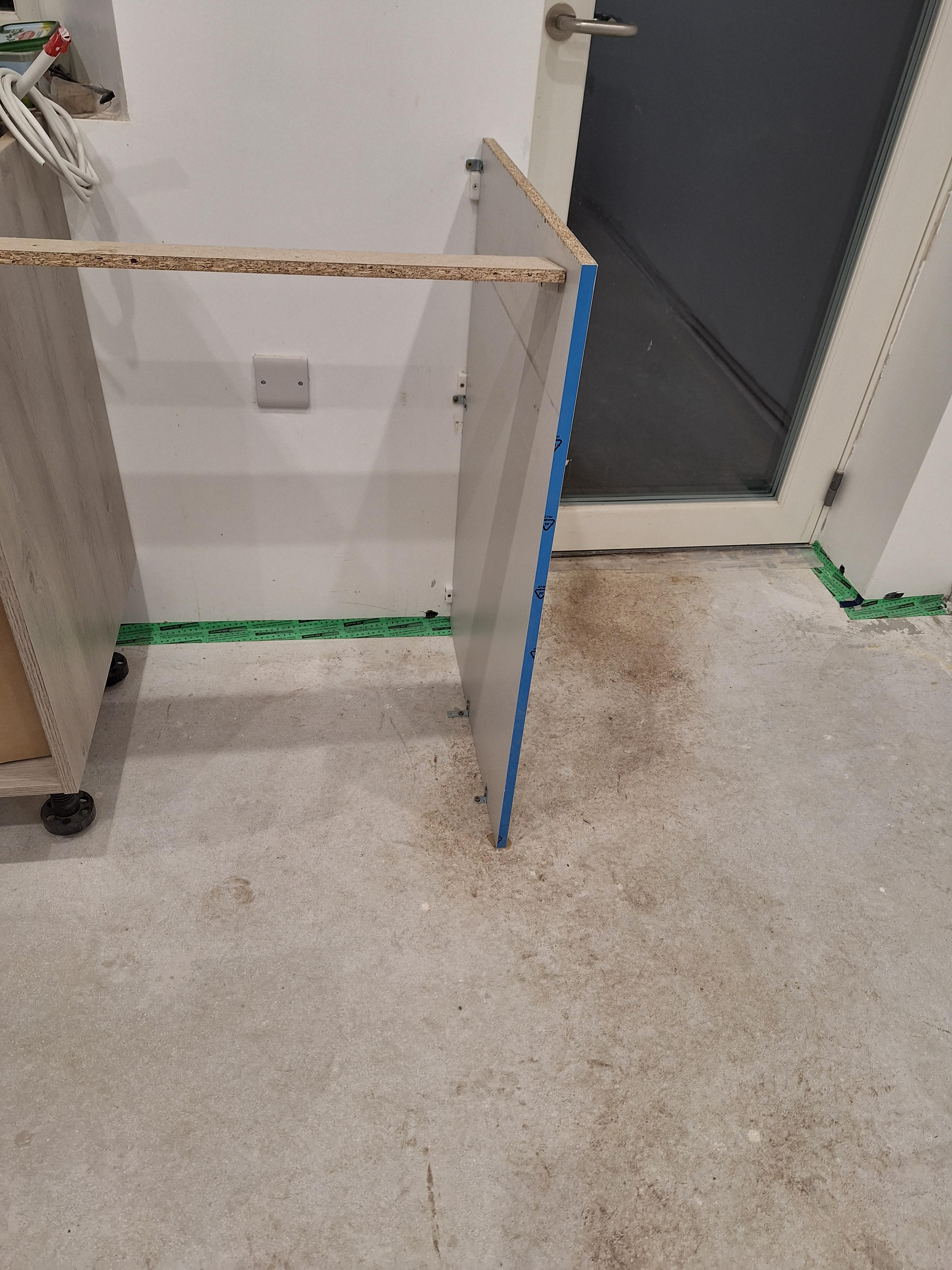

Thanks for the replies and advice. There will be cupboard units above and below which largely dictate 600mm, unless I'd shimmed them out. They are now fitted at 600mm. There'll be a vertical board between the two so each appliance will be supported independently on 600mm wide boards with some 50mm angle iron underneath. Power is by two trailing leads, switched from an accessible point. I'll post some photos at some stage.
Free standing. The existing washing machine is 595mm, but it will in due course get replaced.
Hi all, I'm about to start fitting some units in the utility which includes gaps for the washer and dryer (neither purchased yet). Nominally 600mm wide, but is that the normal gap to allow? They will be raised up with drawers cupboards above so will be easiest to make the gap exactly 600mm. Or is that a bit tight? Thanks
