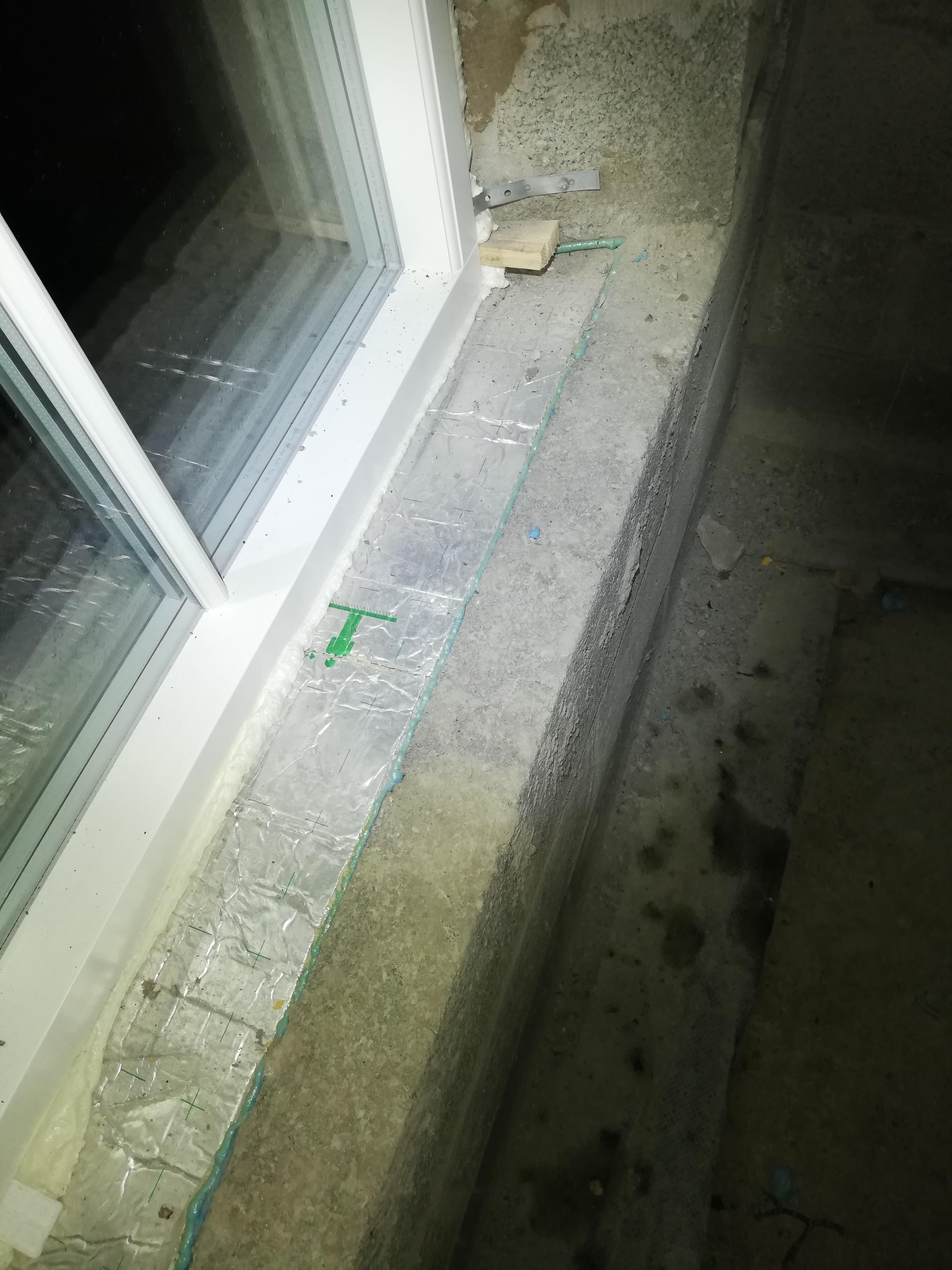

Thanks for the replies. Yes wet plaster. I can hardly remember the full rational behind the ply board, probably to give a solid and airtight base for final boards, which allow me more options in the future. And allows tape on frame to be hidden by final board. Either way it's option 1. as builders have now fitted the boards, lucky enough I was veering towards that anyway. Next question is now the under the headers which have similar detail with the PIR closures. I'm thinking of a 200mm wide tape over the PIR then plasterboard then skimmed.

Hi folks Windows are in and now debating how to tape them to the blockwork at the sills. There is to be a ply board fitted, then an aesthetic windowsill board at a later stage. The cavity closure is 100mm thick PIR, width 130mm from frame to inner block skin. Options include: 1. Tape frame to ply, and other 3 sides of ply to blocks 2. Tape membrane to frames and to block work. Need to bring down inside of inner wall. Would need to penetrate for fitting the ply which would be fitted on top of membrane 3. Tape frame to pir, and PIR to blocks. Need to scratch coat top of blocks. 4. Wide tape (200mm) to bridge pir. Also need to scratch coat top of block's. 5. Something else...
