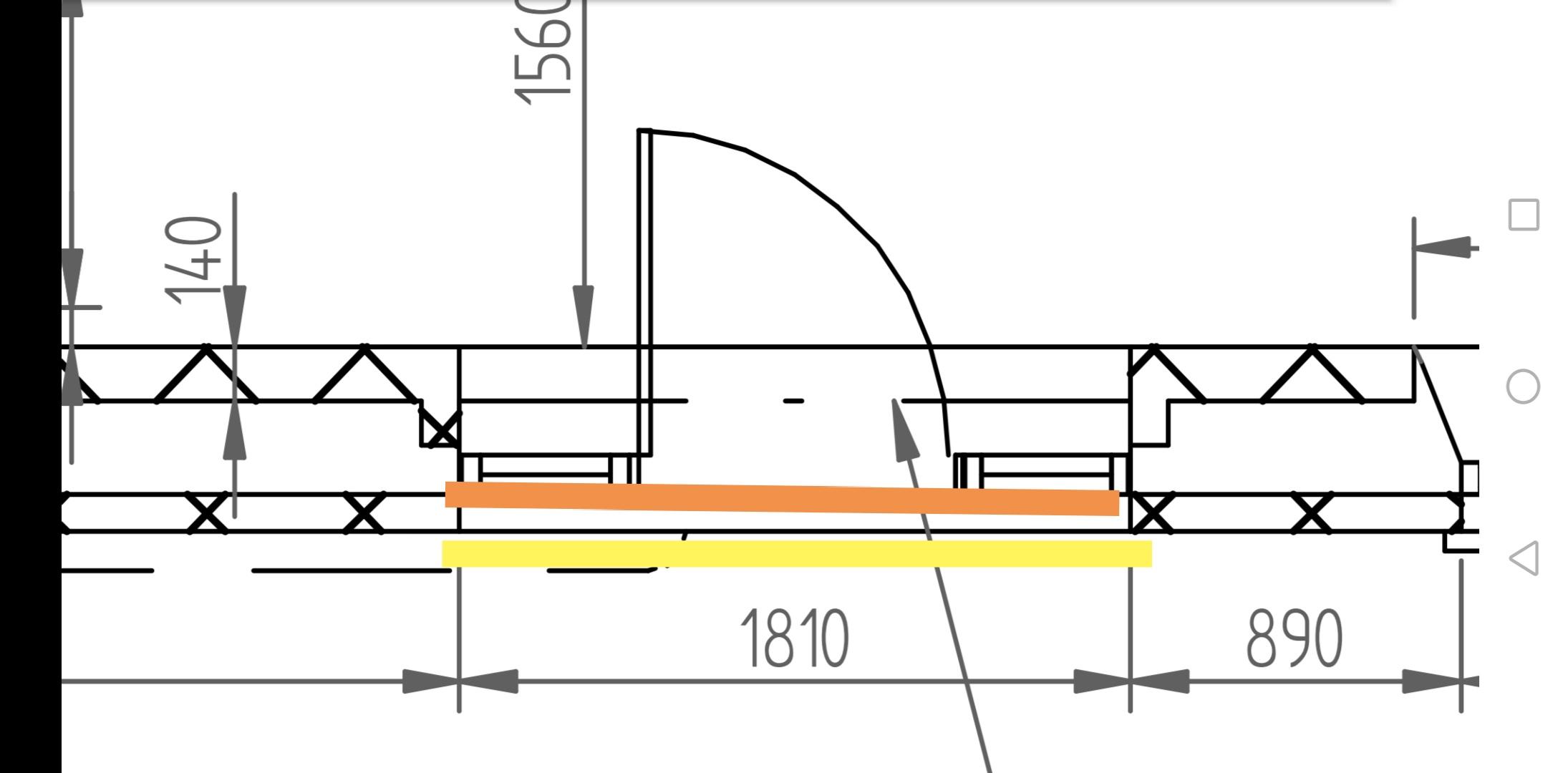

  9. Thanks for the reply. I'm also wondering if the drain should be fitted tight to the threshold (orange line in sketch) or more in line with the outside wall (yellow line in sketch)? My initial preference is the former, but there's examples of both on t'internet.

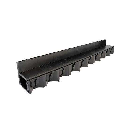

  10. Hi folks. I'm considering fitting these type of slotted threshold drains at some of my external doors. Slightly concerned though as to how they could be cleared if blocked up. I like the idea of having easy access. Is there some clever way the slotted bit lifts out or something, or is it just a case of hosing out? Thanks

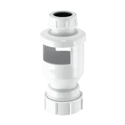

  12. Am i as well just buying a tundish with a 32mm outlet? Eg
  13. Yep. 22mm in and 28mm out. The relief valve is 22mm.
  14. Hi folks Any recommendations on how to connect 28mm copper pipe to 32mm waste pipe? The outlet of my tundish supplied with the UVC is 28mm so need to get that to polypropylene pipe. Thanks
