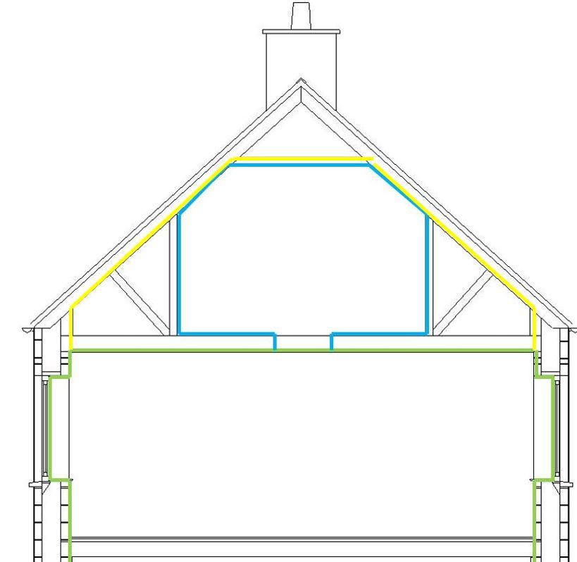

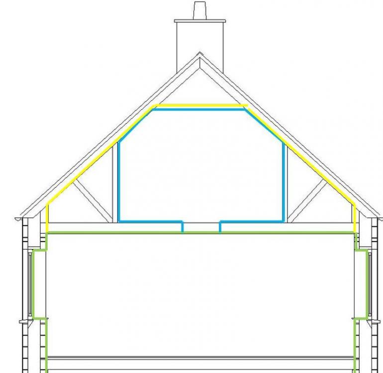

  1. Certainly sounds tedious to get a gd airtight layer... Would a sprayed in foam insulation along the yellow line help, either in addition to a membrane or work on its own?
  2. So, would a silver sand/snowcrete/lime render need any maintenance or re-coating?
  3. Yes did consider that, would be good for now may not help that much if/when we convert the attic space. If the air tight layer ultimately followed the yellow line in the sketch below, it would be ideal for services etc, but probably a real pain to get round the rafters... Lots of taping to rough swan wood presumably. Would that even work?

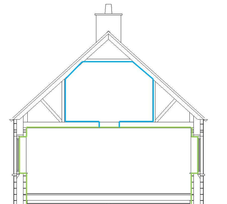

  4. Hi folks I'm debating if I am going about the air tightness at my first floor ceiling the best way. We are to have attic trusses to allow future conversion of the space in the attic, and the build is to have a high level of air tightness. The provisional plan was to have the air tight layer in the first floor ceiling (shown in green below), and use air tight light fittings . Future conversion would then have the air tight layer follow the blue line in the sketch. Seems a bit convoluted though, and possibly not the best approach? Any thoughts on what best to do? Thanks Chris

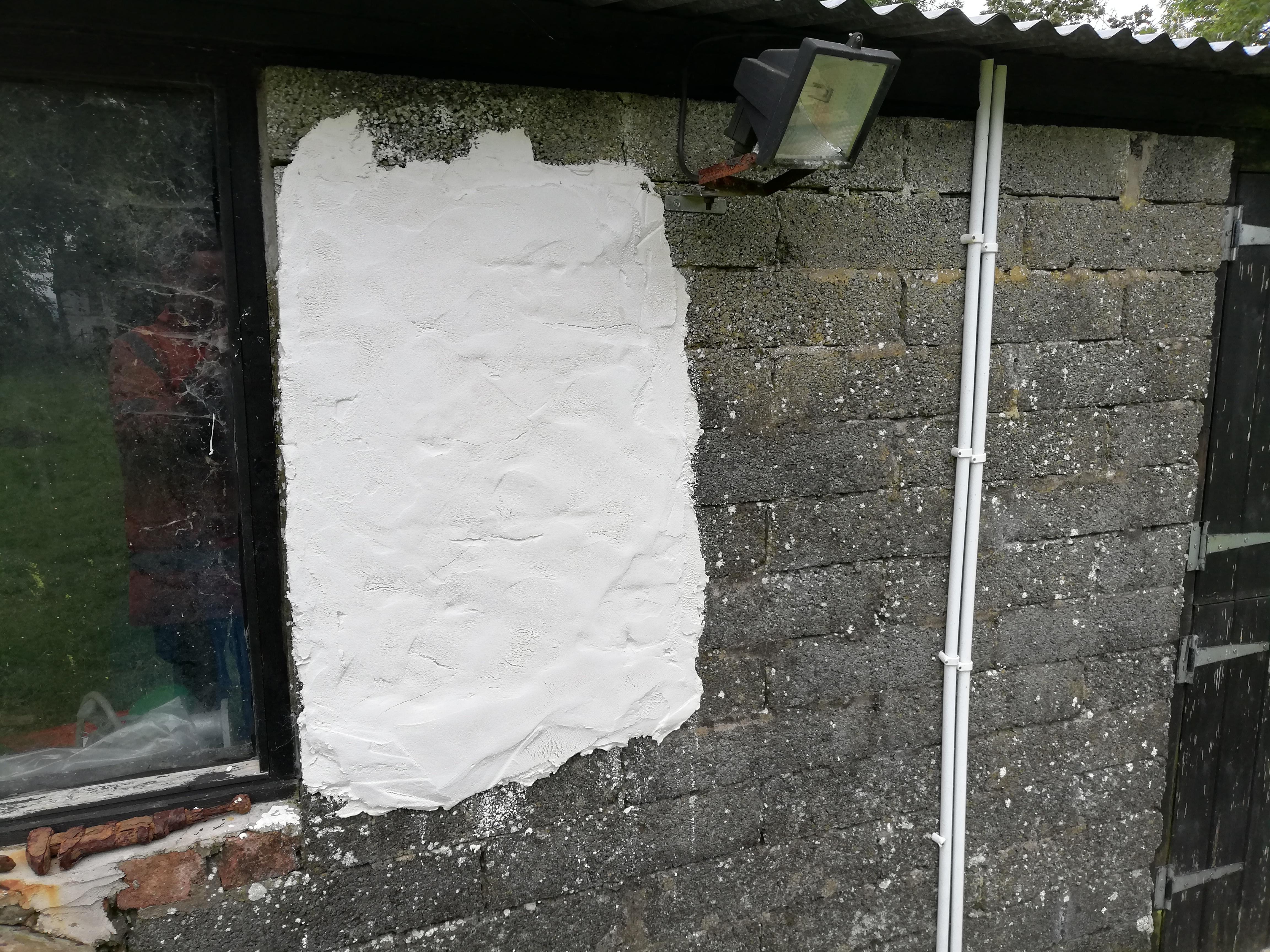

  5. Intrigued with the responses above, I got some silver sand, snowcrete and lime and did some experimenting on an old shed. 5:1:1 mix. Reasonably happy with this. With hindsight I should have put some effort into to applying it smoothly rather than rushidly throwing it on, as I think it would look better with a smooth surface finish.
