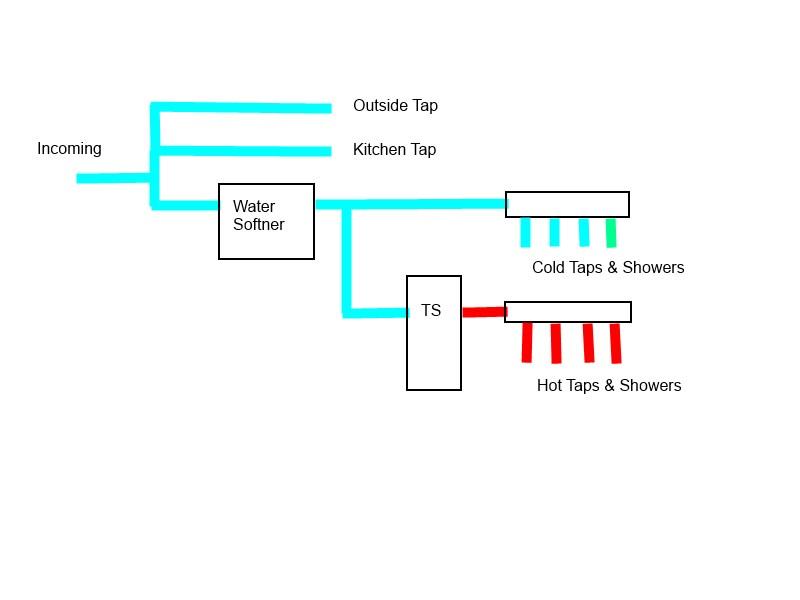

  9. We have a bit of a mixed system. Everything to the left of the Thermal store is downstairs. The Store and manifolds are upstairs. The manifolds are located between the two bathrooms which are close together. So I think any extra pipe due to the use of a manifold approach was minimal. It's a mix of copper and plastic. Mostly 28mm copper before the manifolds and plastic in various sizes after. The manifolds were "home made" from 28mm copper fittings. The diagram is simplified (I've not shown the boiler loop, isolating valves and the Thermal Store is much more complicated). The water softener is just a place holder with bypass as we haven't needed one. One of our showers is a high flow rate with body jets. Works well.
