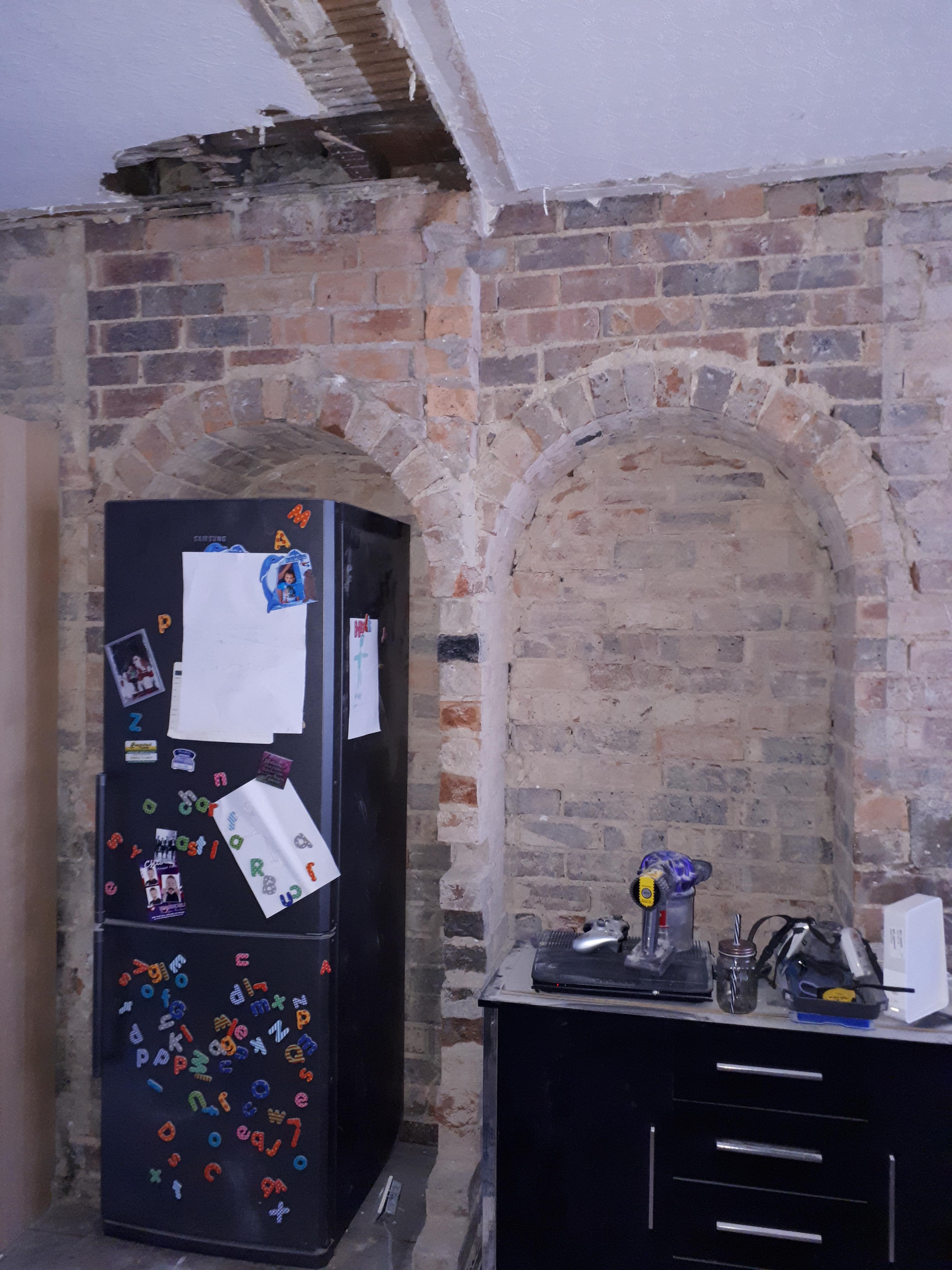

  2. Hi. We have now completed our extension and have moved on to the existing 1930s build house. We have knocked out the wall between living and dining room (No rsj required as it's not carrying joists) but as you can see from the pictures we are unsure what to do with the 2 beautiful arches we are left with. In a perfect world we could knock the centre out and have 1 big arch as a feature but we are unsure weather the wall between carries the chimney in the room above the left arch (no chimney in room above right arch). Has anyone seen this before? After completing the extension funds are low and another structural engineer and RSJs are out of the question.
  3. Thank you Bassanclan, that's exactly what we were told by the builder - you have put my mind at rest -thank you

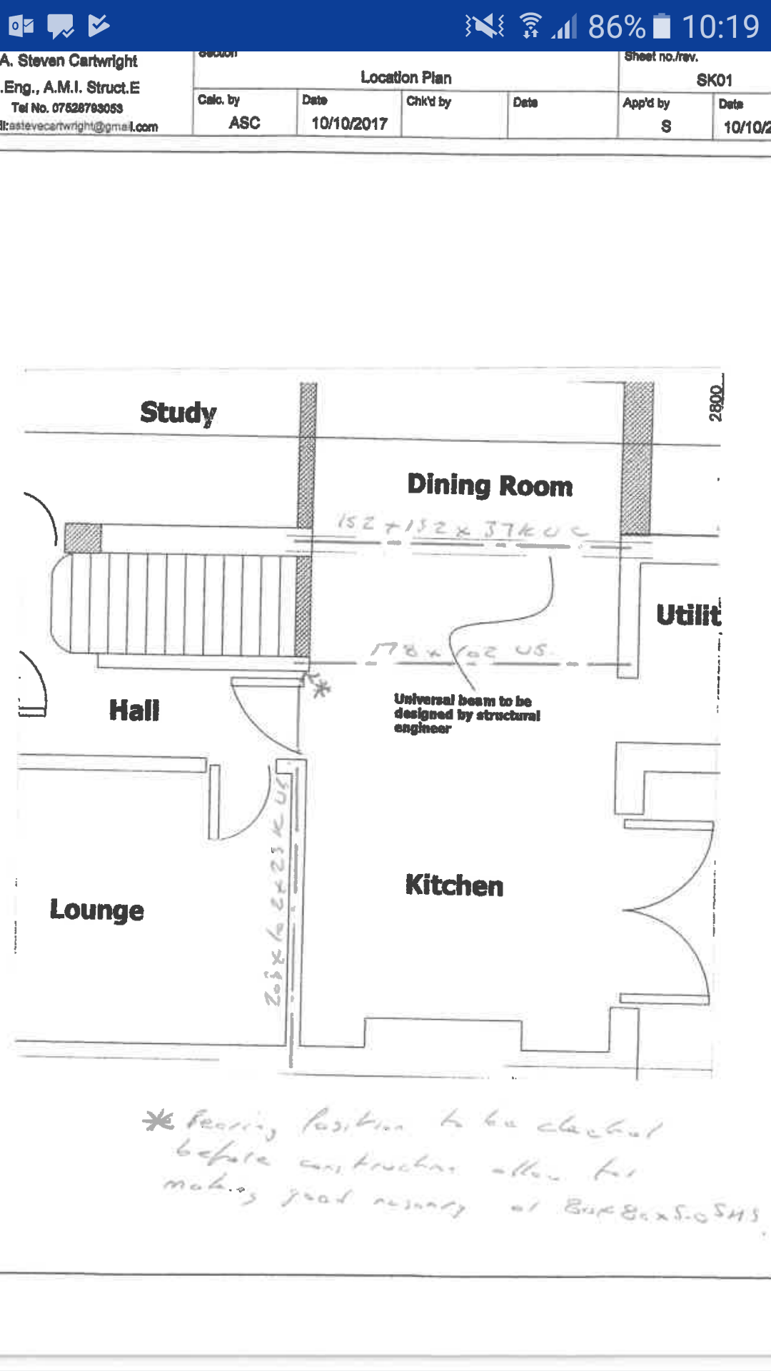

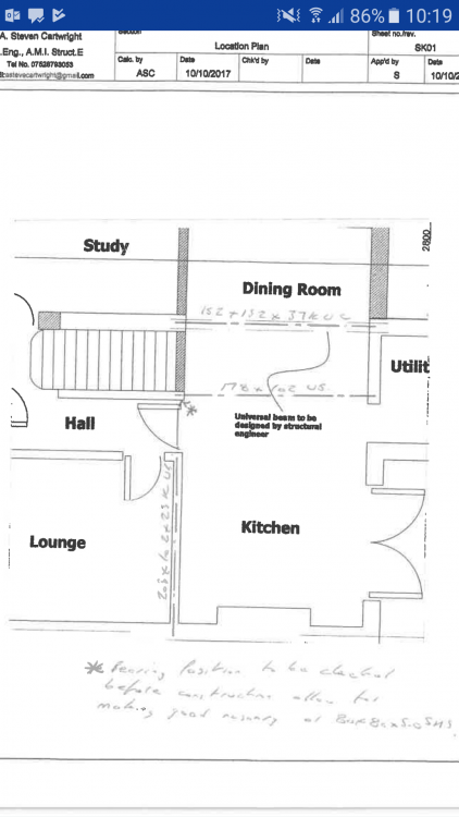

  8. No, directly above it is floor only then about a metre away there is a stud wall, but the SE has calculated for a steel? This is why I'm confused - I would hope the SE knows what he was talking about but I'm beginning to think otherwise.
  9. Thank you Ian that does make sense now. Do you have any advice as to whether we need to have steel put in the wall which runs the same way as the joists and not load bearing? Again SE says yes but builder is adamant no.
  10. Hello. We are currently self managing our 2 storey house extension (1930s semi). We have had calculations done for the steel by a structural engineer but the builder thinks that the calculations are wrong. To me they are a bunch of numbers and I really don't have a clue what it means. Basically we are knocking down 2 internal walls. 1 is in the same direction of the joists and has no wall directly above it. 1 is load bearing. Then we have the external wall where the SE has said we only need 1 steel beam butting in even though it's a double skim wall. Both architect and builder say we need 2 on this wall. I feel as though we've paid £250 for SE and he's a bit offended that we've questioned it but I don't know who to trust? Any advice welcome please.
