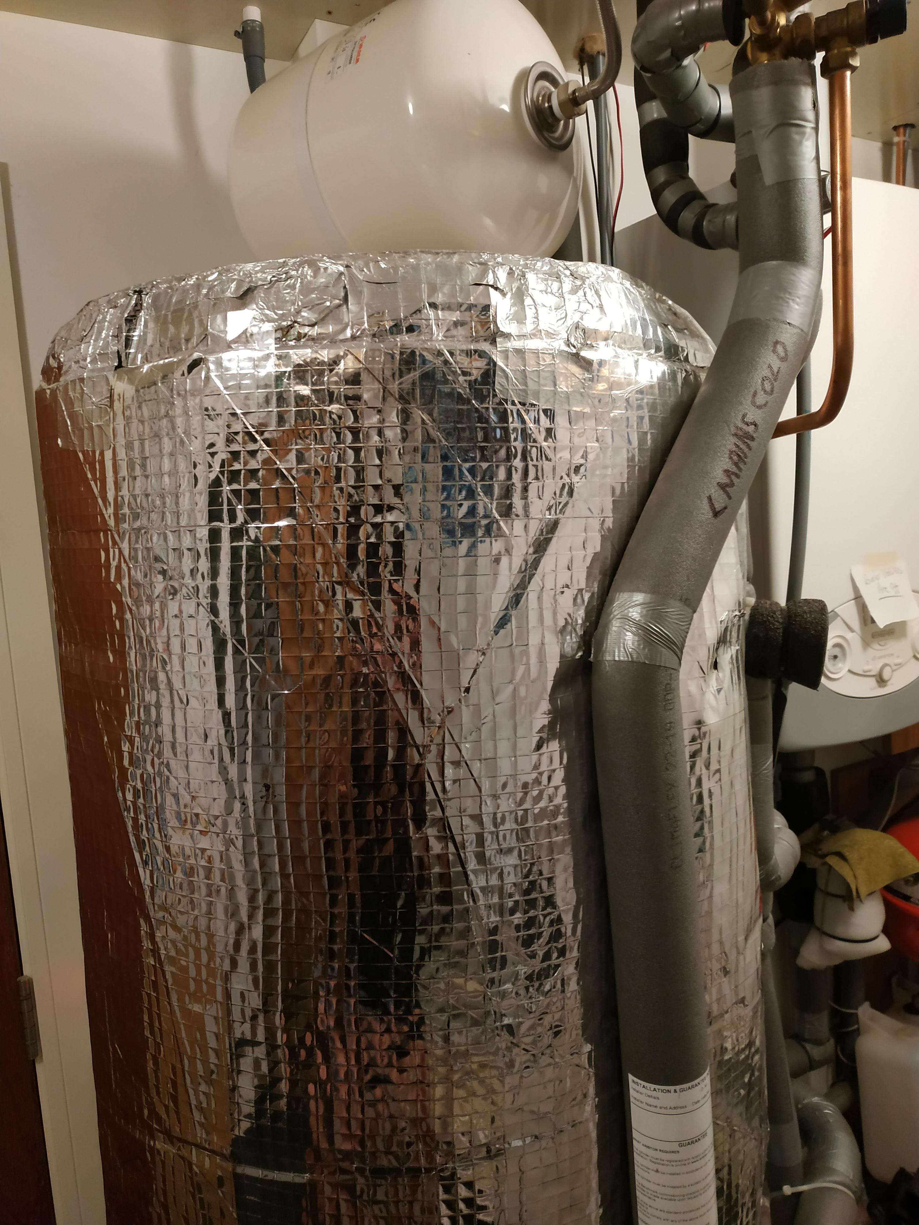

I have Ariston Evo system 18kw rated down to about 8kw it runs dual temperatures the rads at between 36 to 46 degree C depending on weather compensation and room stat, hot water for unvented cylinder is set to 56 degree C. All components controllled by Ariston Sensys I installed this system in 2012 Self build and have not touched it other than cleaning condense trap and a yearly gas safe check!
ACTIS FOIL TAPE ALTERNATIVES??
JOE187 replied to Arnold9801's topic in General Self Build & DIY Discussion
Have a look at reinforced foil tapes with acrylic adhesive. STERR and AT501 are good brands stick well and dont tear! -
