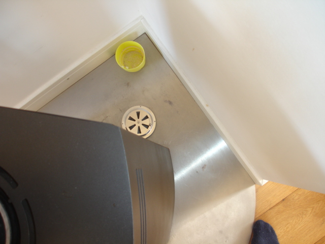

  12. I put a small 5kw burner in my own house and used 100mm air supply duct in floor with adjustable stainless grill and a bung to completely seal when not needed as photo below. I do have MHVR and a supply and extract approx 6m apart in this room. The fire burns really well with grill open and air supply is silent when Bung is in place!
