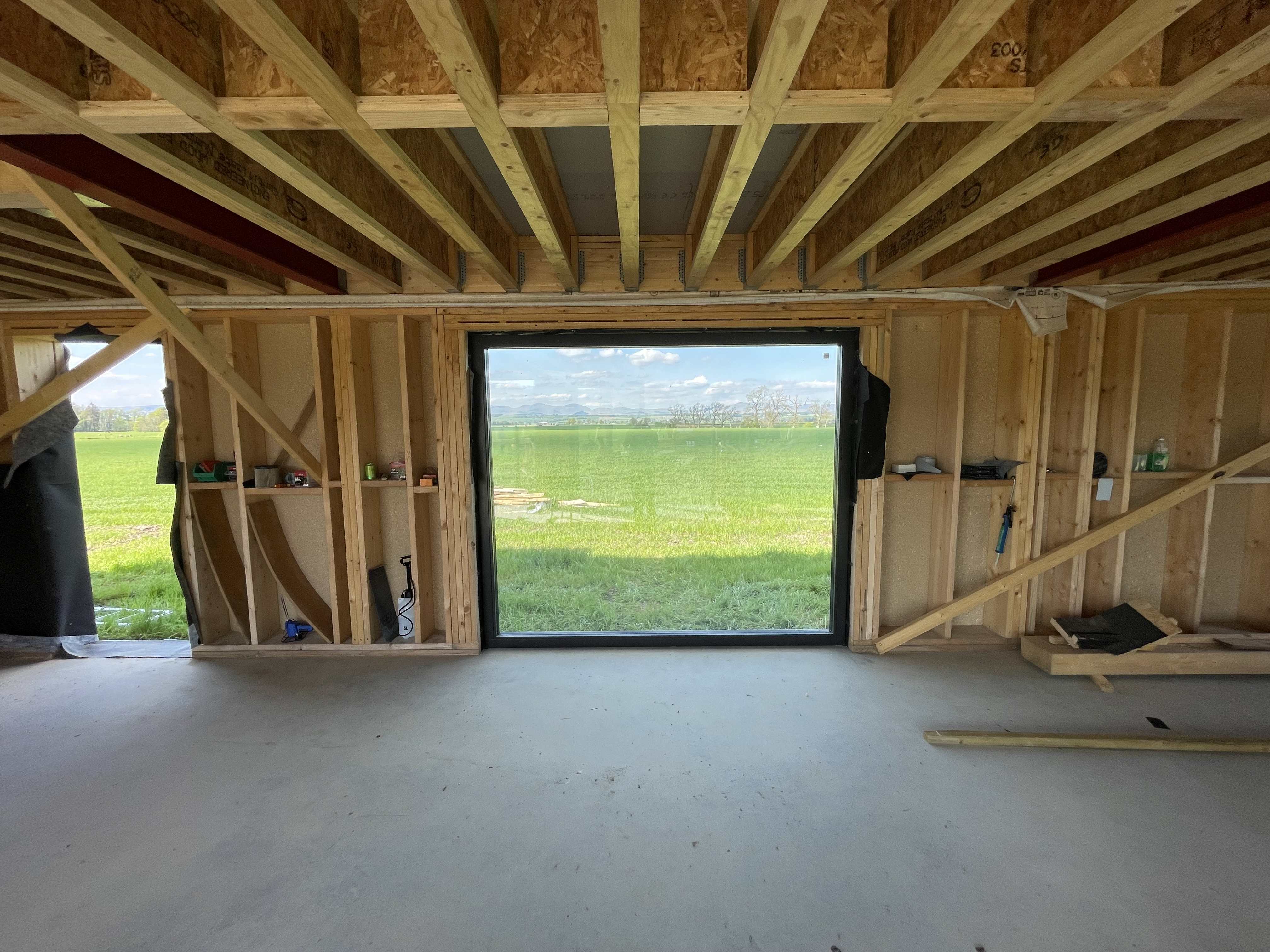

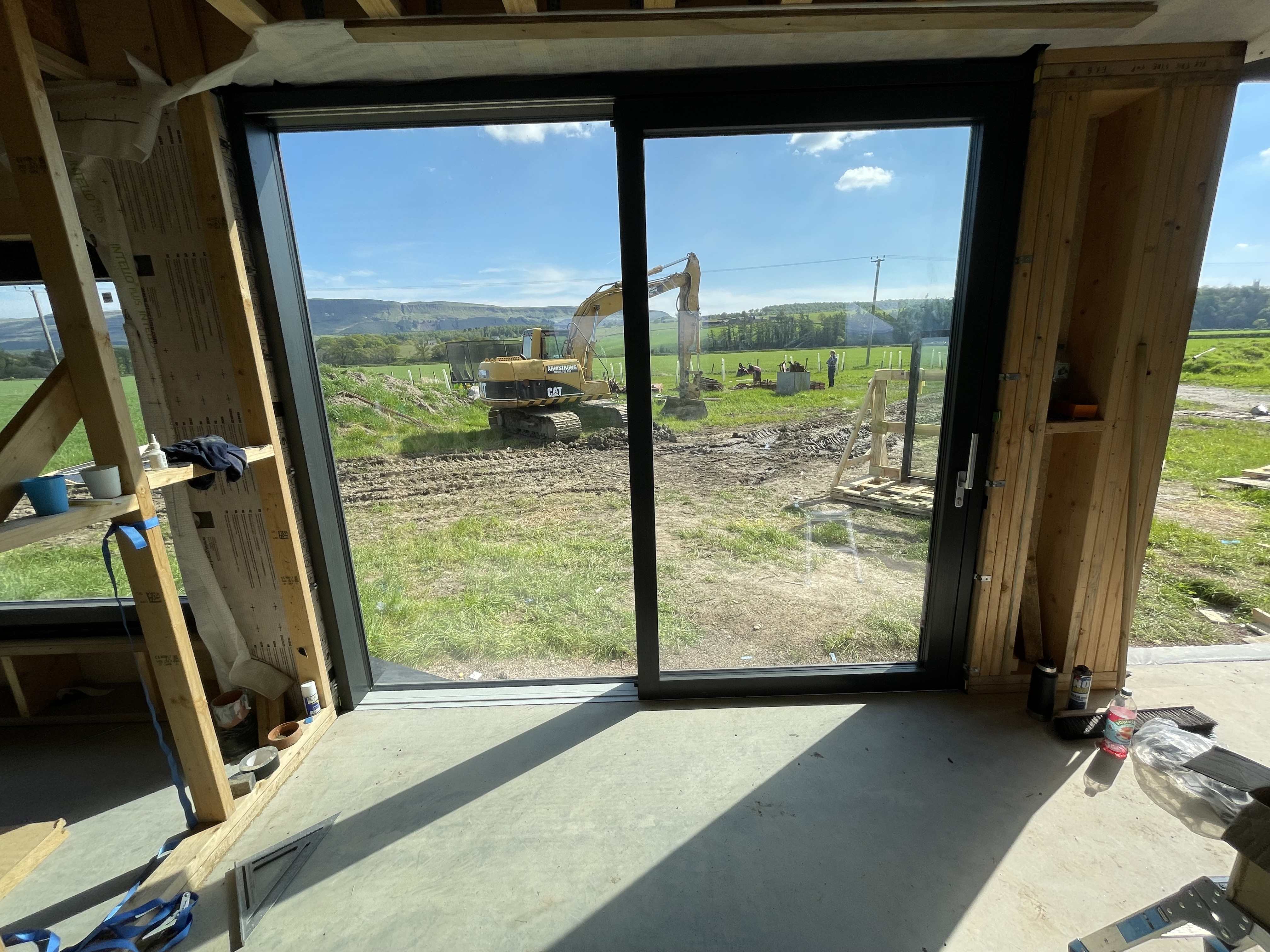

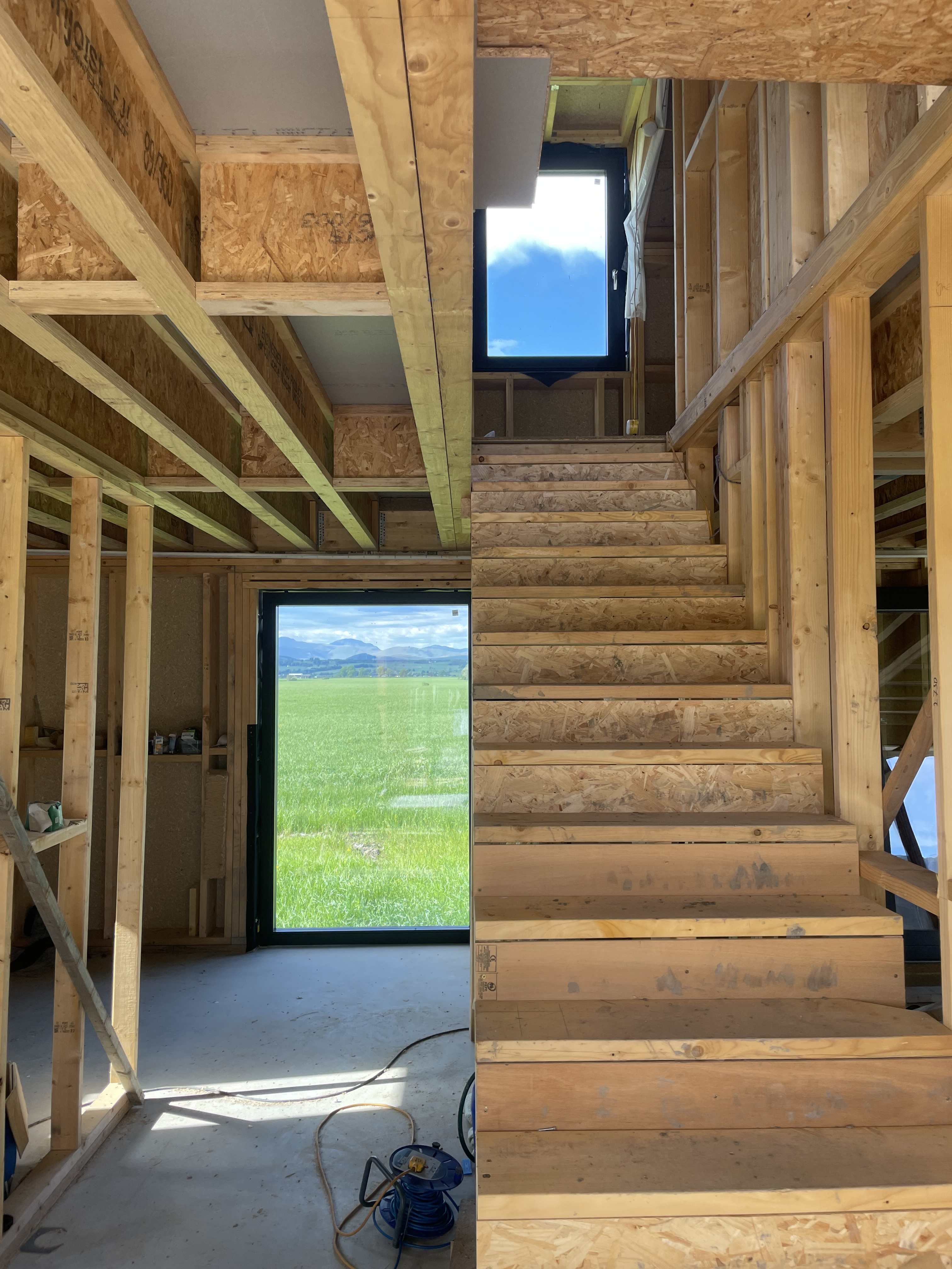

  5. I’ve got 3 kids. 5,3 and 5 months old. We live in a flat we own about 1 mile from site. It’s about 70m2. The kids are driving us insane with the constant fighting and screaming. Our down stairs neighbour has had enough of our noise and this is stressing out my partner. There are no properties to rent nearby and my partner is desperate to get out of the flat. I phoned our self build insurance to ask if we were sleeping inside our self build would it invalidate the insurance and to my surprise he said no. It would cover the building but not the contents. so there is a possibility to move into a building site with three young children or some sort of hybrid living between the flat and build that will take the pressure of our neighbour. trouble is I’m missing 4 external doors and 4 windows. There is no cladding, and the inside is basically just stud work. I need some sort of plan to be out of this flat by christmas

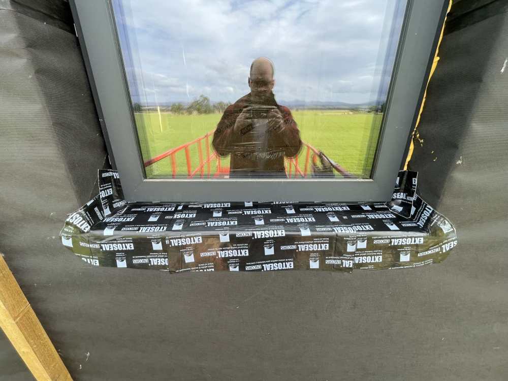

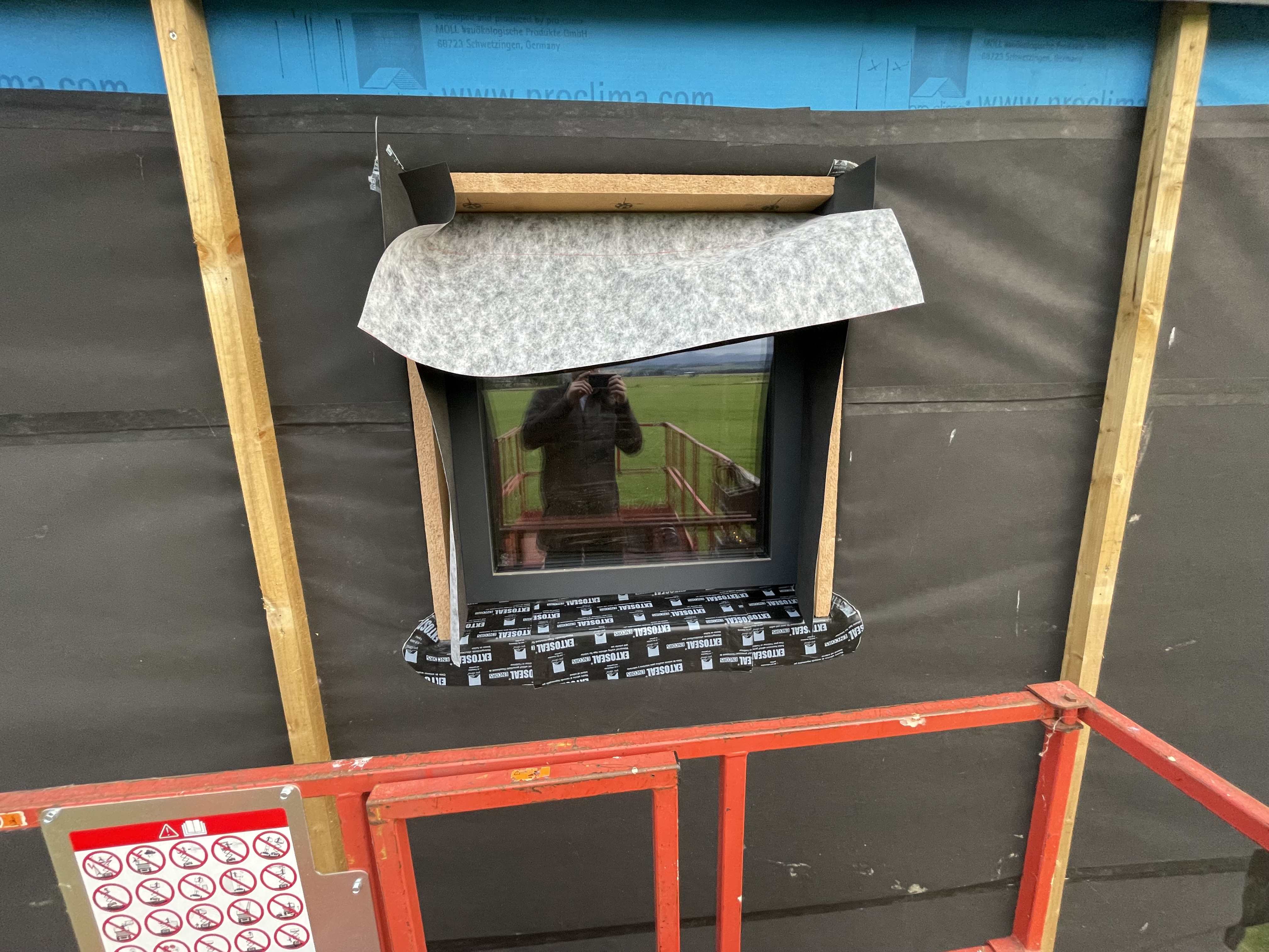

  12. Started dressing in the windows on the outside ready for the cladding. I’m using extoseal for the sill and wood fibre insulation around the windows with a wrap of membrane around the insulation. Take ages per window
