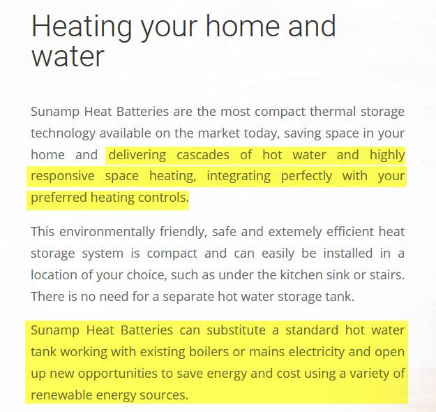

Barney12 Posted February 27, 2019 Share Posted February 27, 2019 Why are we debating "work arounds"? The product should just do as advertised! It doesn't!! "End of chat" (to quote a Welsh plumber from around these parts) 1 Link to comment Share on other sites More sharing options...

joe90 Posted February 27, 2019 Share Posted February 27, 2019 1 hour ago, Barney12 said: Why are we debating "work arounds"? The product should just do as advertised! It doesn't!! I agree, the product should be “fit for purpose” . I suppose @JSHarris sort of agreed to be a “tester” for them originally by giving feedback on performance but his original unit appears to have worked far better than the new one. I would be looking to get my money back if it were me (not to say the problem can’t be sorted out eventually). Link to comment Share on other sites More sharing options...

Jeremy Harris Posted February 27, 2019 Share Posted February 27, 2019 48 minutes ago, joe90 said: I agree, the product should be “fit for purpose” . I suppose @JSHarris sort of agreed to be a “tester” for them originally by giving feedback on performance but his original unit appears to have worked far better than the new one. I would be looking to get my money back if it were me (not to say the problem can’t be sorted out eventually). Probably worth restating the circumstances surrounding my acquisition of an early Sunamp PV, and our current Sunamp Uniq 9 eHW, as they are different, and although I think I explained my relationship with Sunamp back in 2015, that was on ebuild, not here, so is now probably lost. I was introduced to Sunamp by Damon Hart-Davis, who told me that Sunamp were looking for "early adopters" for their Sunamp PV. I entered into an agreement with Sunamp which meant we were supplied with an early production/pre-production Sunamp PV, on the understanding that I would report back to them on it's performance, would openly and honestly publish my experiences on eBuild and our build blog and agree to exchange the heat cells for replacements after two years, so that Sunamp could undertake a "post mortem" on them. In return for this our Sunamp PV was supplied at a substantial discount (but it was NOT free, by any stretch of the imagination). As it happens, Sunamp chose not to ask me to exchange the cells in the Sunamp PV when the 2 years was up, so we carried on using it. The Sunamp PV worked very well, and I was more than happy to recommend it. Not long after the Sunamp Uniq range was released last year, I decided that it would be useful to increase our storage capacity. The Sunamp PV, with it's 5 kWh capacity, was perfectly adequate, but, as we can easily generate 20 to 30 kWh/day I felt that it would be useful to be able to store more heat, so that we had a reserve for days when there was little PV generation. The idea was to be able to increase our self-consumption, and reduce out winter reliance on grid boost charging. Sunamp agreed to sell me a Uniq 9 eHW at a discount, in return for me exchanging the Sunamp PV and providing them with a water sample. I'm not able to say what the discount was, but can confirm that I paid well over £1000 for the Sunamp UniQ, plus the exchange of the Sunamp PV that had cost close to the same amount. To sum up, I agreed to be a tester/early adopter when I purchased the Sunamp PV, but not when I purchased the Sunamp UniQ. I'm grateful for the discount from Sunamp, but overall I have paid them a fair bit more than the full purchase price for a Sunamp UniQ. 3 Link to comment Share on other sites More sharing options...
