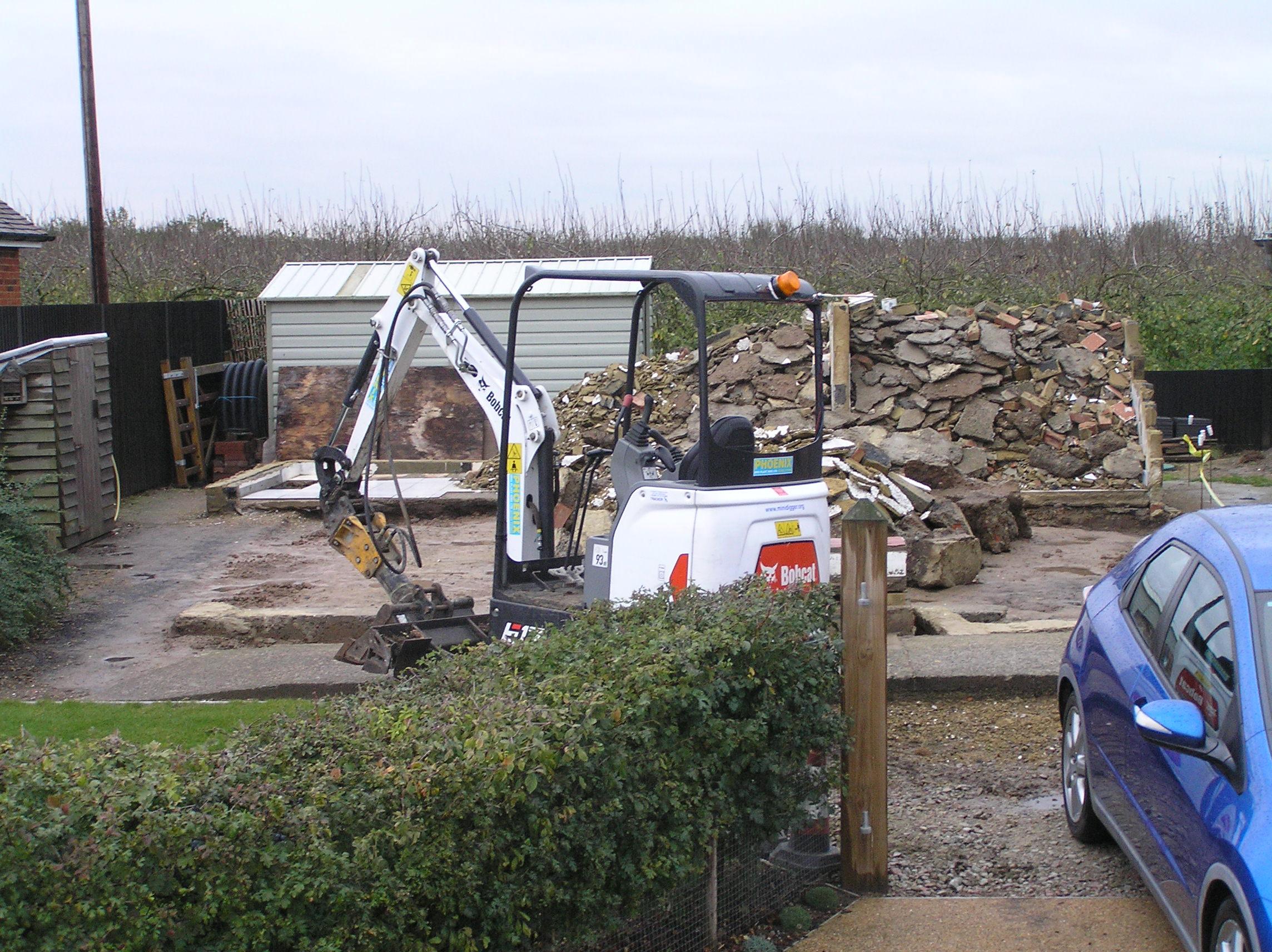

MarkyP Posted January 2, 2019 Posted January 2, 2019 (edited) I'm toying with the idea of buying a digger. All the ground work for our main project is done but we have a large plot (about 3.5 acres) which is very overgrown in places, some derelict outbuildings to demolish and loads and loads and loads of landscaping to do (the site was neglected for decades prior to our ownership). I keep thinking that getting the plot into shape would be so much easier with a digger of my own rather than trying to plan work and hire in a driver and machine. We are also planning to build a holiday cabin (subject to planning consent) which will need ground works. We're here for the long haul and so I think that eventually a machine will pay for itself and having it around will allow me to do stuff that I might otherwise never bother with. I did read somewhere someone saying when you have a machine it makes all sorts of jobs so much easier. Just last week when I spent all afternoon digging out the stump of a dead apple tree, would have taken 5 mins with a digger. And the ability to hire attachments like post knockers and flail heads is appealing for my plot. I'd be interested in any thoughts on what to look for. I started looking at a few sub £5k machines but they were really old and tatty and rattled everywhere and I wonder if £10k might be a more sensible budget. It's a lot of cash though and bit worried about buying a lemon. I'm on the look for a 2.5t or 3t machine, I have the space to keep it and think it will be that much more capable than a smaller machine, and I don't have access or transport worries that might make a smaller machine a better compromise for a builder taking it to and from sites. But anything half decent at this operating weight seems to be around around £12k+. Seen a few possibles at £8 - £10k. a cheaper example I'm considering going to view is this one https://www.sjhallplant.com/mini-midi-diggers/id-2001-bobcat-328 it looks clean but I think this dealer has a paint shop so I expect it's had a blow over. They claim it was farm owner, hence the low hours. The tracks look pretty far gone and it rattles a bit in the video. But does play in the pins and bushes really matter for a DIY'er for occasional use? I'm sure privately a similar machine would be much less and via a dealer there is VAT to pay. Obviously not knowing how to operate a machine yet makes it all the harder to go and inspect as well. Edited January 2, 2019 by MarkyP

Russell griffiths Posted January 3, 2019 Posted January 3, 2019 Have you looked into spares for the bobkat its not a massive player in the mini digger market over here.
MarkyP Posted January 3, 2019 Author Posted January 3, 2019 thanks all. I did last night look a bit more closely at spares and yes it seems they aren't as abundant and two local plant servicing companies don't cover bobcat which is perhaps a sign. The tracks aren't cheap, crikey, £600+ per side! With VAT, new tracks, and perhaps a few bushes and pins, and a service it's suddenly not looking so cheap and into the price bracket for a much newer machine. The ground here is good, well drained on a chalk slope so doesn't get churned up too much but am looking at rubber tracked over wheels or metal. Not much woodland, lots of trees around scrub around the boundaries so think a glazed cab will be OK, but not fussed either way. @Vijay how close are you to being done with your machine? Want to sell it?
Miek Posted January 3, 2019 Posted January 3, 2019 Steel tracks generally last twice as long but cost twice as much to replace as rubber. Rubber is easier to put back on if you pop a track and nicer if you have to cross a delicate surface like tarmac etc... If the tracks are gone then it's well worth checking the undercarriage rollers, sproket and idler as these all wear out with the tracks. Costs a fortune to replace all these items even if you do the work yourself. Bushes and pins are much easier and cheaper to replace than the undercarriage. Check all the grease nipples for damage. Often these get broken and not fixed so the machine doesn't get greased properly. In general Don't buy an ex-hire machine as they get abused.
