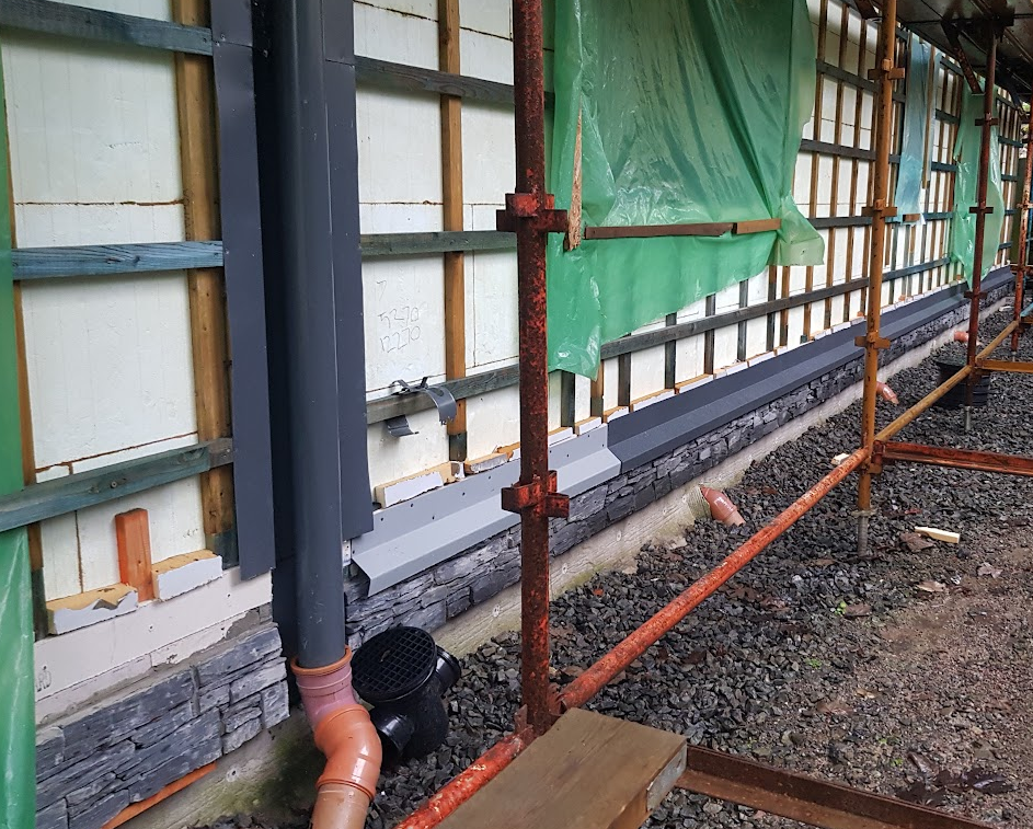

Our formed cills were all folded but they did have to solder a few joints around our plinth flashing. They just took the coating off back to the steel, to the width of the solder and then painted afterwards with colour match spray.

I screwed backer board to the battens. This maintained an air gap at the bottom to ventilate the cladding above. Then fixed a steel mesh to stop 'things' getting up behind the cladding. I screwed temporary battens to support the slate and provide a consistent line (you can just see this on the left of the downpipe) then removed them later. My slate panels had clips prefabricatred into them for a mechanical support, not technically necessary in my case but I still found them useful. Ignore the downpipe connection, that was a temp setup whilst we waited for the correct pieces from lindab to arrive.

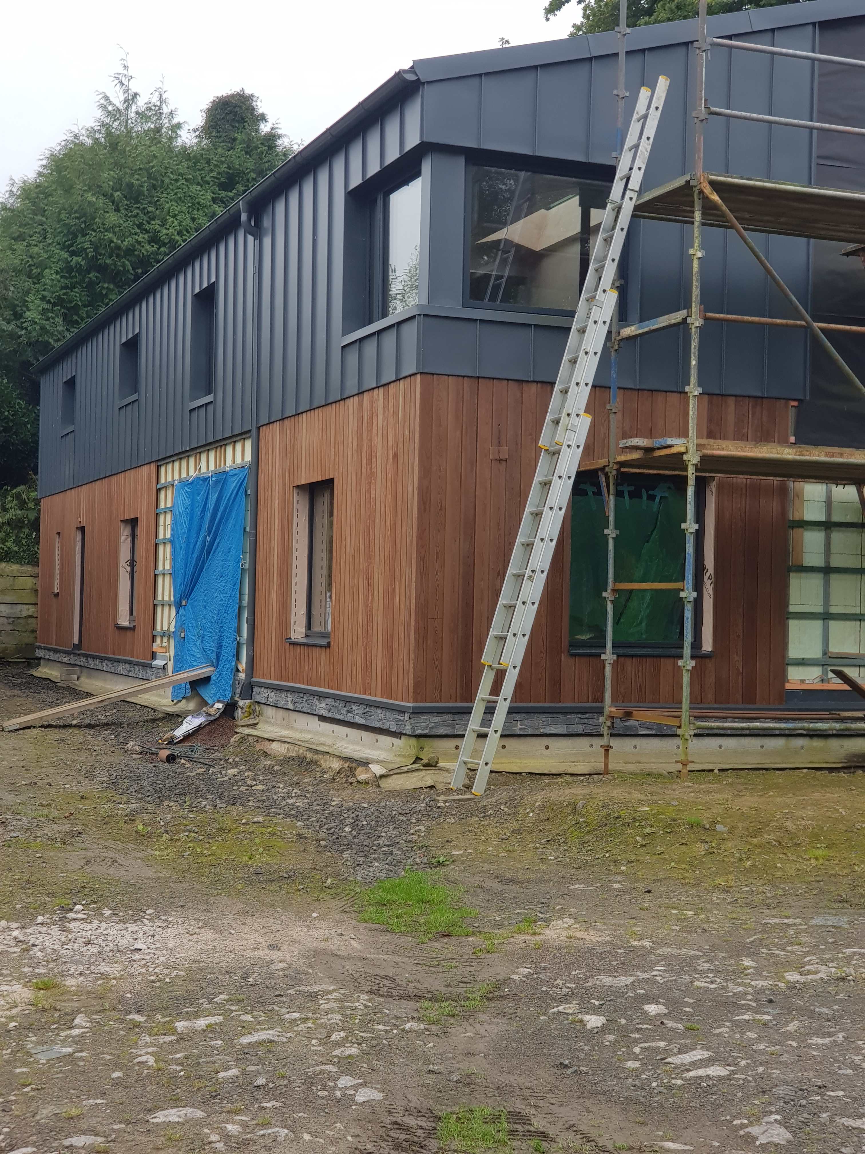

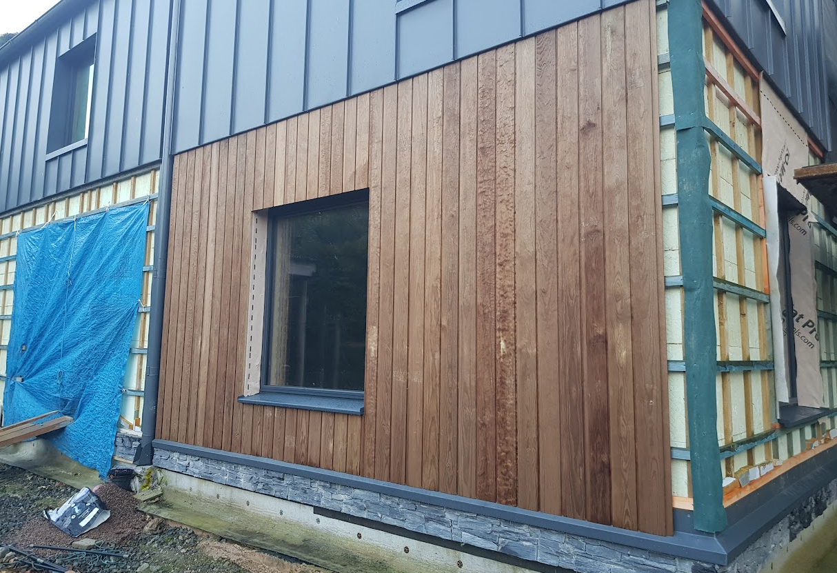

We used Greencoat, that was based on the cost of Zinc at the time and the installer saying we'd never know the difference once it was installed. He said one of the main issues with zinc is due to its softness hence you tend to get more oil canning with it especially over large uniform areas. So he tended to use it more on complicated jobs with lots of detailing e.g. bandstand roofs. Bear in mind that some of the replies are based on Greecoat pre formed and diy/contractor installed whilst others, like me, are based upon specialist subbies with the coils arriving and formed on site with specialist kit. The difference in £/m2 will account for this so make sure you understand what you're asking for and getting. I don't think you'll have a choice with zinc, as far as I'm aware it will have to be formed on site unless a supplier has started pre forming it but not aware of any. -
