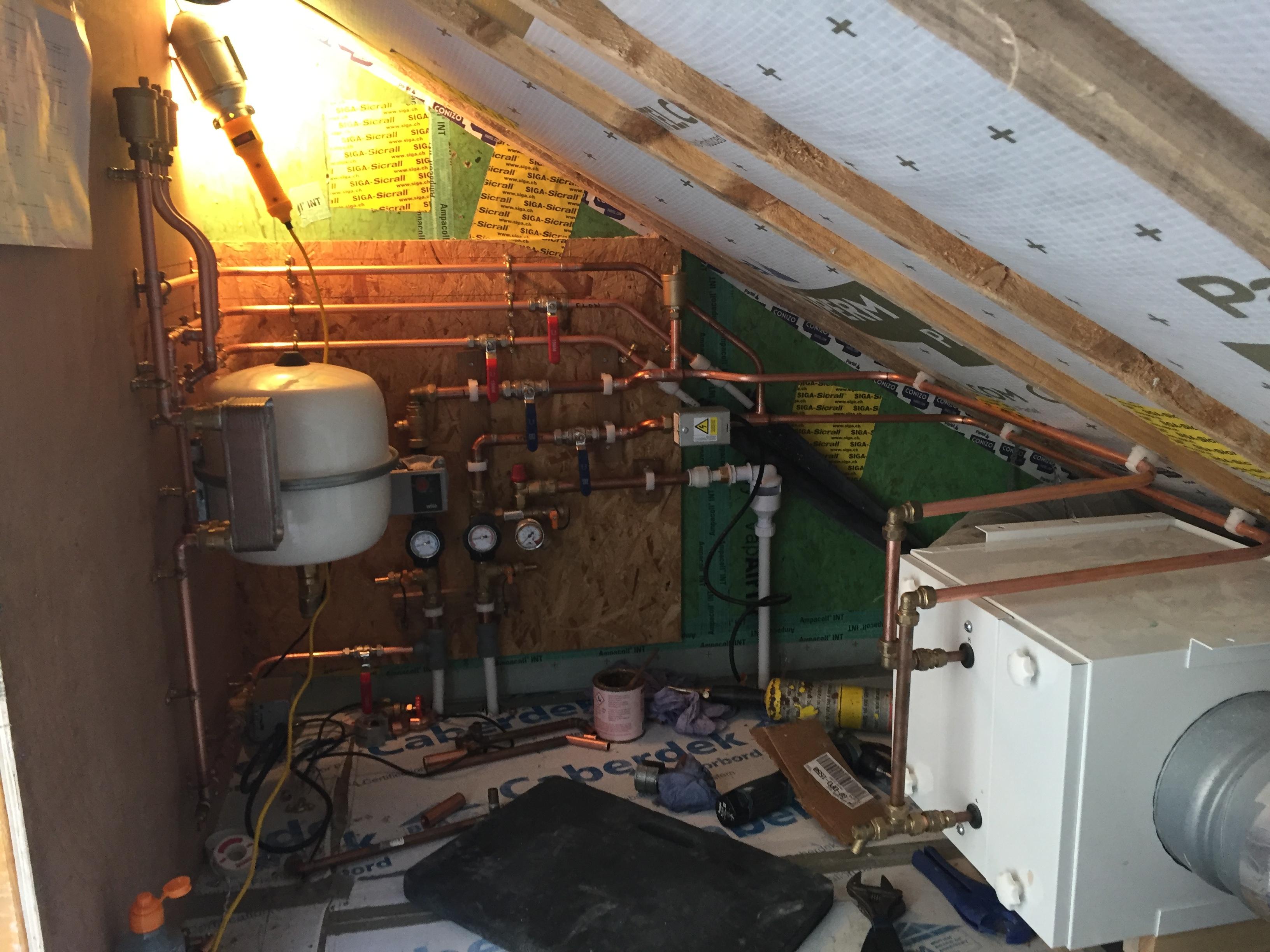

Nickfromwales Posted May 26, 2019 Share Posted May 26, 2019 On 23/05/2019 at 21:16, joth said: Great, Fascinating ideas. Future proofing a spare loop to the loft sound ideal, as from there we'll have easy access to mvhr, loft itself, bedrooms and the vaulted hall light well. Following this with interest.... I am part-way through installing all of the M&E stuff for @MarkA and the core of the heating will be via an ASHP. Mark asked from the outset for cooling, both in the slab and more specifically in the bedrooms also, so I've started off by getting piped for that a-la @JSHarris's install eg to provide slab cooling, as the first line of 'defence'. The flow and return pipes have been extended to both the attic plant, ( above the bathroom that divides bed 2 and bed 3 ( vaulted ceilings )), and the small cupboard space left in the eave of bed 1 where each space will house a single, dumb, duct cooler dedicated to each room. They have been further extended to the ground floor plant room to allow for cooling to be retrospectively added to the one downstairs bedroom ( 4 ) if the need ever arises ( or to inject a bit more heat for that matter ). Bed 1 & 3 catch the southern sun, bed 2 is on the opposite side, as is bed 4, so the biggest dilemma is to manage the cooling 'per room' as opposed to 'all on / all off'. We've allowed for heat / cool capable room stats per ( bed ) room so these can be individually brought in / out of play according to the effects of the solar gain. On 23/05/2019 at 21:16, joth said: Cold air falls so we can drop it down onto any those areas relatively easily. My thoughts, ( yet to be proven ). So what I have done is run 2 more 92mm MVHR ducts from the duct cooler, then under the floor and back into each bedroom, as a cooled air re-circulation setup, where the fan at the duct cooler will blow cooled air directly into the ( part-lowered but still vaulted ) ceiling sections where the warmest air will stagnate. I have then installed a single air extract point at each opposite end of the room, down at a little lower than socket level, where the air gets 'sucked' back up to the duct cooler for cooling and re-introduction to the room. Concerns would be that if the slab cooling mandates the ASHP 'cooling temp' being as low as you say Jeremy, then will there be a risk of getting condensate collecting in the return lines? I was thinking not, as by then the extract air temp will have been lifted by the effects of collecting the unwanted heat from the room. As far as stagnation, that will be dealt with by the fact that these systems are auxiliary and will work alongside the standard MVHR which will continuously reintroduce fresh air. I will choose fans which have 3 speeds, handled by the wall mounted stat / ctrl to keep the controls as dumb ( K.I.S.S. ) as possible. That will be the means of dictating how much or how little cooling is employed at any one time. The idea being that speed 1 would be quiet enough to sleep with, and speed 3 would give you a decent 'breeze'. All theoretical until I switch it on, but I'm ( very ) quietly confident. Discussions have been about prevention being better than cure, so to manage the heating ( cooling ) effectively it seems best to address it before it becomes problematic. This can be managed, effectively I hope, in one of two ways; 1) Don't let the rooms get too hot before introducing the cooling system....."Simple!" So, predict if you need to boost cool, eg if you know it's going to be a sunny aka problematic midday / late afternoon then you can simply hit a boost controller to force run the cooling side of the system PRIOR to the hysteresis of the stat detecting the increase. It's quite obvious when you're in a 'passive' house ( well insulated / airtight in other words ) and the sun is up and at 'em.It gets warm, and it does it quite quickly, which means the cooling would have to fight to bring the temp down after the stat failed to predict the degree of heat rise and 'set-back' according to it's pending impact. Now to revert to the prevention technique, that can't really be done autonomously unless you have a weather-predictive what-not an an entry-level home automation system with some basic intelligence, but there is, as I say above, the ability to just give it the human touch. Simple, and free. If you're in, use your noggin, if you're planning a day out, give the house a 4 hour boost ( £20 time-clock will suffice ) and have the cooling system run to offset the additional heat gain. Results, house never gets to the problematic heat level, and the fabric of the dwelling stays close t, or at, the comfort / desired ambient temp. 2) Weather compensation. I have decided to re-invent this a little after seeing @Barney12's BPC duct cooler in his MVHR intake from atmosphere. That is connected to a 'geothermal' brine loop that simply, very simply actually, recirculates the temp of Terra-Firma to the duct cooler. A bit of uplift when the outside air temp gets very low, and vice versa. Better than nowt but could be improved ( but remembering firstly that @Barney12 doesn't have an ASHP so this geothermal option had significant attraction ). Ok, that said, when I fitted the SA ( Sunamp ) units there I decided to give this ( already previously installed ) setup a kick in the dangle-berries. I stripped it all back, introduce a PHE ( plate heat exchanger ) and a flip - flop ctrl system so heat could be injected into the duct cooler from the SA if the outside air temp got ridiculously low ( Dartmoor ). Worked rather well if i might say so. Ignore the clutter, Einsteins desk on a good day Ok, continuing point 2)..... The whole point of a comfortable home should be, that you can wake up and not know if its summer or winter IMO, so that said, we go back to 'weather compensation'. In Mark's I intend to fit ( probably a pair of ) the above duct cooler unit(s) with the specific intention of getting outside air as close to a constant 20.5oC as possible. They will be installed in the inlet from atmosphere, immediately prior to the MVHR unit. FYI, as Mark will have an ASHP we have not gone to the added expense of an MVHR unit with internal heat pump as that's a minimum uplift in cost of £2k. The idea being not to introduce a problem in the first place and then have to deal with it afterwards with a significant separate additional system. That said there is still merit in having cooling in the bedrooms IMO even with such a core prevention strategy in place, BUT, with that preemptive measure in place, the auxiliary systems can be dialled back and made far simpler / lower spec etc and thus have less impact on the inhabitants eg from from noise pollution etc caused by being forced to run such auxiliary systems at full wallop. Homework for this weekend includes looking for some decent units and looking at the max airflow rates through them to decide what will have near zero impact on the air intake path to the MVHR ( hence my thoughts to parallel two units and be done with it ). "Seems like a nice, straightforward job"...................... Link to comment Share on other sites More sharing options...

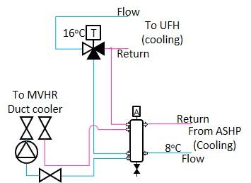

le-cerveau Posted May 27, 2019 Share Posted May 27, 2019 When I was designing my system (3 years ago) I looked at adding a duct cooler as well as slab cooling and to overcome the problem of condensation I planned on running the ASHP (in cooling) at about 8oC but using a thermostatic to provide warmer 16oC to the slab. Doing this by providing the UFH return to the hot side and the ASHP to the cold side, and utilising a hydraulic separator to balance the pressure. This was one of my original layouts. The TMV would draw enough cooled water to reduce the return to the desired level, whilst allowing the duct cooler maximum power. The ESBE TVA572 series of valves have an option down to 10-30oC control which would work (confirmed with them) or could utilise an electronic controller I use a CRA110 controller on a VRG 130 mixing valve to control my UFH (I run it at 26oC), but it goes down to +5 so could be used as a cooling control. It is a complication but to maximise duct cooling whilst avoiding floor condensation it is an option. 2 Link to comment Share on other sites More sharing options...
Nickfromwales Posted May 27, 2019 Share Posted May 27, 2019 38 minutes ago, le-cerveau said: The TMV would draw enough cooled water to reduce the return to the desired level, whilst allowing the duct cooler maximum power. That's the ESBE valve I have to fit if using a SA for pre-heat to a WB combi, so I'm aware of them, just the thought never crossed my mind to use one there to max out for the duct coolers. Noted, and appreciated, thanks. Link to comment Share on other sites More sharing options...
Jeremy Harris Posted May 27, 2019 Share Posted May 27, 2019 In practice, I've found that there's no problem with running a flow temperature of around 10° to 12°C directly into the UFH for cooling. The floor surface temperature is the critical thing, and this never seems to get below 17° to 18°C, and so never attracts condensation. With an air temperature of 22°C and a floor temperature of 17°C the humidity would need to be about 73% to start to cause condensation on the floor, and we never see more than about 55% inside the house, and then only in cool, damp, weather. With a room temperature of 22° the floor surface could be safely cooled to about 14°C, as that would need an RH of about 61% in order to create condensation. If the room was warmer, say 24°C, then for a maximum RH of 60% the floor surface could be cooled to about 16°C, more than enough to provide very effective cooling in most cases. For a belt and braces approach, it might be an idea to measure the RH and use that to set the minimum flow temperature. This would allow the floor surface to be cooled to, say, 13°C for a room temperature of 24°C and RH of 50%. 1 Link to comment Share on other sites More sharing options...
