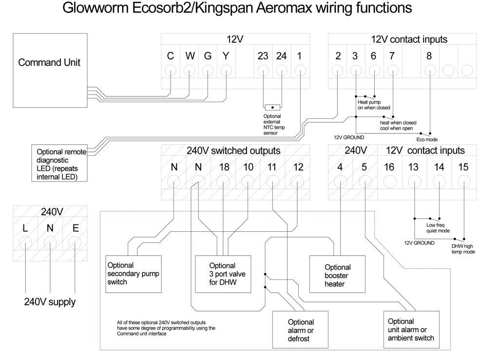

You don't need the command unit to get cooling to work, provided the cooling temperature has already been programmed into the unit.  The command unit sends data to the ASHP to change the settings, which are then stored in non-volatile memory inside the ASHP itself.
Changing the Carrier-based units from heating to cooling is just a matter of the way you wire up the 12 V dry contact controls, as shown on this diagram I drew up:
@JSHarris Ah, so the link wire between 3&7 could effectively be replaced with a switch (closed = heat, open = cooling)? Is it that simple?
I’ve also notice in your diagram the link between 13&15... does this crank up the output temp when calling for DHW?
Yes, it's that simple!
Yes, it does.
In both cases the temperature that the ASHP will run at depends on what's been programmed into it, either during manufacture or from the command unit, so without knowing the internally stored settings it's hard to be sure how cold the flow will be in cooling mode or how hot the flow will be in DHW mode.  My guess is that the internal control board may be set to the default values in the command unit manual.
