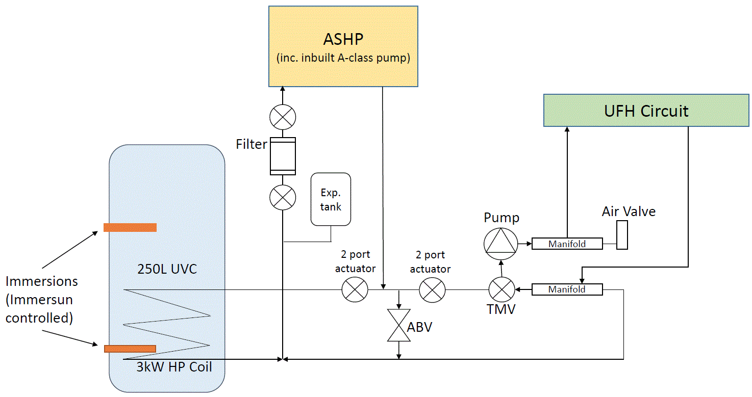

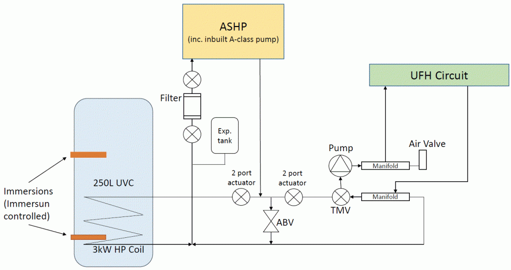

This is what mines looks like:
There are one or two more valves than what's shown, and the two filling loops (one inside, the other outside) aren't shown.
We went for an ASHP because we don't have gas, and wanted the ability to cool as well. (Incidentally, I enabled the cooling mode the day before yesterday for the first time, and was amazed at how quickly it had an impact. Now just need a way to cool the bedrooms.)
I went with an unvented cylinder because a thermal store would need to have been a lot bigger for the same effective capacity (ie, how much hot water you can get out), and we're a little tight on space in our plant room. If I were doing it again today, I might consider a thermal store (no need for G3 inspections) or perhaps a Sunamp if they do a unit(s) that's compatible with the rest of our system.
It's pretty simple. The main annoyance is that the standard controller for the ASHP is dire. It's slow and counterintuitive to program. You can't program any logic into it (eg, once we leave the cooling season, I'll need to reprogram it for heating - not difficult, but 5 annoying mins trying to remember how the programming works). You can't even copy a day's settings to another day. Longer term I'd like to replace this with a more intuitive interface via our home automation system.

Ok I’ll add this in. All electric with E7, above spec on airtight and uValues of 0.15/0.17 ish, ASHP is 9kw into a 250 litre UVC with 70 litre UFH buffer all run as W-Plan.
ASHP set to max 45c on DHW with immersion boost overnight. UFH run at 30c, buffer 35c.
Heating Schematic V2 2504.pdf
This is my initial conclusion and in due course I will be looking to stitch a conventional heating programmer into the system so you can basically ignore the supplied programmer, and control it all from conventional straightforward heating controls.  There are one or two challenges for this but I have some ideas.  Watch my thread when I get around to doing it.
