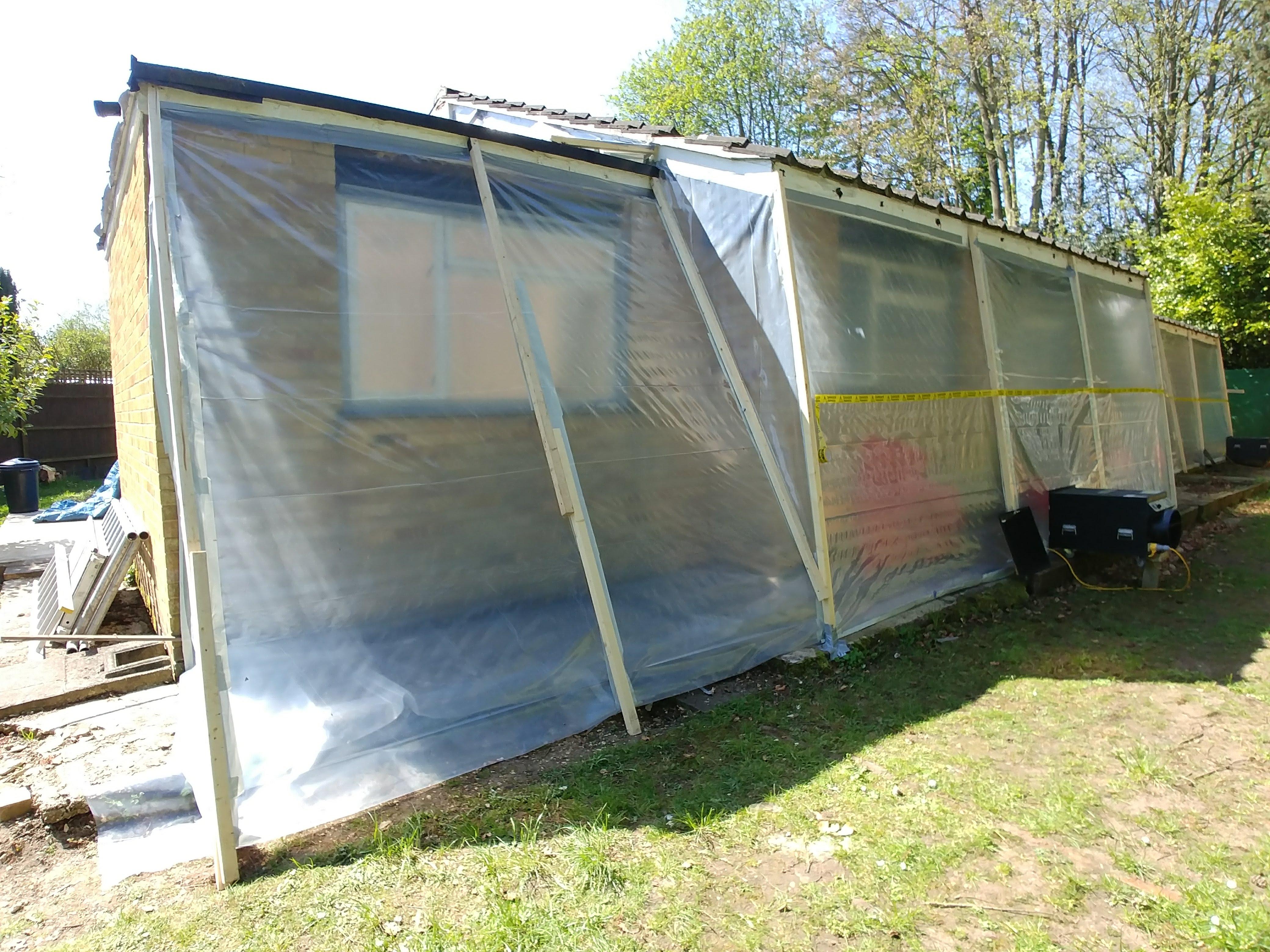

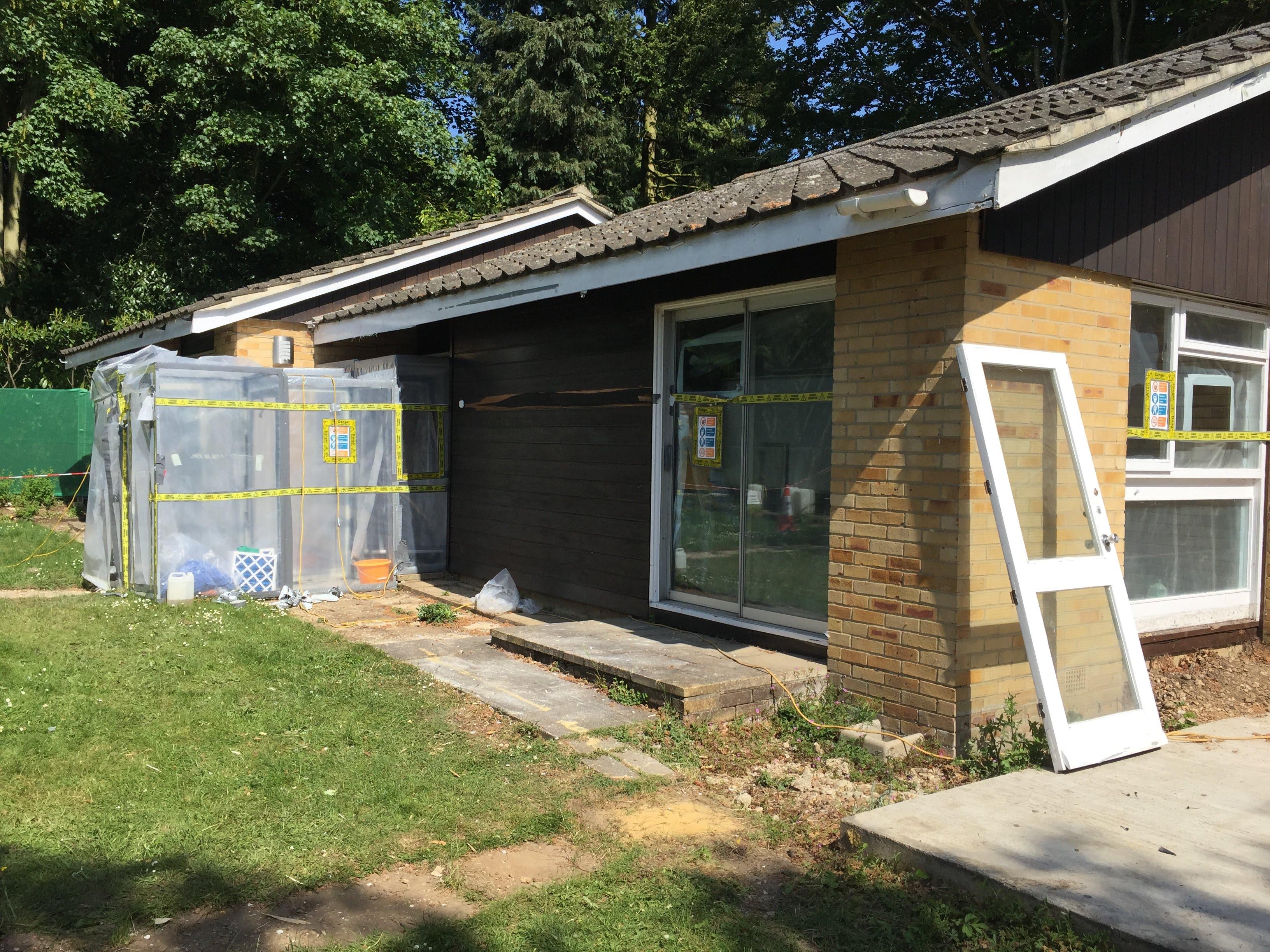

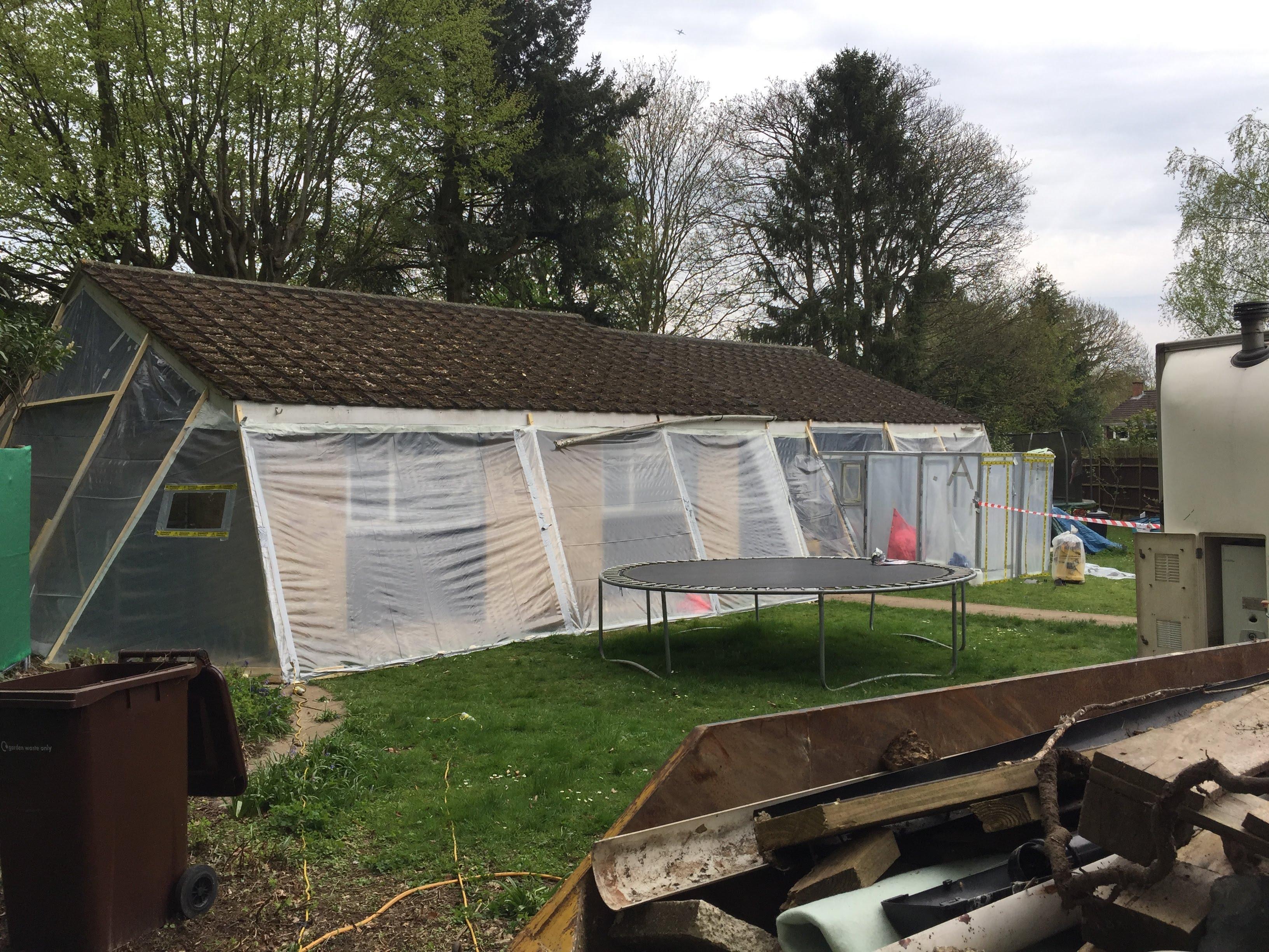

Weebles Posted May 21, 2018 Posted May 21, 2018 I am posting this in case it is helpful to anyone on this site now or in the future. We have just had the last bit of asbestos removed from our 1960s bungalow and demolition is now able to commence. If you have asbestos it needs to be removed and disposed of appropriately. Some asbestos is not as bad (chrysotile for example) and can be dampened, double bagged in heavy duty polythene and taken to a tip that accepts asbestos (many don't). But if you have the bad stuff (we had amosite) it has to be put in sealed containers and shipped out properly and the work has to be done by licenced contractors. The Health & Safety Executive needs to be informed 14 days prior to work commencing. Our contractors did that for us. We suspected asbestos so got a couple of samples tested a year ago. One was chrysotile, the other was amosite (asbestos insulating board used on our soffits). At that point our demolition costs went up by a factor of 6 ? You need an asbestos survey before demolition. These are invasive and leave your house with holes everywhere (ceilings / walls). They can repair the damage and allow you back in once it is done but most surveyors we spoke to didn't recommend it. We moved out permanently before getting our survey. Sadly our survey showed up even more asbestos than we knew about. We knew about the soffit boards and the roof edging strips and the artex ceilings. We didn't know that every vertical wall strut in the outer walls of our timber frame 1960s "flat pack from the NEC" would be lined with a strip of asbestos. Our asbestos contractors have been in for a week in April and then again for most of May (had to give an additional 14 days notice to HSE for the newly found asbestos). First a protective plastic "bubble" was fitted around the house, encasing the soffits. Extract fans were placed to filter the air before extracting it to the outside world. An airlock of plastic encased boxes was built to the front of the house. A shower unit was permanently on site for the guys when they de-suited each day. The soffits were removed, then the house was sealed from the inside so the internal asbestos could be removed. At all times, all the guys working wore masks and full protective suits. After all was removed, an asbestos analyst attended to ensure that the air was clean and the asbestos was removed and all areas appropriately cleaned. A certificate of reoccupation was then issued to officially allow people to go back into the house without all the suits and masks. A contractor has done all this for us and we are glad that we haven't attempted any of this ourselves. They finished yesterday (though the chrysotile roof edging is still in place and will be taken off with the tiles). Some photos attached. Hope this is helpful to someone else. 10

Weebles Posted May 23, 2018 Author Posted May 23, 2018 Although it has cost alot of our contingency fund we are pleased we paid the specialists to do the job. Not something worth mucking round with. The fire option mentioned by @Nickfromwales was tempting but my Dad had told me about the explosion risk (he'd seen a house go up in flames and chuck asbestos bits out everywhere) and we have already upset our neighbour enough by just living here ?. The asbestos filled sealed skip should be on its way to Swindon this week. We do occasionally find bits of chrysotile buried in the garden so goodness knows whats going to be under this house...... Thanks everyone for the supportive posts. Our project is finally getting underway. 2
