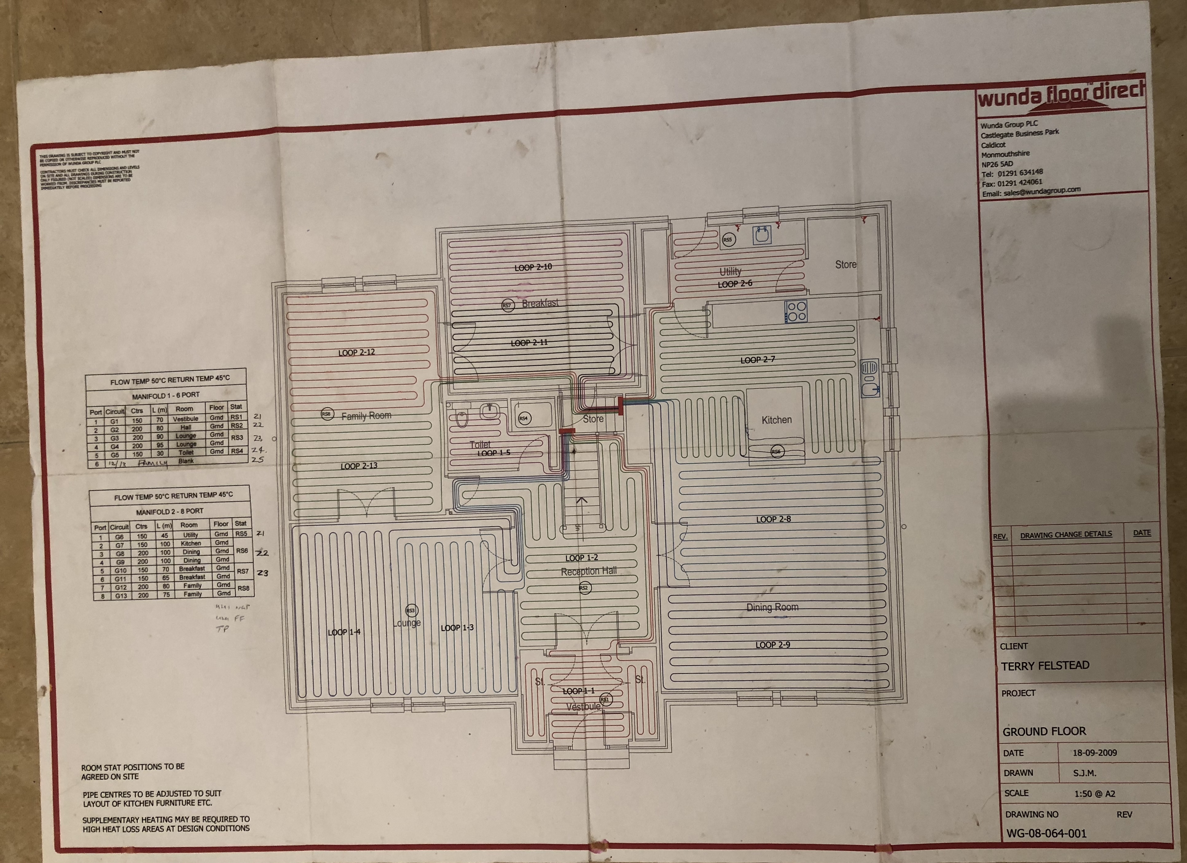

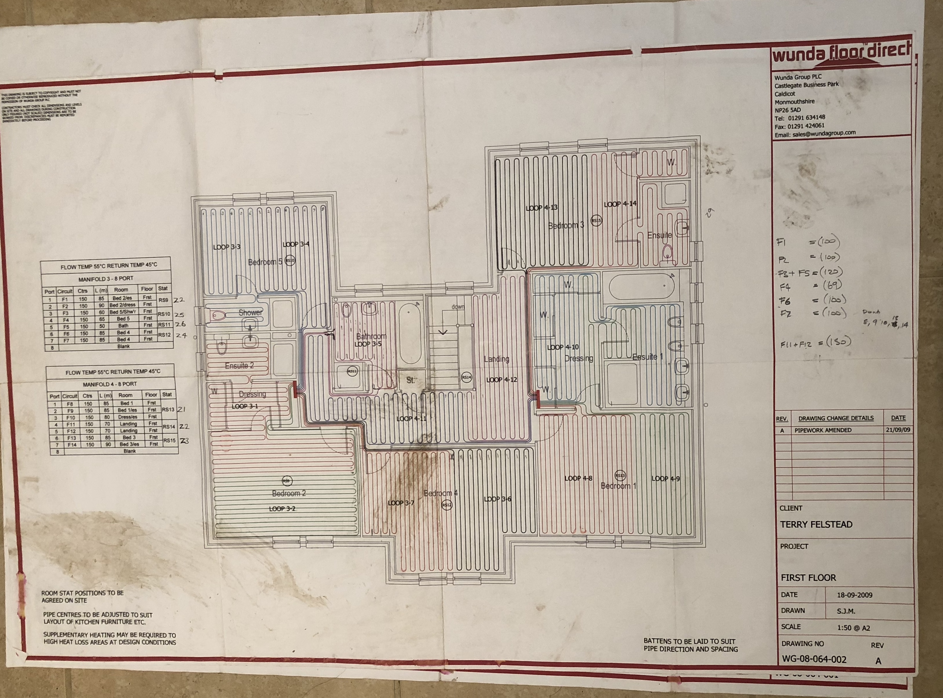

Following on from this post

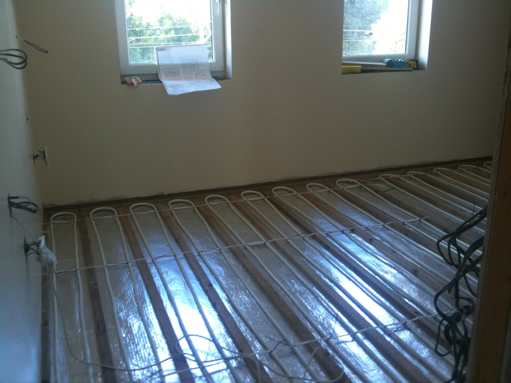

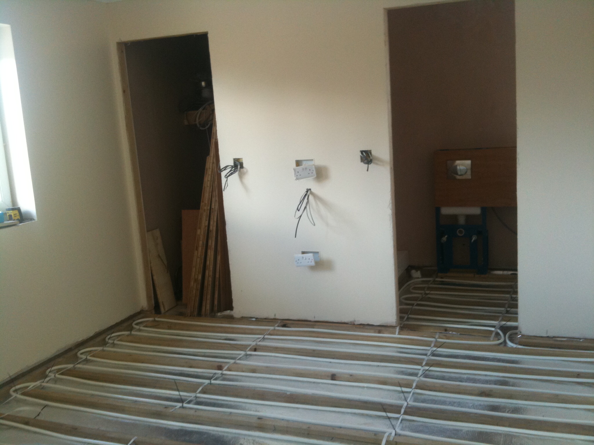

How many any of the rooms have the UFH piped that way eg just laying in between the battens over the insulation? Is the entire first floor piped like that ? Are all the ground floor loops in screed?
The entire 1st floor. Ground floor is all in anhydrite screed (something else I wish we’d done differently!).
One of the issues you may be getting with the upstairs heating is poor performance as there are no aluminium spreader plates to effectively get the heat from the pipes into the flooring. :/. Deffo need the independent manifolds with their own flow temp control, so you can run the flow cooler downstairs and much hotter upstairs to compensate.
Not ideal, but I think your getting used to hearing that now -_-.
That layout looks non-optimised (ie not spiral counterflow) and just someone putting the pipes down with little/no thought and if I had to hazard a guess there could well be loops over 100m in length!
Wundafloor designed the loops / layout. We paid them for the design.
Edited by newhome
Wunda (pun intended) why they didn’t factor these in as part of the design? They provided all of the UFH kit.
As you say, too late now tho!
Very surprised to see that they didn't spec or even insist on alu spreader plates to get the heat out of the loops upstairs.
Should hopefully be able to cheat that by running the 1st floor flow temp a good bit hotter than downstairs.
