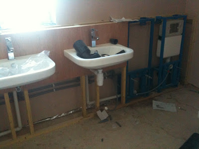

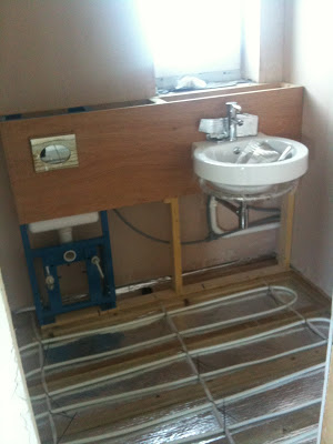

Just thought of another (fairly minor) irritation. DHW seems to take quite a while to arrive upstairs, especially to the taps / showers furthest away from the TS. Is that just due to the distance and something to live with? I have to warn visitors that hot water won’t arrive instantly.
Do you know how far away it it.  If you can estimate it reasonably well, and you can easily measure the flow rate (jug and stopwatch), you can work out if it is a real problem or just something you have to live with.
Are the pipes lagged?
I don’t know re the pipes. I didn’t really take much notice when that stuff was going on sadly as I had a flat in Edinburgh in the early stages. Here are the only photos I can find so I imagine the answer to the insulation question is no.
Adding up the distance directly round the walls (is that where the pipes are likely to be?). It’s circa 35 metres to the furthest shower.
So re the flow rate I time how long hot hot water takes to arrive once the tap is turned on?
Flow rate is how many litres per minute comes out the tap.
Then you work out the volume of the pipe and that should give you the time.
If you compare it to other other taps around the place, you should be able to see if it is that bathroom has a particular problem, or it is just a general lack of flow and pressure.
All a bit of a faff I know.  But I will get you measuring everything eventually.
Sounds like a couple of cold dead legs - not much you can do now as the method of fixing is either to use a hot return loop or use smaller bore pipe to the taps.
I will work on being more patient! :D:ph34r:
So it’s circa 30 seconds to feel any sign of warmth at all and just over a minute to get it up to the full temperature. That’s a minute of my life I will never get back when I shower :D
