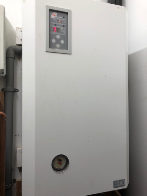

From my limited knowledge, the system has an electric boiler (no gas in the village), a thermal store and evacuated tube solar panels which are all supposed to feed wet underfloor heating (in every room) and provide hot water.

    Right then, here we go...... Order of events :- ( chapter one lol ).   Electric boiler which is sealed and pressurised. Thats the reason why the pressure needs topping up occasionally.

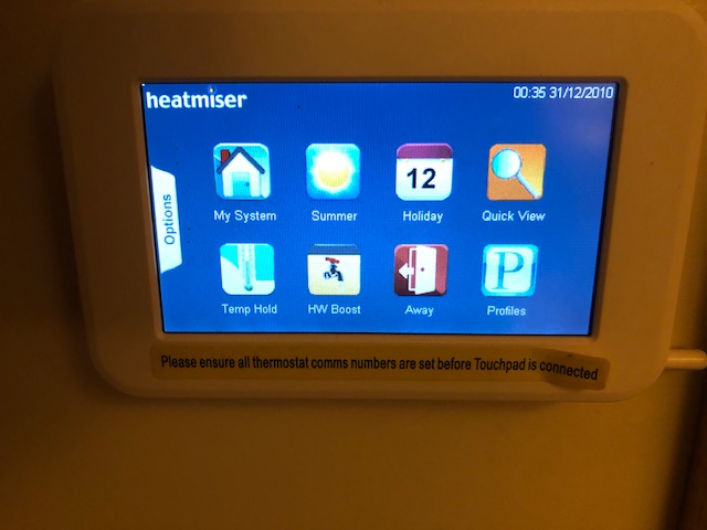

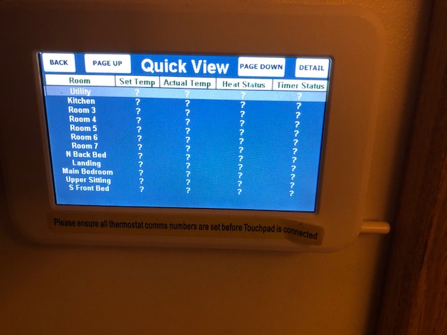

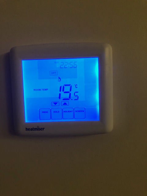

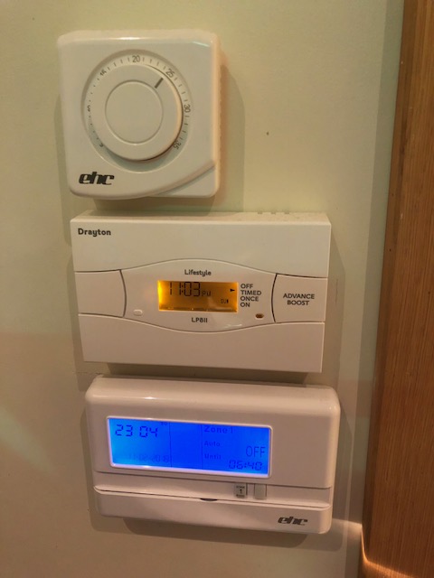

Here is the heating controller (and one of the thermostats). As you can see the temperatures are all set to ?. How can I fix this please? I'm scared to reset anything in case it loses all the settings. I don't seem to have a manual for this and can't find one online.

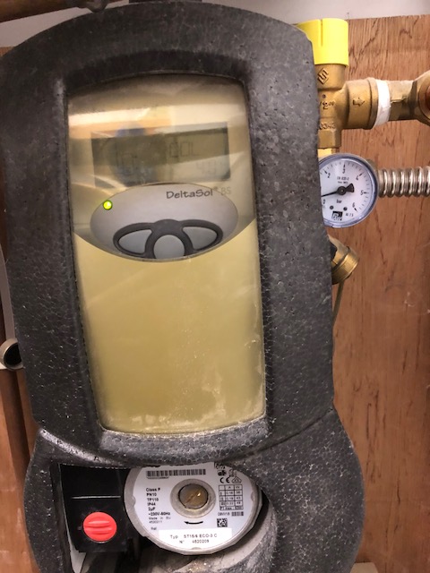

Here is the solar controller thing. There is this metal bottle next to it which I assume is something to do with it? The pressure dial next to it is set very low.

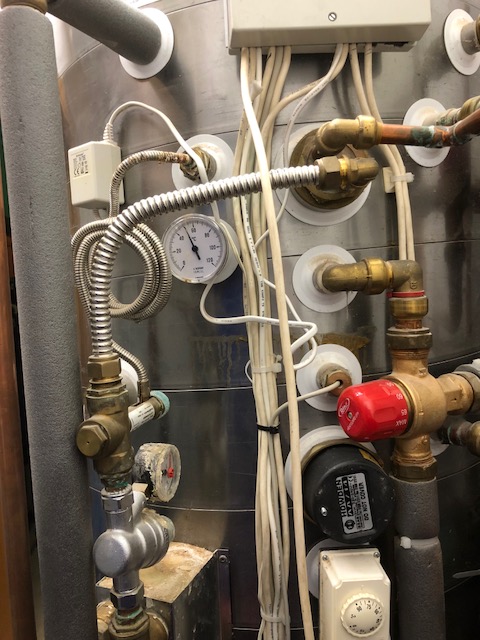

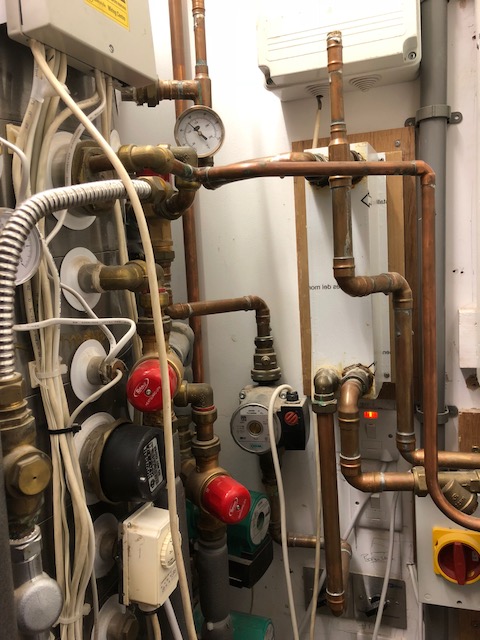

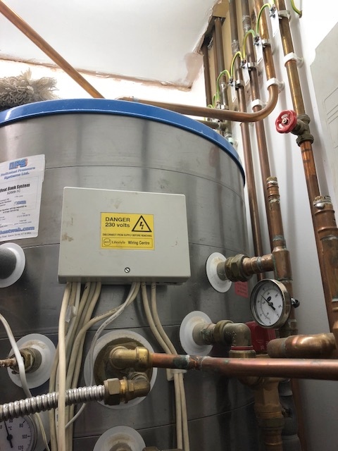

Here is the bit that has most of them running for the hills. No one seems to have a clue about how this should work.

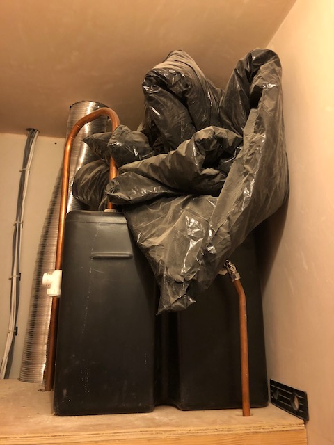

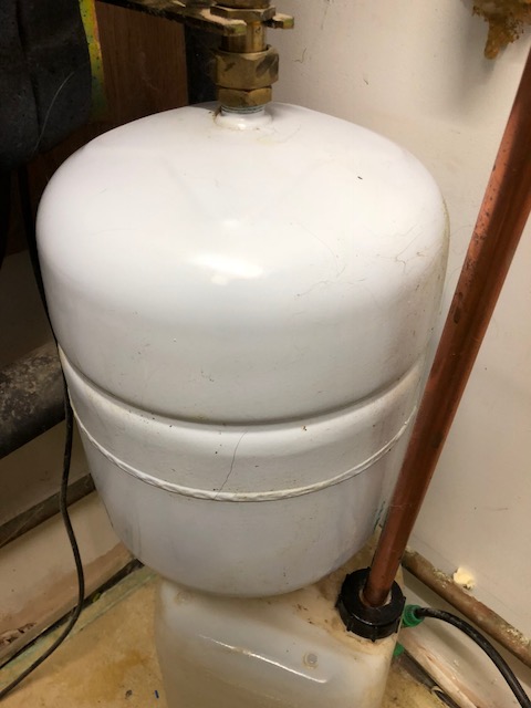

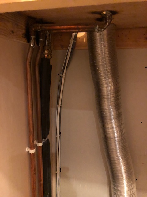

The pipes going from the top of the thermal store appear in a cupboard in one of the bedrooms where they join up to this small water tank. I have no clue what this does.

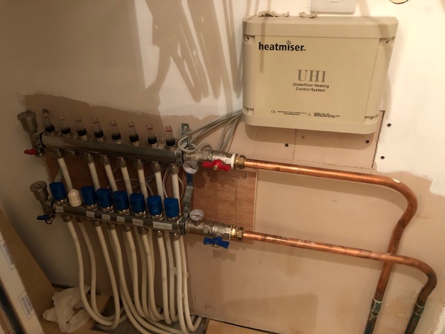

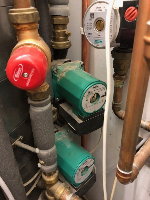

I've also shown a photo of one of the manifolds. As I said, the pipes are warm but the heat never seems to reach the right rooms upstairs unless I'm doing something wrong.
The 3 boxes on the wall were installed by a plumber to allow me to control when the boiler and the underfloor heating pump come on. I have to keep them in sync otherwise I have no hot water. I can only get hot water from the taps when the pump is on, which isn't a massive deal when I'm here on my own but it's far from perfect.

A "heat store" is just that, a big water tank that sores heat.  The idea being the boiler heats the heat store, and then the heat store provides the hot water and under floor heating. Remember that bit. The heat input control is quite separate to the heat output controls. They need to be analysed and investigated separately.
Assuming you have economy 10 (I really hope so otherwise it is going to be expensive) then you want the boiler programmer set so the electric boiler is on at all 10 of the cheap rate hours in a day and will heat that tank quite hot, probably 70 or 80 degrees.  There is often a thermometer on a heat store tank if you have one what does it say.
Domestic hot water is just achieved by cold water in through a heat exchange coil in the store and out as hot water.  If the tank is hot then you will get hot water, which will gradually reduce in temperature as you run it unless the boiler can keep up with the rate you are using heat. If you can only get half a bath, then the water in the thermal store is nowhere near hot enough.

So the stats look like a Heatmiser Neo or earlier system with the Touch Screen programmer.
Is there a black box in the heating wiring system somewhere ..? That will help to sort the actual model and get the right manual.

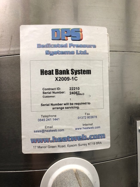

Thermal store is a a pretty standard one by the looks of it - Heatweb made them from the late 80s. Still in business and still service them too so nothing lost there. Just go to the website on the tank.
The plastic tank is a header tank - no issue with that.
The worry for  me is the new thermostat as that shouldn’t be needed. The Heatmiser system is pretty good once set up but takes time. That looks like the new plumber has added controls over the existing ones which may have added to the problems.

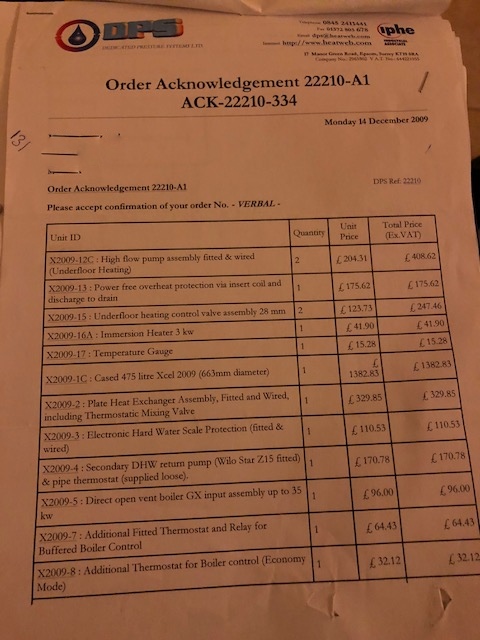

Here are the invoices I found which I assume list all the components of the heating system in case this is helpful.
Okay some more thoughts as you posted more pictures while I was typing.
The little black tank is a cold water header tank. That is normal, a thermal store is full of water that unlike a normal hot water tank, never changes, and that cold tank feeds it to ensure it never runs dry (if there was a leak) and has somewhere to expand to when it gets hot (it's a feed and expansion tank)
That under floor heating manifold is a bit basic. Normally they have a thermostatic blending valve, so regardless of the temprature of the water in the tank, they mix it down to a low temperature for the under floor loops. There is usually also a pump.  Yours don't have these so at the moment  what is pumping it and what controls the water temperaure in the UFH is a mystery.
One of those controllers, probably the top one, will control the boiler on times. The heatmiser controls will control the UFH on times. (hot water remember is "on" all the time)
I don't know why someone has put a room thermostat in what I suspect is a cupboard.
Just a note on the solar thermal.
Again that is a separate thing in it's own right.
The way they work is this. It's controller will monitor the temperature of the water in the thermal store, and the temperature of the water in the on roof tubes.  When the water temp in the tubes exceeds the water temp in the store, it will turn it's pump on to circulate the water from the tubes to the store. It does this by passing that water through  a heat input coil in the bottom of the tank.  So on a sunny day the pump will be turning on and off to move water around whenever it is hot enough to heat the tank.  This heat just adds to what is in the tank from the boiler and so reduced the boiler load and hence saves you money.
It's circulating loop will be filled with brine so it does not freeze on the roof. Don't expect it to do anything at this time of year.

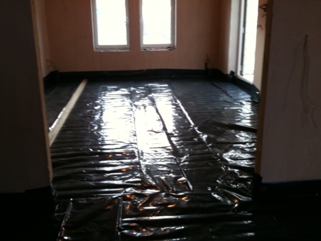

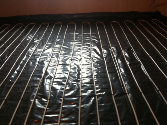

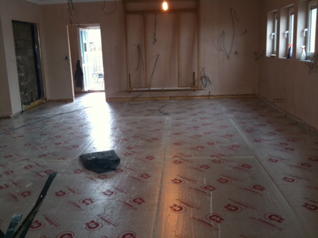

I've attached some photos of when the underfloor heating was installed showing the insulation used etc. It was all then covered in an anhydrite screed and the rooms either have tiles or engineered oak.
It didn't do anything in the summer either. Never heated any water even when it was pretty hot outside. I know that it did use to heat the water to about 40 degrees on a decent day but now doesn't do anything at all. I had the solar guy out in August but typically it was a rainy overcast day so the column was not showing as heating.

Could you please take a couple more pics of the thermal store, zoomed out a good bit so I can see whats going where.
Ive just about sussed it but I cant see the path of one or two items.
