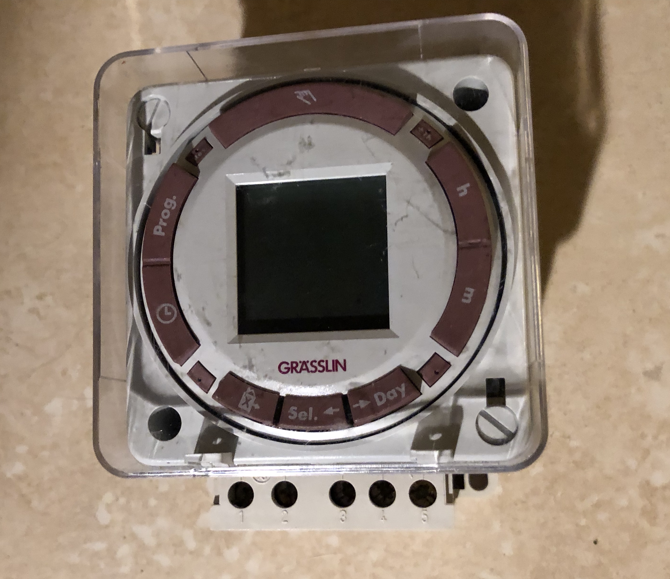

12 minutes ago, newhome said:
@Nickfromwales I found this lying in that room. Is it a part for this or something else?
Ha ha ha ..!! I bet that was fitted to the boiler and the last bloke removed it .....
That's a time switch.....
1 minute ago, Nickfromwales said:
No grasslin clock sized hole in the boiler case though?
Nope, boiler case still intact .......
