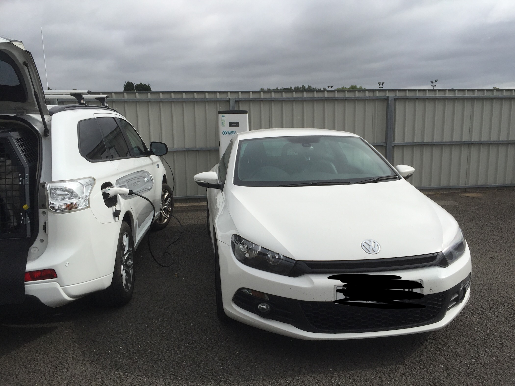

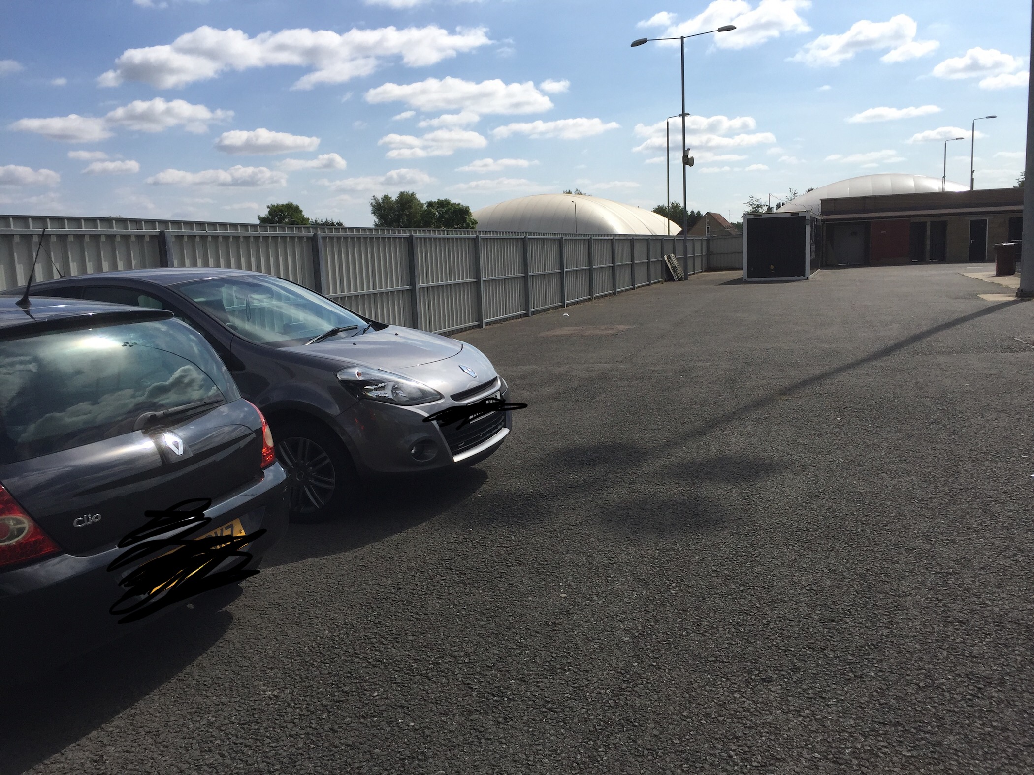

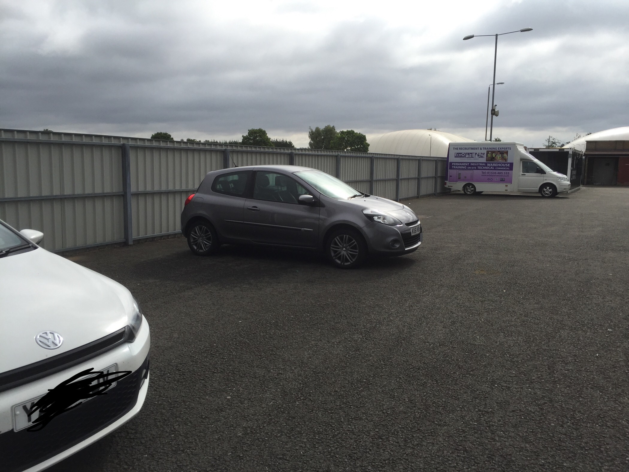

Actually their EV infrastructure is pretty decent. Well that’s if the locals let you use it. This is the charge point I was trying to use, with the second photo of the car park for context! The third photo is the same scenario the next day so not a one off.
That is more cars than I have seen at the Land's End charging point.
Yeah but none of the bastard things parked there are EVs (apart from mine)!
There's all that bloody room and they choose to block the charging points!
