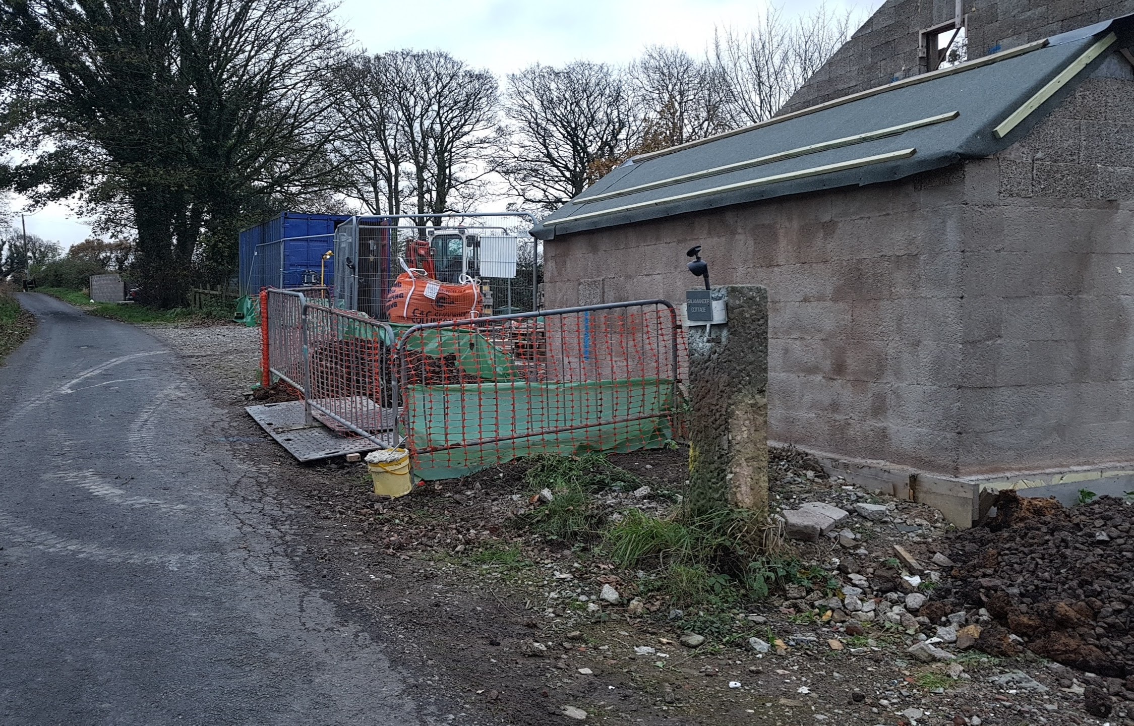

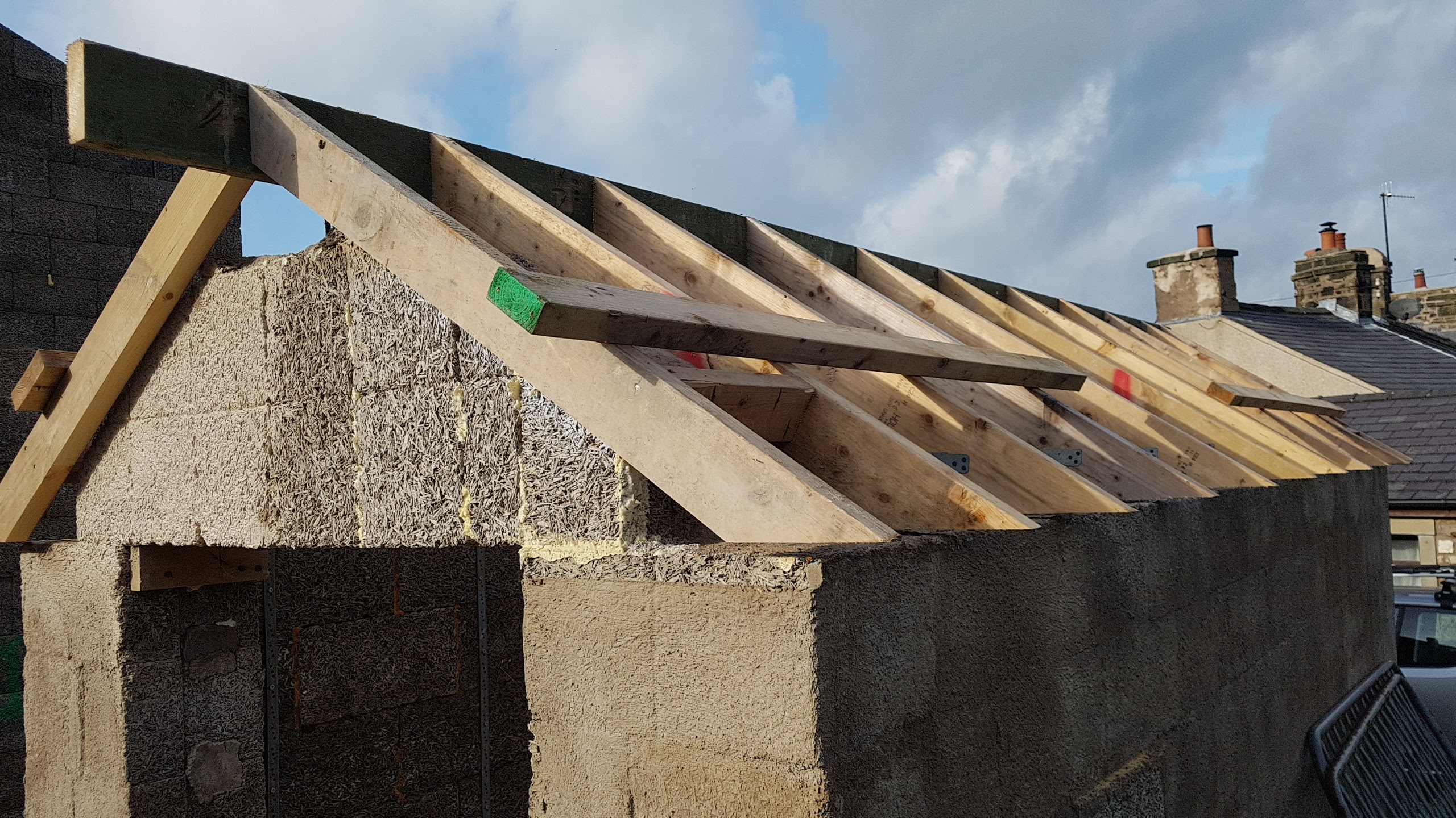

ToughButterCup Posted January 26, 2018 Share Posted January 26, 2018 It's all @Construction Channel, @Barney12, @Triassic, @vfrdave ' s faults. I have decided to try and slate the roof of our little piggery. The key factor in my decision is the simplicity of the roof. It's five meters long and dead straight (now) Well, got to save money somehow. And as SWMBO says, it keeps me off the streets. I anticipate going into a lot of detail, so this post will be one of a few: I'll make a little navbar within this and subsequent posts. (There's nothing to link to yet, so the doesn't work). Why do that? Because it will make it easier for potential roofers to follow the threads. This (will be) one of a series [1] [2] [3] [4] [5] The background We have an old piggery which is not subject to Building Regs that has been knocked down (under Permitted Development) and rebuilt (badly: there's a really big curve in the west wall - one of the reasons we sacked the builder). Again at @Construction Channel's encouragement I built the roof like this.... using recycled wood from the shuttering disaster (another reason we sacked the builder) By the way, I colour-coded the recycled wood : red paint means there are or were nails in the wood, green means that the recycled wood is metal-free). Ask me why I do that now The roof now looks like this: I re-used some OSB left over from the shuttering and covered it with normal 'shed' felt. I thought I'd do a quick review of what others have posted about slate roofing (all summarised from BH posts where the term 'slate' is in the title: 'slate' in the title and content brings up too many results) @pudding posted a useful shopping list here for a similar project. As usual, there's good advice on costs and the causes of costs . There's reference to the roofing superstore. @Temp reminds us that battens need to be treated and meet BS5534. @pudding (and I) forgot to think about eaves protectors: but they're fairly cheap. @vfrdave's post here continues the concern about verges, his post raises issues I didn't even know about (unknown unknowns) ; drip profile, drip beads, Kytun dry verge, (and how to trim it, thanks @JSHarris) Nails. @Construction Channel's special subject when he gets on to Master Mind. Answer? Copper. Want the detail: it's here @Barney12 s post is the one that set me thinking about whether I could do it too. Several people suggested he look at YooChube videos: so here's a link to 20 or 30 relevant videos. @RichS advice on the above thread chimes well with what I have heard from several sources: take your time on the first (bottom) course. The issue of plastic slates is discussed here: they're news to me. Maybe I should consider them: shame there's no discussion on price in this thread.Size matters: there's a whole whirlwind of slate-related technobabble (just as bad as JavaScript coders) here, but within the post is this gem about traditional roofing ; and then there's the normal self-build concern 'How much? Ya jokin' mate' @Leaway asks about verge end caps. I don't know what a verge end cap might be: but this kind of explains what one is, and this link explains it properly (google image search) Then there's this quite important post about doing it yourself started by @Tin Soldier. It certainly put lead in my pencil about the whole issue. It's a must-read. Next: weighing the job up. 1 Link to comment Share on other sites More sharing options...

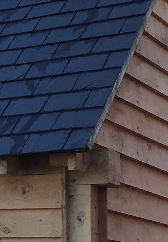

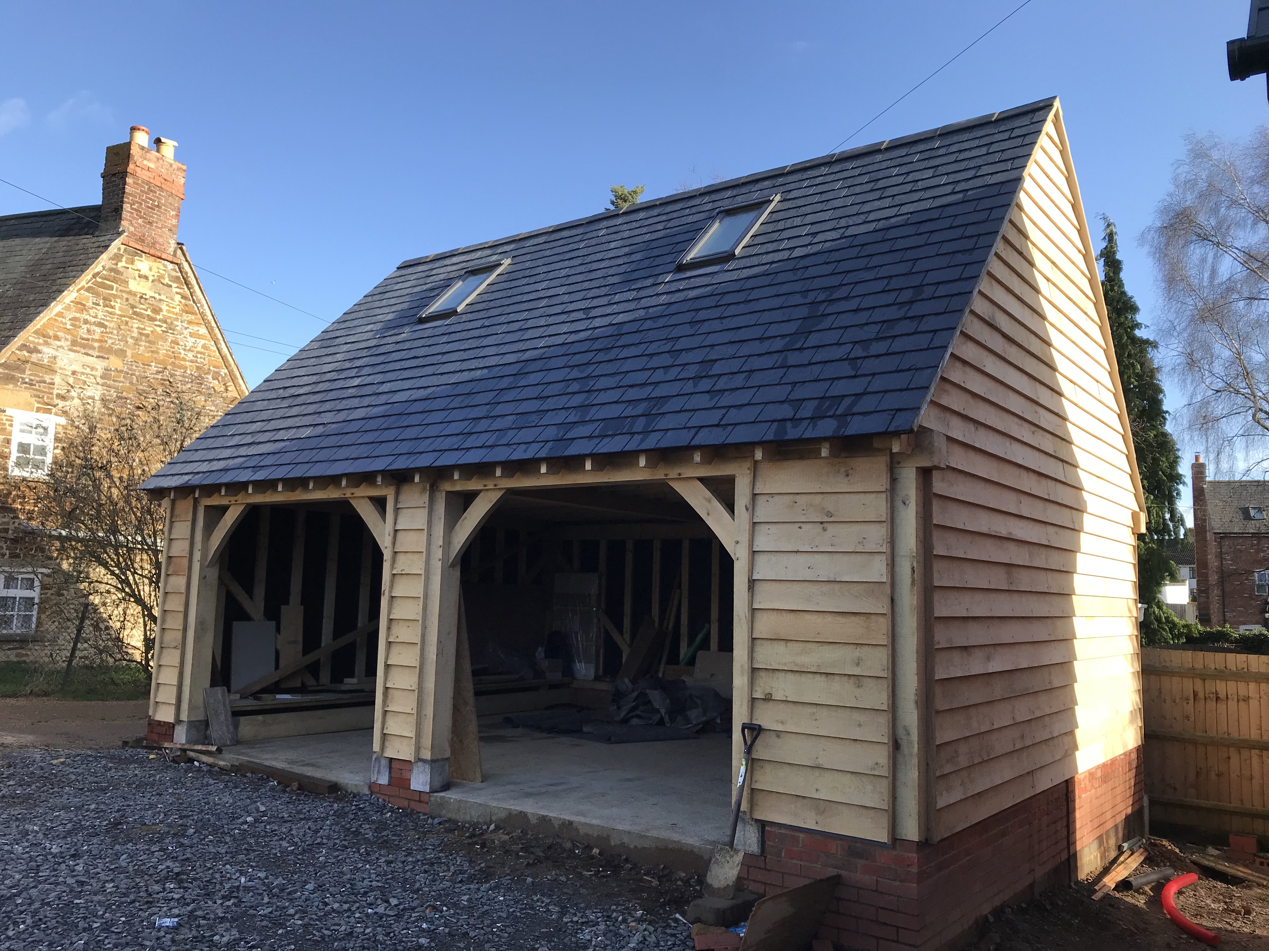

RandAbuild Posted January 26, 2018 Share Posted January 26, 2018 Ian - I don't know if this helps and I'm no expert, but our garage roof was finished yesterday. Charming though your old piggery is, you don't want to go over the top so the planning authority end up listing it! What are you intending to use it for? If it's for storage, then I'd go for the simplest solution. For example, use cement filleted verges (see cropped pic) and a wet ridge - they'll both see you out. You need to trim off those pointy rafter ends so you can get some guttering on there. I might be tempted to leave the OSB if it's reasonable quality, Sorry can't advise on gauging but there's loads of advice online. I expect you'll need a fairly small slate - ours were 500x250. Link to comment Share on other sites More sharing options...
Nickfromwales Posted January 26, 2018 Share Posted January 26, 2018 57 minutes ago, RandAbuild said: Ian - I don't know if this helps and I'm no expert, but our garage roof was finished yesterday. Charming though your old piggery is, you don't want to go over the top so the planning authority end up listing it! What are you intending to use it for? If it's for storage, then I'd go for the simplest solution. For example, use cement filleted verges (see cropped pic) and a wet ridge - they'll both see you out. You need to trim off those pointy rafter ends so you can get some guttering on there. I might be tempted to leave the OSB if it's reasonable quality, Sorry can't advise on gauging but there's loads of advice online. I expect you'll need a fairly small slate - ours were 500x250. Deliciously simple, and way better looking than a dry verge imo. 1 Link to comment Share on other sites More sharing options...
Tin Soldier Posted January 26, 2018 Share Posted January 26, 2018 Well I'll be following this with great interest, I'm battling with the dry v wet verge question at the moment, and sourcing my materials ready for when the panel company leave the site in March I've watched heaps of videos, (I really like fixmyroof) and I am gaining confidence in doing it! Are you planning on roofing the house yourself too? Link to comment Share on other sites More sharing options...
Temp Posted January 26, 2018 Share Posted January 26, 2018 My outbuilding is tiled but I used the same verge system. I worked out how much the tiles would overhang the verge and fitted a row slates overhanging the verge to support the mortar later. Then fitted the tile battens, and the tiles then mortared the verge and ridge. I figured out it would be a lot of work lifting all the tiles onto the roof myself so hired someone to help out - passing tiles hand to hand rather than having to climb up and down the battens to get more made the job much easier. Link to comment Share on other sites More sharing options...

ToughButterCup Posted January 28, 2018 Author Share Posted January 28, 2018 Folks... should I leave the green felt in place (see OP above) under the counter battens when I fit them? Or should I take it off first, then fit the counter battens? I intend to fit Cromar Vent3 PRO over the counter battens. Link to comment Share on other sites More sharing options...
PeterW Posted January 28, 2018 Share Posted January 28, 2018 Felt needs to go .... Link to comment Share on other sites More sharing options...
ToughButterCup Posted January 30, 2018 Author Share Posted January 30, 2018 On 28/01/2018 at 17:39, PeterW said: Felt needs to go .... Get thee behind me Satan......... Give me fifteen good reasons why. Link to comment Share on other sites More sharing options...
Cpd Posted January 30, 2018 Share Posted January 30, 2018 1. Non breathable....... thats all i have..... Link to comment Share on other sites More sharing options...
PeterW Posted January 30, 2018 Share Posted January 30, 2018 1 hour ago, recoveringacademic said: Get thee behind me Satan......... Give me fifteen good reasons why. 1. non breathable 2. Flammable 3. Will sweat 4. Short lifespan 5. Degrades with heat not light 6. Edges will degrade leading to water ingress 7. No guarantee unlike membrane 8. If you need another 8, ask someone else .... 1 Link to comment Share on other sites More sharing options...
ToughButterCup Posted January 30, 2018 Author Share Posted January 30, 2018 Well, if you put it like that...... I was thinking of just leaving the green felt there and putting counter battens on top of it, and then proper membrane on top, followed by battens and tiles in the normal way. Why? Lazy. (Normal? Ha! Exceptional i.e. once only - ever - for me) Link to comment Share on other sites More sharing options...
Construction Channel Posted February 3, 2018 Share Posted February 3, 2018 8. That’s shed felt not piggery felt 9. The roughness will trap water behind your counterbattens and rot them 10. The lap will cause a lump in your roof. 11. It will make your slates a complete waste of money 12. The sweating in point 3 will cause condensation inside and damage all your valuable tools along with rotting the ply 13. Everyone that sees along with everyone here will know you’ve done it and think less of you 14. Because peter told you not to 15. Because I’m telling you not to 3 Link to comment Share on other sites More sharing options...
