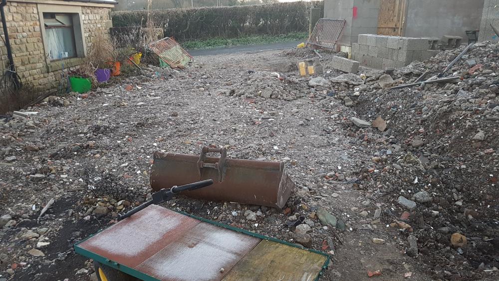

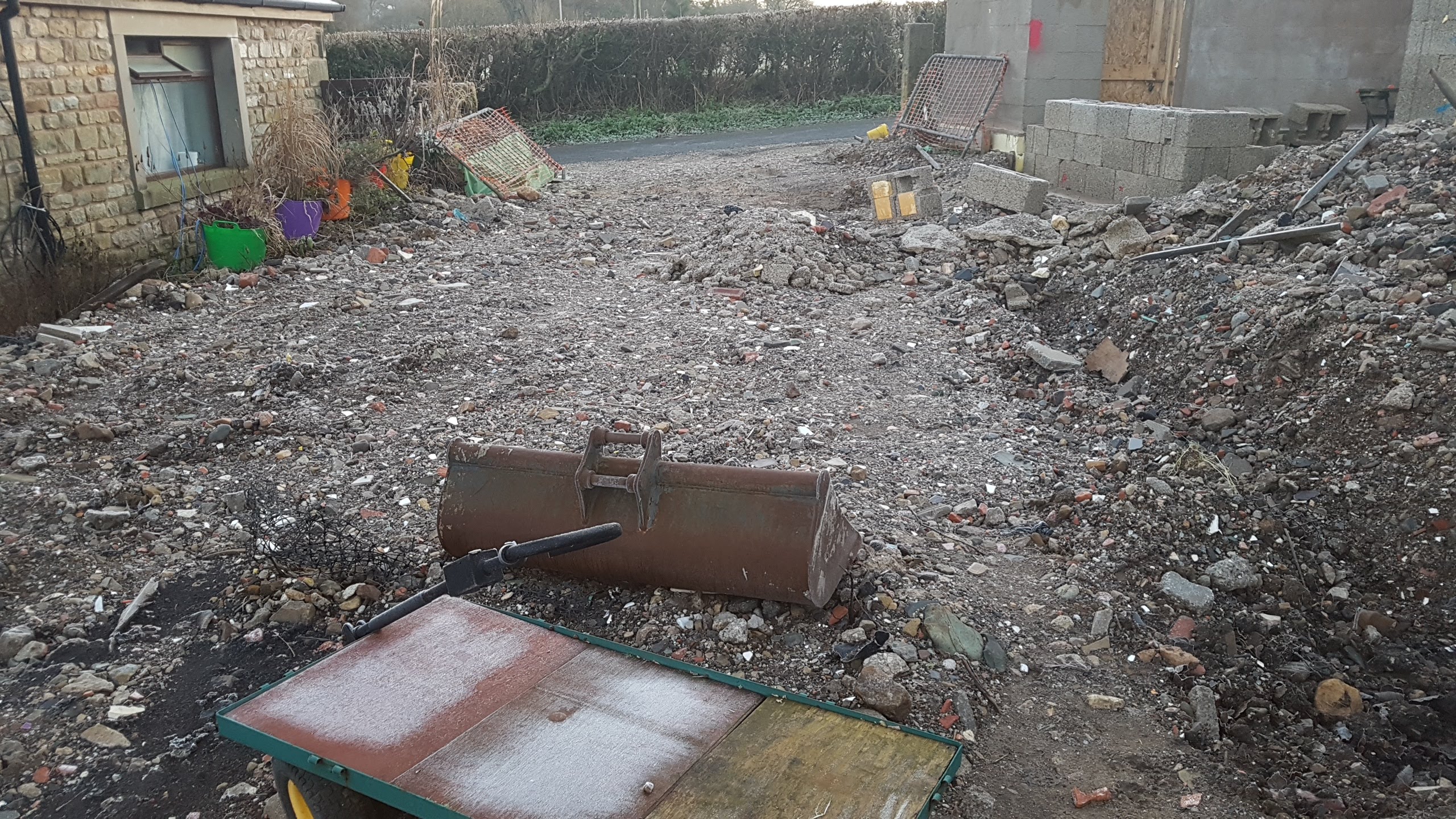

This will be a small car park.
So far I have put some drainage piping under it, covered it with what was left over from our MOT 1 pile and levelled it with our digger.
I'd like to prettify it as cheaply as is sensible.
My thoughts are to roll it as flat as I can get it, put some of that black membrane down to suppress weeds, and then tip some 40 to dust on top of that. Roll that to with a mm of it's life and then wait for the rain to 'tighten things up'
And then put some pretty gravel on it. I know gravel isn't ideal : it moves..... But it's always the same old story: how do I do just enough to make it look a million dollars with only a hundred in my bank account?

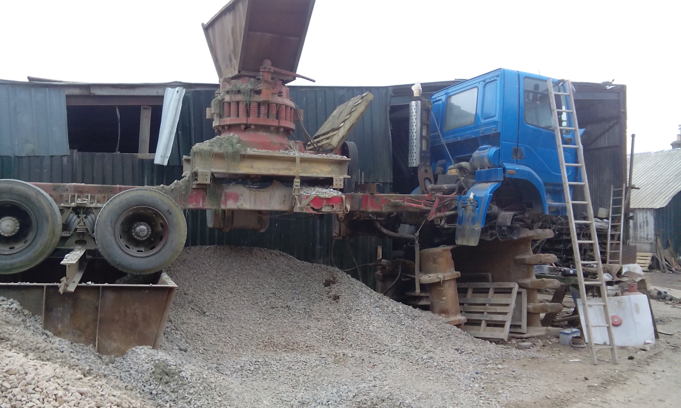

On gravel, the normal stuff rather than decorative can look fine. There is a thread about pricing somewhere, but I was paying approx £33 per bag for 8 or so, delivered. Some came from Wickes, but the Civil Eng. side of Buildbase had good prices. Or cheaper by the lorry from the Lancs version of Joe the Quarryman down the road.
F
Edited by Ferdinand
We have just the man....remember this?
Well, he's got what I need at a price I can afford.

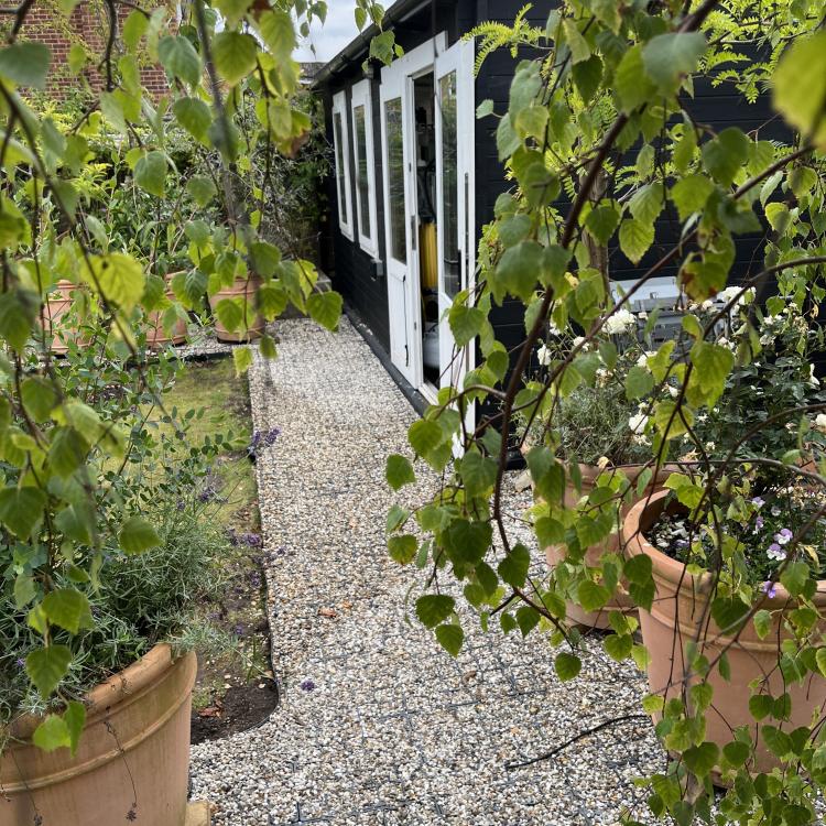

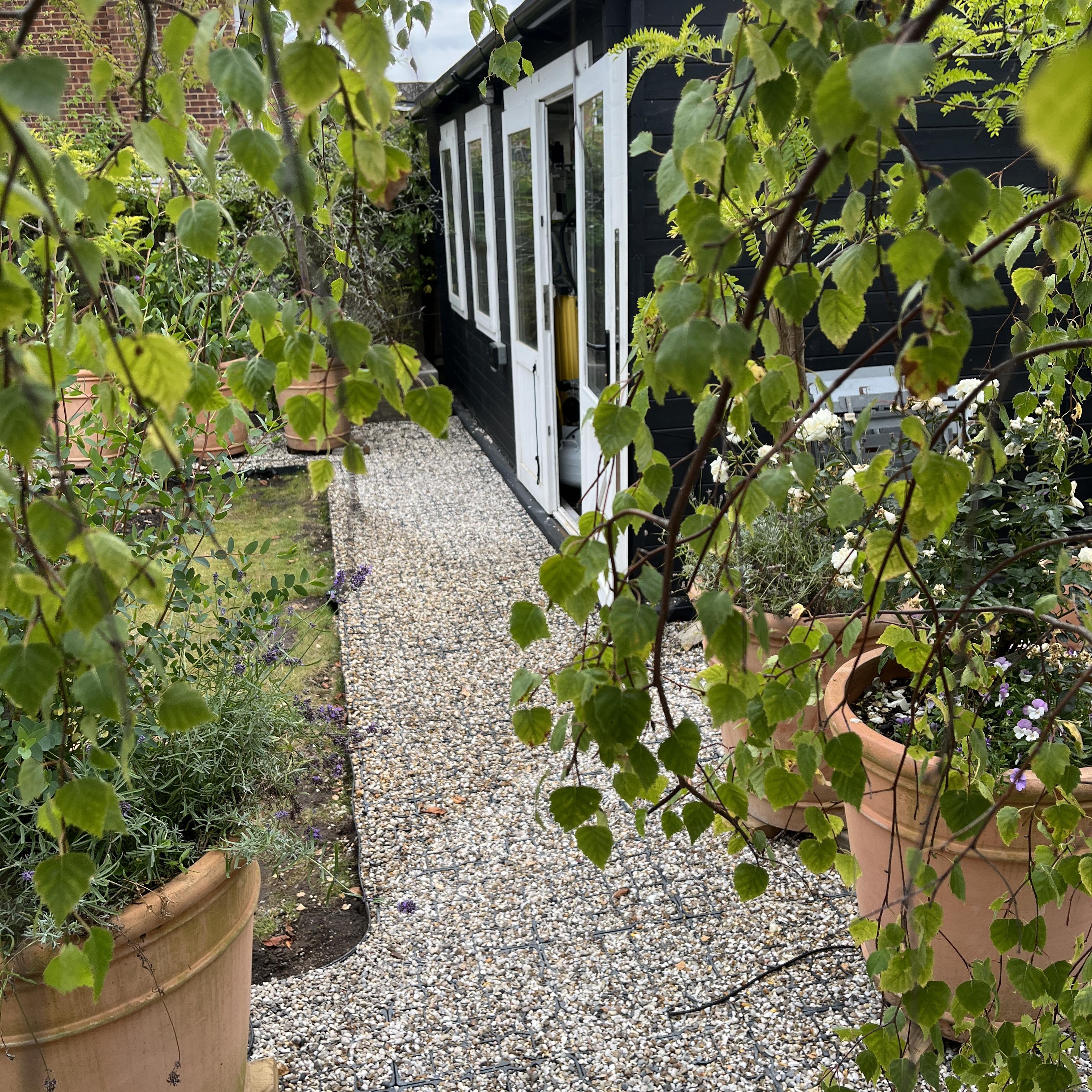

I just finished 70 m^2 of ecogrid 30 for pedestrian use. Fairly pleased although it's not cheap. The company that sells it was dodgy over delivery though. Paid for 'next day' and it turned up on day 3/4 (I forget). Asked them to sort less than 7.5T truck as we live on a narrow lane. Arrived in a van after the truck decided he couldn't be bothered (we get 7.5s regularly). Had to unload an entire van full by hand rather than with a hiab. A kind of couldn't-be-ar5ed attitude.
It looks like you've used gravel to fill the grid. What sort of gravel did you use?
It looks really nice and I'm quite impressed
