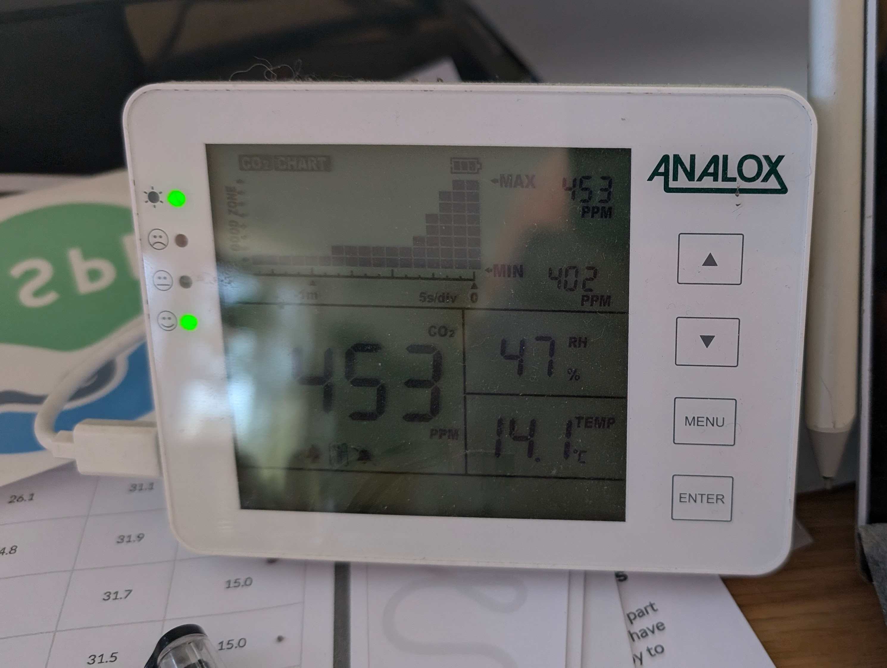

Are you able to measure CO2 levels in your house? ...
Yes.
I measure the  CO2 levels constantly. I move the monitor around and peek at it now and then.
This is in the office right now. I hardly ever look at the numbers: I look at the light. Yes, on occasion its red.

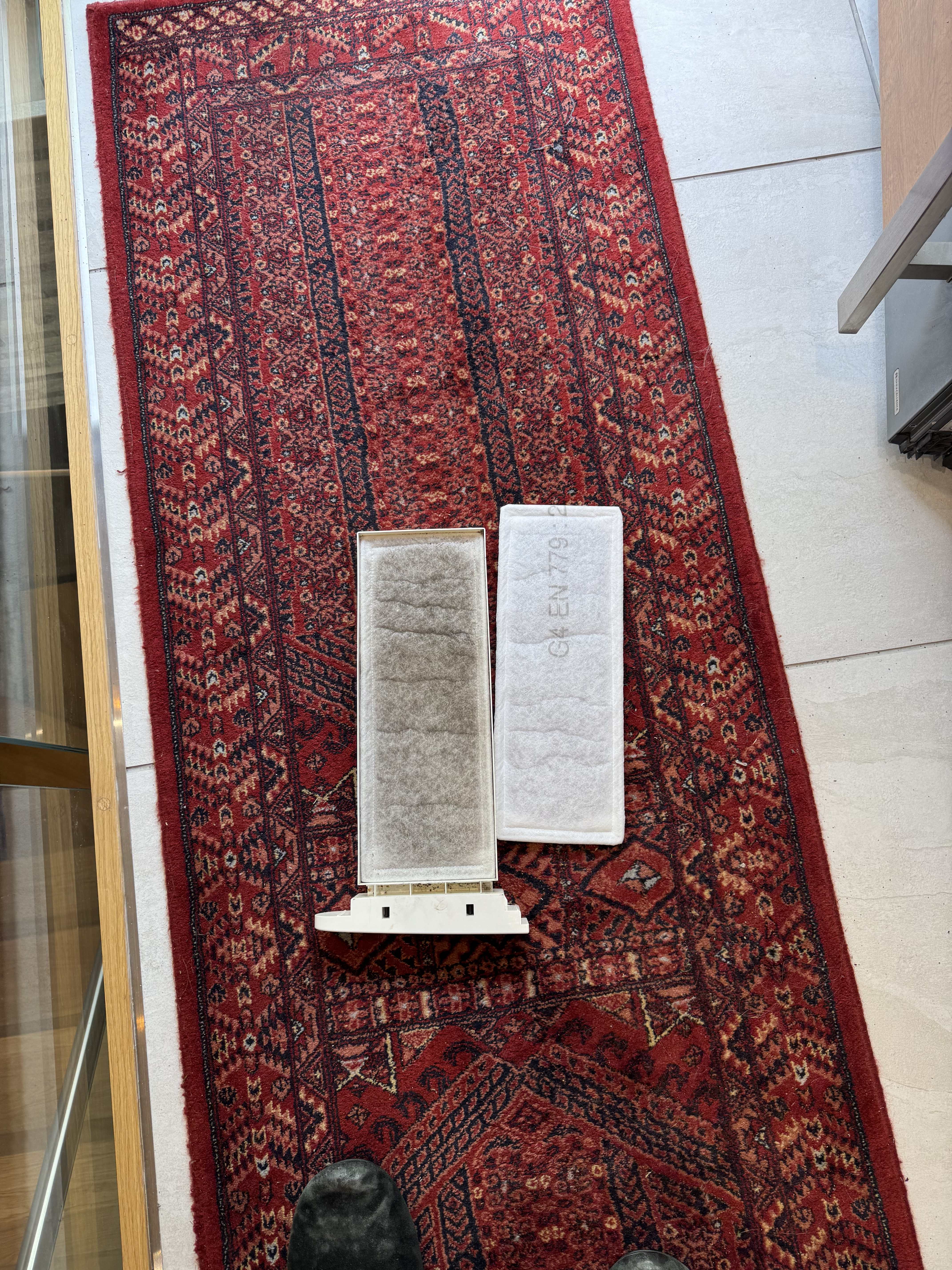

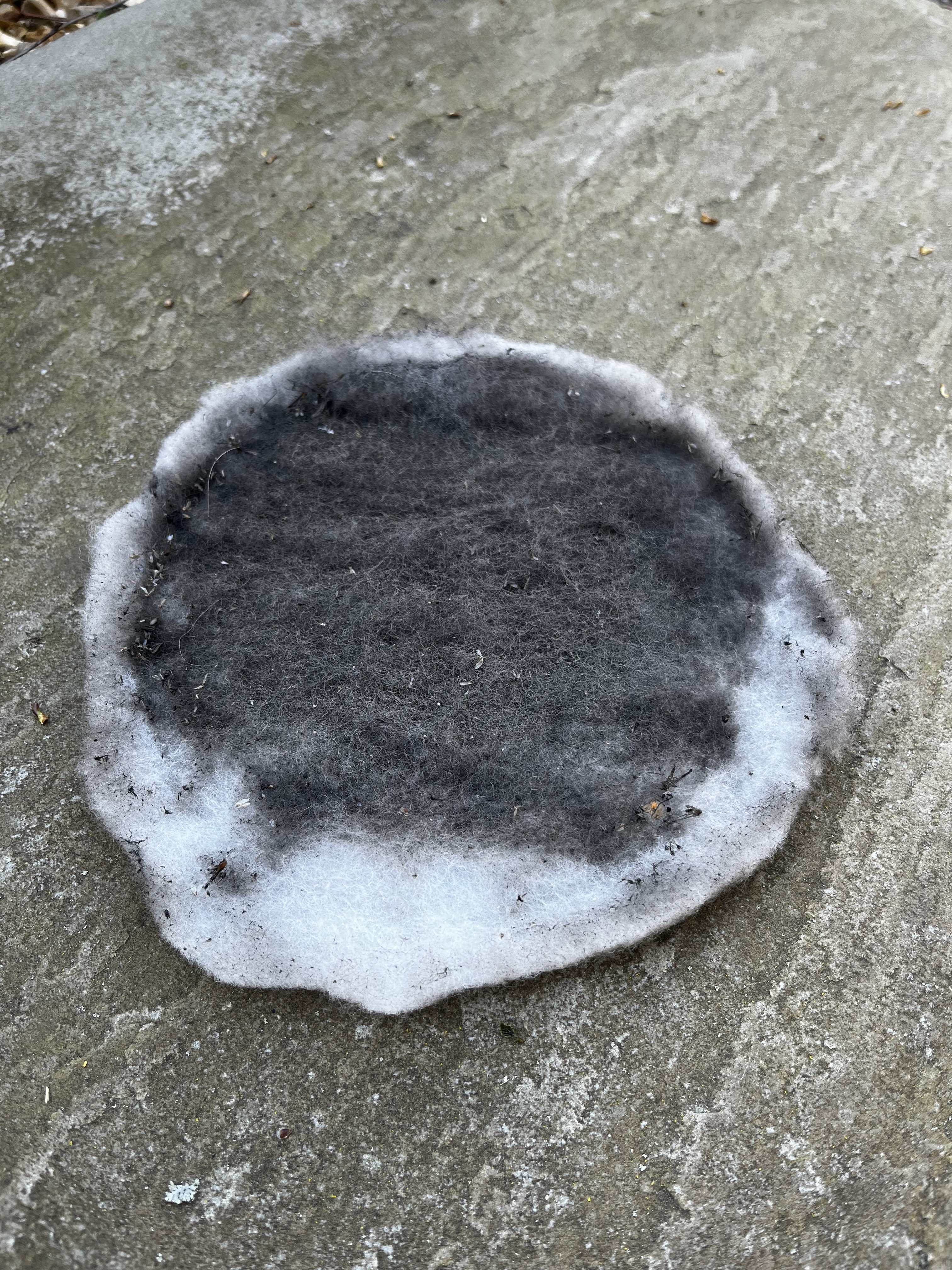

Another vote for MVHR here, this is my inlet pre-filter after a month! We are in a rural village so probably a combination of wood burner smoke and agricultural dust. Anyway I prefer not to let fresh air in the house.
  • Like 3
